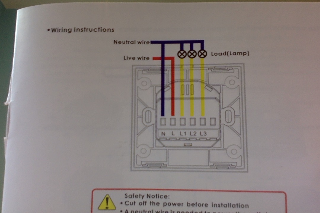

Need some assistance please.

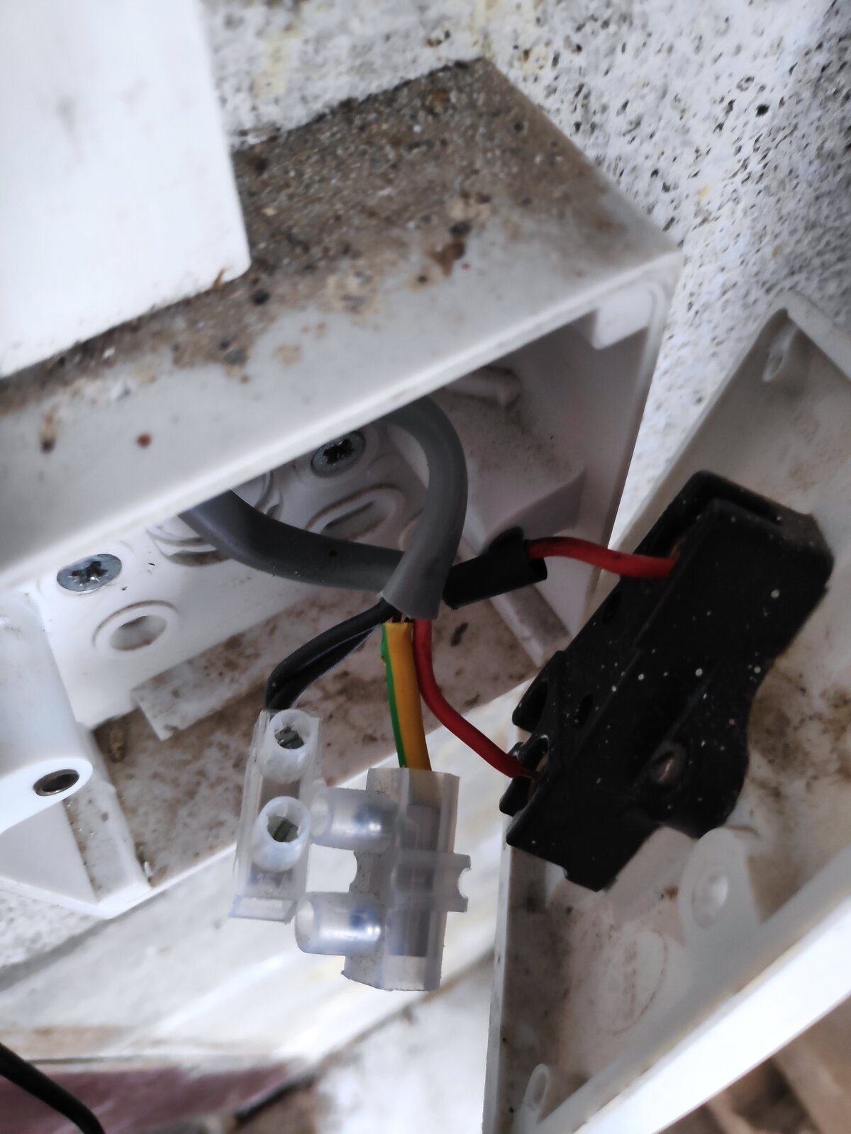

I want to set up a smart lighting switch in our garage for my wife.
She is currently down South seeing her mum for the first time in 18 months. She normally helps me when I am doing wiring and tells me what colour each wire is.
I have attached a couple of pictures. One shows the current garage lighting switch with two wires being used....top one is common and bottom is L1. I have no idea what colours the wires are. There are other cables in the lighting box. One seems to be earth..with a green and yellow sleeve attached to it. The other wires, are connected together and I think are black in colour.
The second picture shows what is needed for the smart switch. It needs a neutral conection to work.
Is there hence a neutral wire I could use to power the new smart switch when it if off so that the wife etc works?
Its possible the two non sleeved black wires that go into the connector block might be neutrals. Best to check with a multimeter?
If the black are neutral then disconnecting them should stop the light working.If the wiring was done by inexperienced diyer they may think they needed to use only red for live so ran two cables when only one is required for a switch.
