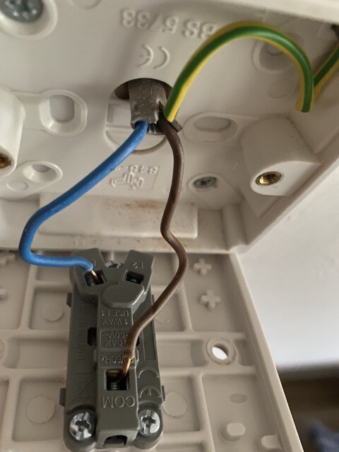

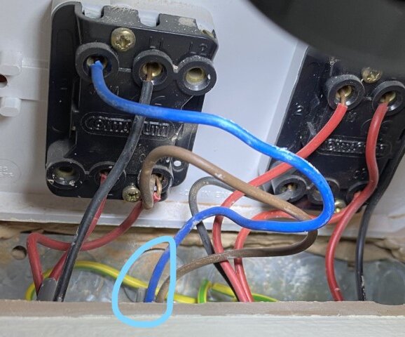

Hello all.
I am wishing to install a 'smart' wifi light switch - see here http://tiny.cc/1c8muz - which requires a neutral wire.
My existing circuit has several wires and I'm a little confused by it.
I wish to install it on a spur that has been added using new wiring colour regs from an original supply using the old regs.
The below picture shows the original switch with old wiring coming in and new wiring exiting to the to be upgraded switch through the wall where circled (switch is situated on other side of wall).
The next pic shows where the wires exit into the switch I wish to make smart:
Looking at the original wiring am I to assume there is no suitable neutral wire that I could feed into the desired socket and I need to look at alternative options?

You may find there is both a live and a neutral, at the light/ceiling rose, that would enable the Smart Switch to be mounted there instead.
