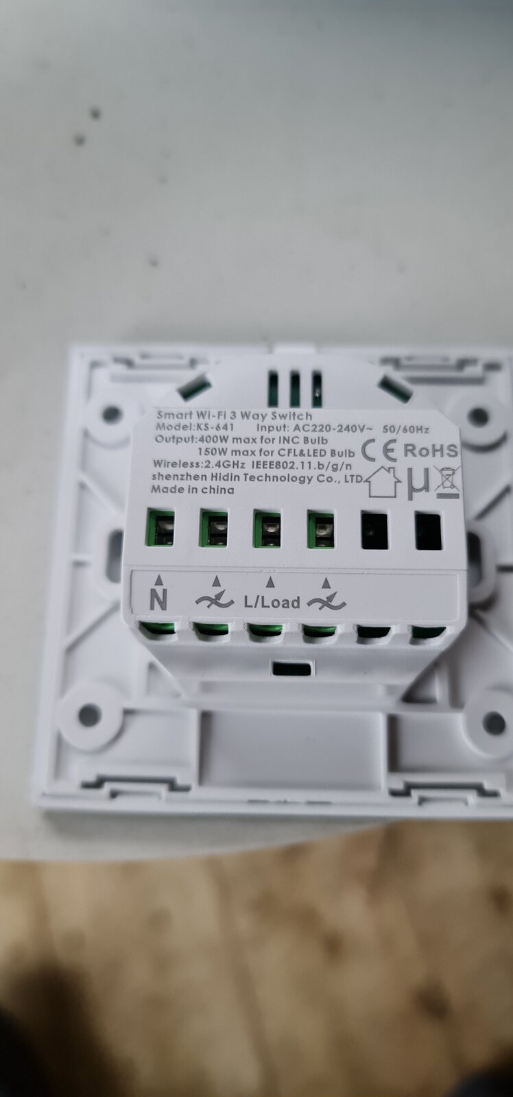

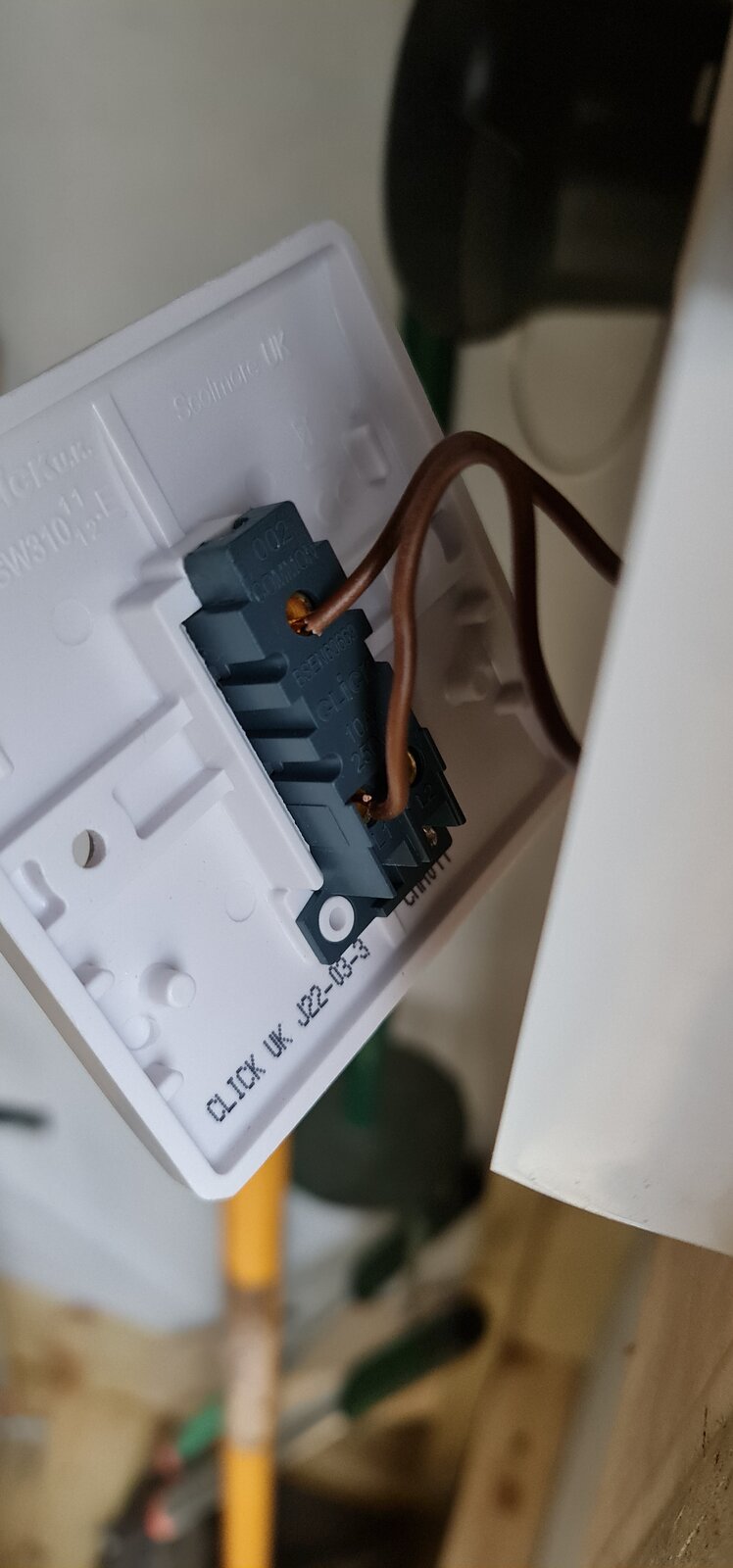

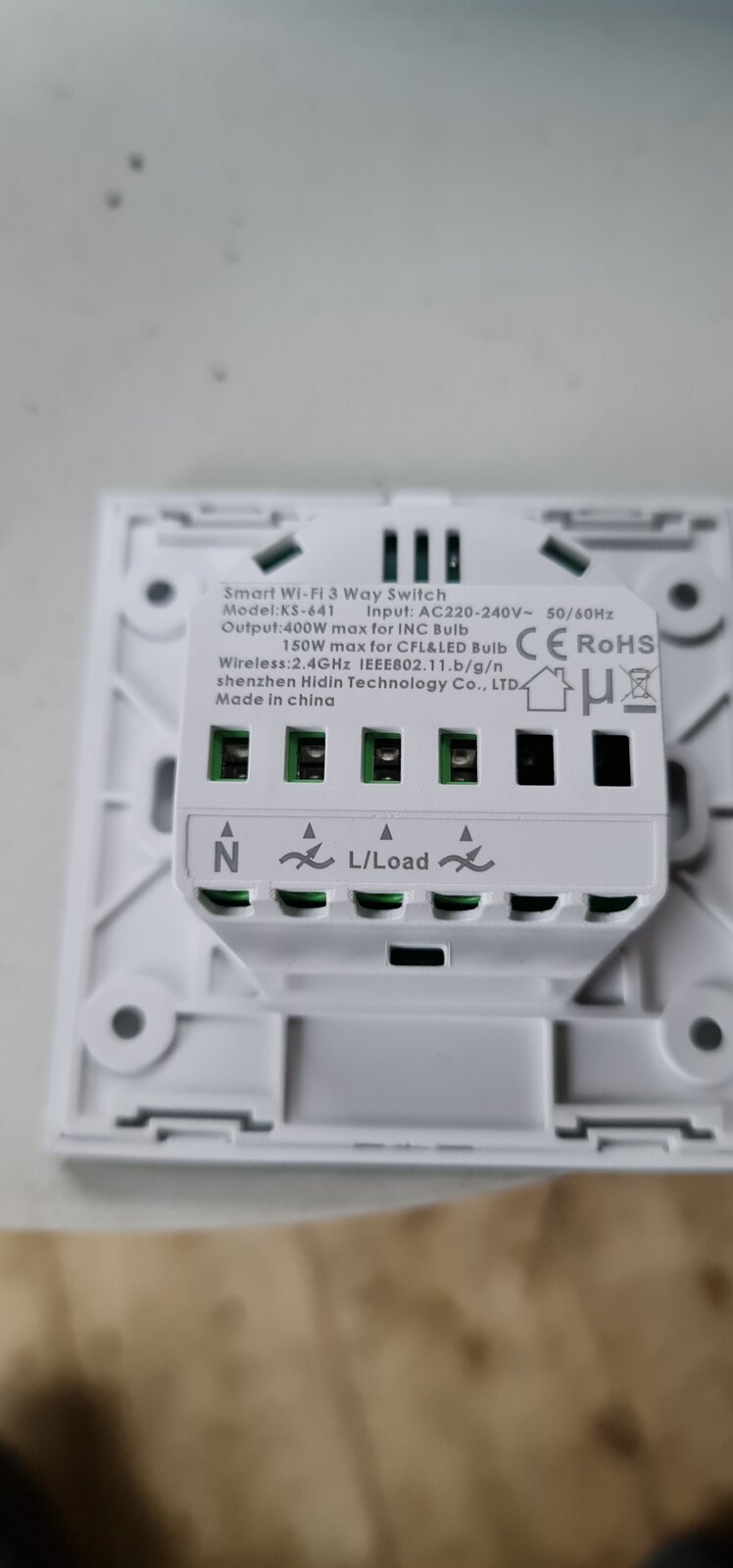

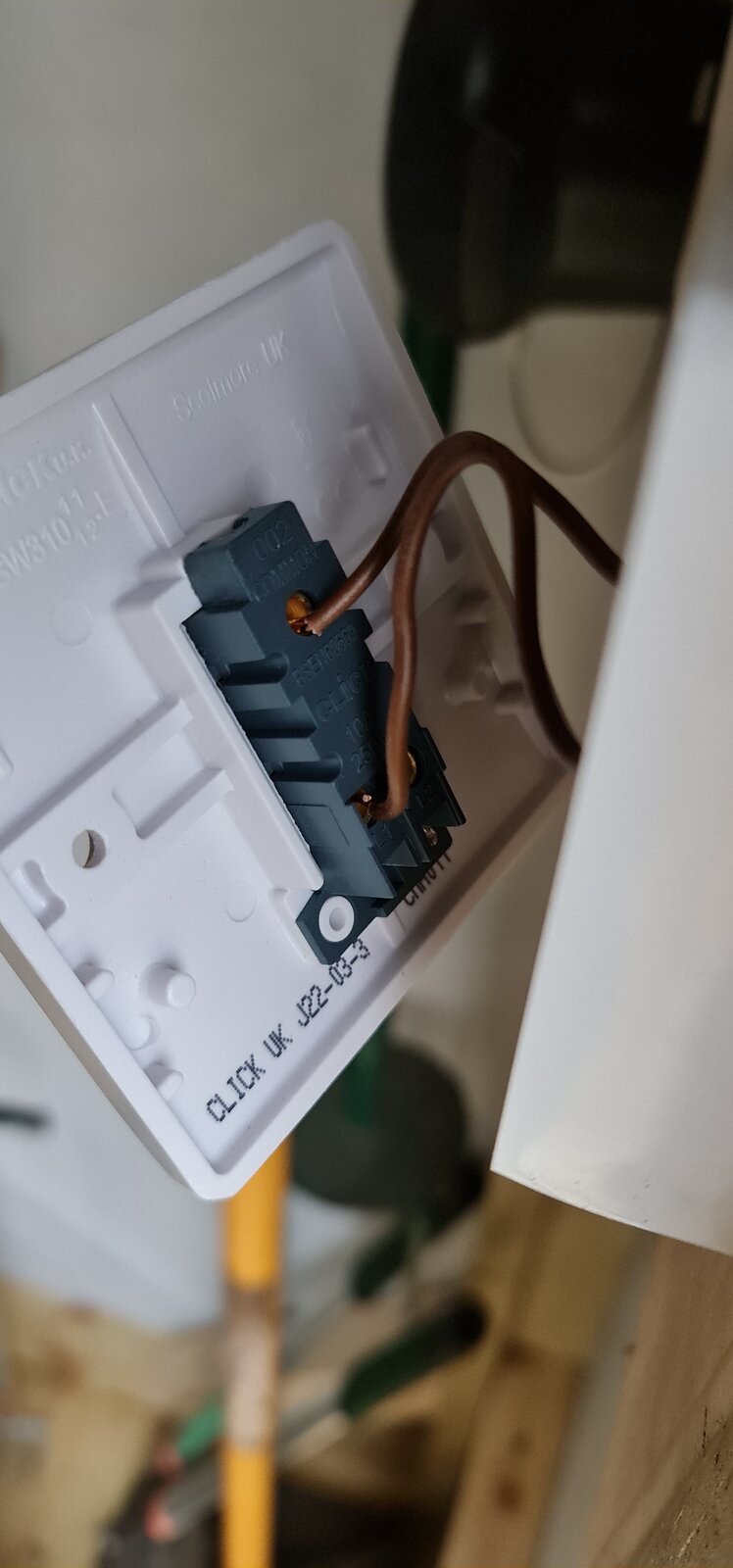

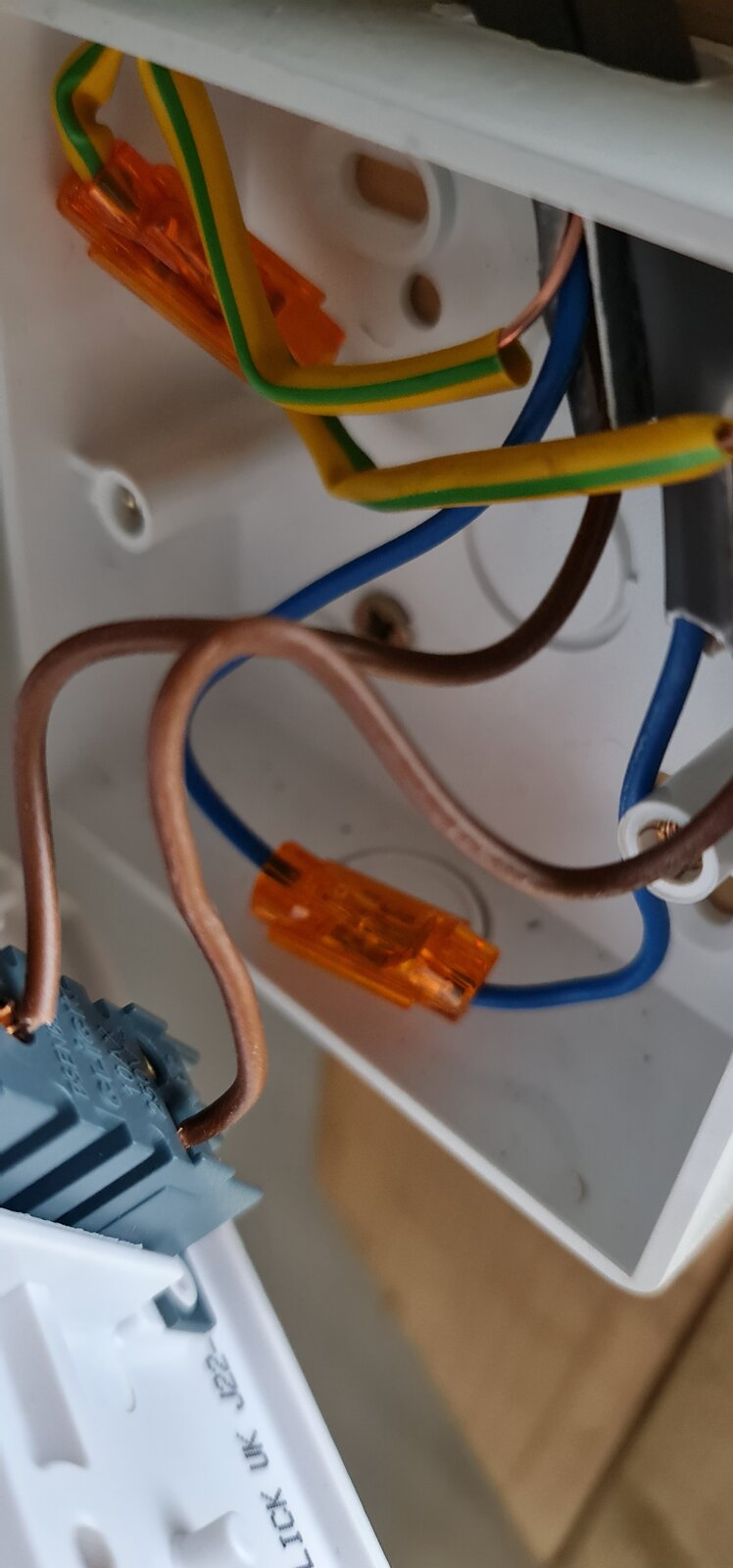

Hi all,
I have a couple of spare 3 way smart switches. I have a single light switch in my shed and thought I might as well make it 'smart'! So I wondered if I can use my old 3 way smart switch...
I've attached a picture of the wiring for the existing switch, a pic of the back of the smart 3-way switch and a pic of the other wiring in the back of the light switch box. The front of the WiFi switch just has the one button.
There is just one light and just one switch in the shed, all working fine. Is it possible to use the three way switch? The WiFi switch make is Maxico. Had tucked away in the garage for a few years!
There are neutral wires in the switch box but not currently connected to the existing switch.
Any help would be appreciated. Thanks

I have a couple of spare 3 way smart switches. I have a single light switch in my shed and thought I might as well make it 'smart'! So I wondered if I can use my old 3 way smart switch... .... There is just one light and just one switch in the shed, all working fine. Is it possible to use the three way switch? The WiFi switch make is Maxico. Had tucked away in the garage for a few years! .... There are neutral wires in the switch box but not currently connected to the existing switch.
Provided that the 'neutral wires' at the current switch are, indeed, neutrals, I see no reason why you cannot do as you wish.
Kind Regards, John
That's good to know. Thank you. Could you advise where the wires should go?
was thinking both blue neutral wires go into the N connection on the WiFi switch.
The brown wire currently going into Common on the existing switch, goes into either of the wavey line connections on the WiFi switch.
And the other brown wire currently going to L1 on the current switch, goes into the L/Load connector of the WiFi switch.
Does that sound right? Thanks again
It does sound about right to me :)

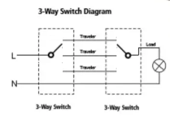

The circuit diagram shows that the switch should work with those connections.
But if it doesn't, just swap the 'L/Load' and 'wavey line' connections.
...and as above, hopefully the blue wires are neutrals!

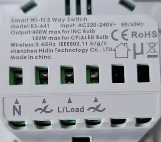

I can't work out why one would call a switch shown here 1678801588657.pngthree way? This 1678802044696.pngwould be a three way pair of switched easy enough to count the three paths. However in real terms the switch needs power, the neutral is clearly marked but as to which line wires it can draw power from is not 1678802398098.png the one marked L/Load is clearly an output, but the diagram that @RandomGrinch shows has it as feed on one switch and load on the other, not sure if with an electronic switch if you can reverse them?

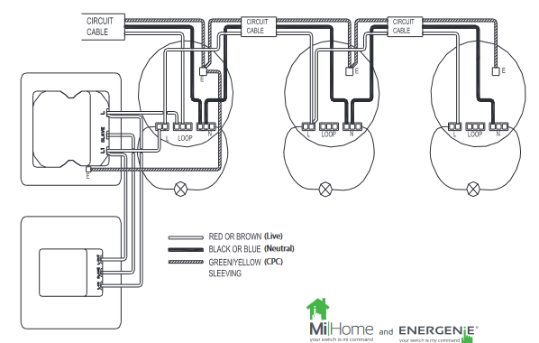

The two way smart switching I installed used a relay DSC_6061r.jpg the connections at the bottom go to the original two way switches, but looks for a change in state, so does not matter if physical or wifi is used you can switch on/off from any.

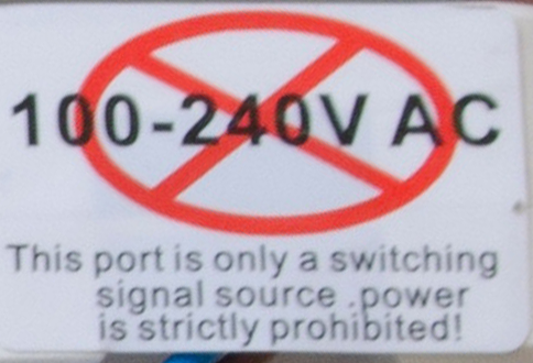

The switches have a sensing wire, light_switch.jpgthe slave is connected to master with a sensing wire, and the instructions which come with the switch shows how to connect. 1678803275245.png
This is the problem, there is no longer a single wiring diagram which fits all, and in some cases like the relay shown, we have extra low voltage and low voltage and they must not be mixed. 1678803524448.png So it is pointless using a diagram from another switch, we need to use the diagram which came with your switch and no other. I did find an advert for KS-641 smart switch with the diagram @RandomGrinch showed, however it states 100 - 240 volt, and your picture shows 220 - 240 volt, so clearly not the same switch even if it has same number on it.
And the incorrect labels like live instead of line, means you can't trust it has been translated correctly, so in really terms it is a suck it and see, unless you have some better instructions.

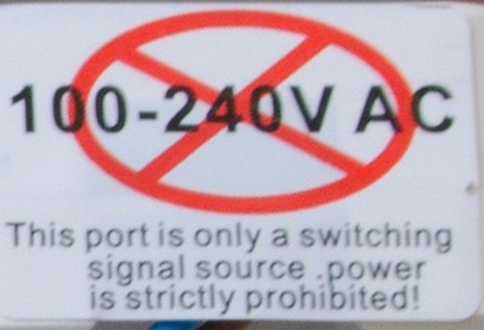

Not put a meter on the control wires, but sure well under 100 volt, and not even sure if AC. The sign says don't connect to between 100 and 240 volt AC.
The problem is we have no idea what the instructions which came with the switch says, and it seems odd to use two electronic switches, more likely one switch is a simple two way switch and one electronic.
What is missing is which termial/s need a line supply? it could take a supply from all three, or just the com which seems unlikely as marked load, or either of the two change over contacts.
It seems unlikely trial and error would cause any harm, but it really should say on the instructions, not require a suck it and see method.
