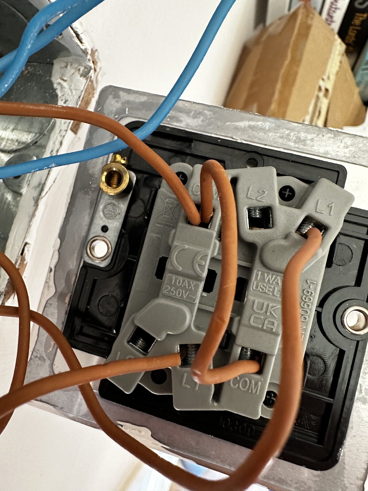

I've got the following setup for an existing one way, 2 gang lightswitch:

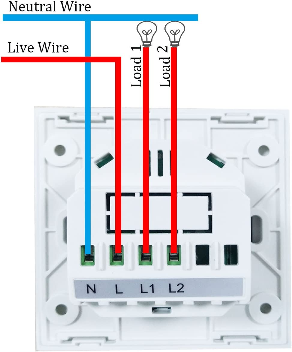

I wired the new switch in, 3 neutrals were all in a wago box so I connected the neutral and live pair in, and the two wires that were connected to the L1 inputs of the old switch into L1 and L2 in the new switch. Diagram below.
The switch powers on, I even successfully connected to the WiFi and updated the firmware but the actual switching did not work. Neither set of lights came on when the switches were switched to on, I've put the old switch back in and everything works.
Have I been unlucky and got a duff switch or have I misunderstood the wiring here?
Thanks for any pointers!
Do you have a neutral wire in the switch back box. Normally, there wouldn't be one.
Ordinarily, you have perminant live running down, and switched live running back up. DO NOT assume that the colour of a cable in a switch indicates whether it is live or neutral.
Thanks @opps and @flameport.
I removed the neutral from the wago that was paired with the live and put it inside the new switch, and left the other two inside the wago (that is, assuming all 3 blue wires are netural, this is a newly wired (last 6 months) area, so safe assumption?)
Should I be placing all 3 neutrals into the new switch?
@terryplumb - sorry, wasn't very clear. 3 cables coming into the switch, one I've identified is live which is the one that was into common and being bridged. I took the blue wire that was part of that cable and placed it into the new switch but left the remaining 2 in the wago, I assumed they were not needed.
Sounds like I was wrong and I should be placing all 3 neutrals into the new switch?
Yes they should ,if they will physically fit into the neutral terminal.

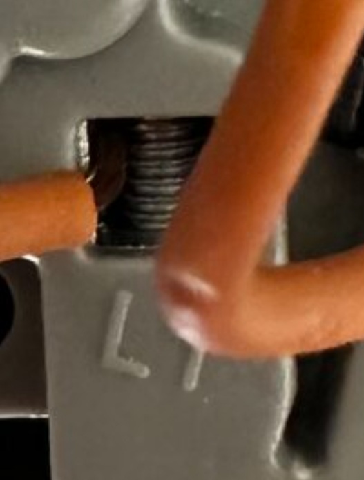

Some of the wires didn't look captive either:
Probably a good thing that the switches are being changed! :)

All the neutrals into the new switch sorted it. Confirmed the issue was me, not the switch, really appreciate the help!
That IS so..
You cannot just 'insert" a single thin wire into the "set screw" locations that you have and expect the screw to "clamp' onto the wire !
It would be better to (have enough stripped wire and) bend the wire unto a compressed "U" shape, so that the set screw can "bare down" onto the "U" of wire and not just have the wire making what may be a "loose" connection at the side of the set screw!
(Where there are two thin wires twisted together, that usually provides enough "area" for the screw to clamp the wire.
Even in that case, it would not "hurt" to bend the two wires twisted together into a compressed "U" shape !)
