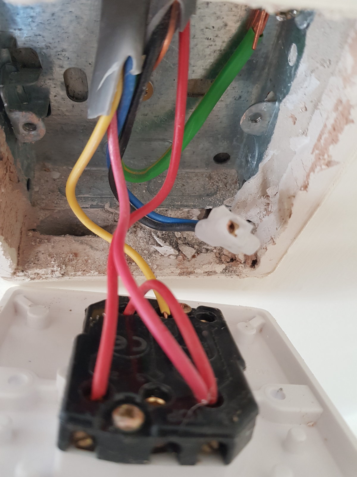

Hi all,
I have a 2 gang 1 way switch in the hallway at the moment. The left switch controls the hall ceiling light (yellow wire) and the right hand side feeds through the front wall to a porch light.
I'd like to convert this switch to a 2 gang smart switch as there is a neutral wire (its very close to the fuse box so makes sense). I'm just not certain what to do with the 2 neutral wires which are currently connected together- would they both feed into the smart switch neutral point? Any help gratefully received :)

Thanks for your help. So the yellow wire corresponds to L1 and both neutrals feed into neutral?
Whether you put the yellow wire into L1 or L2 (in the appropriate switch) will determine 'which way up' the switch works - if you put it in L1 and don't like the way it works, just change it to L2. The same goes for the single red going to the other switch.
