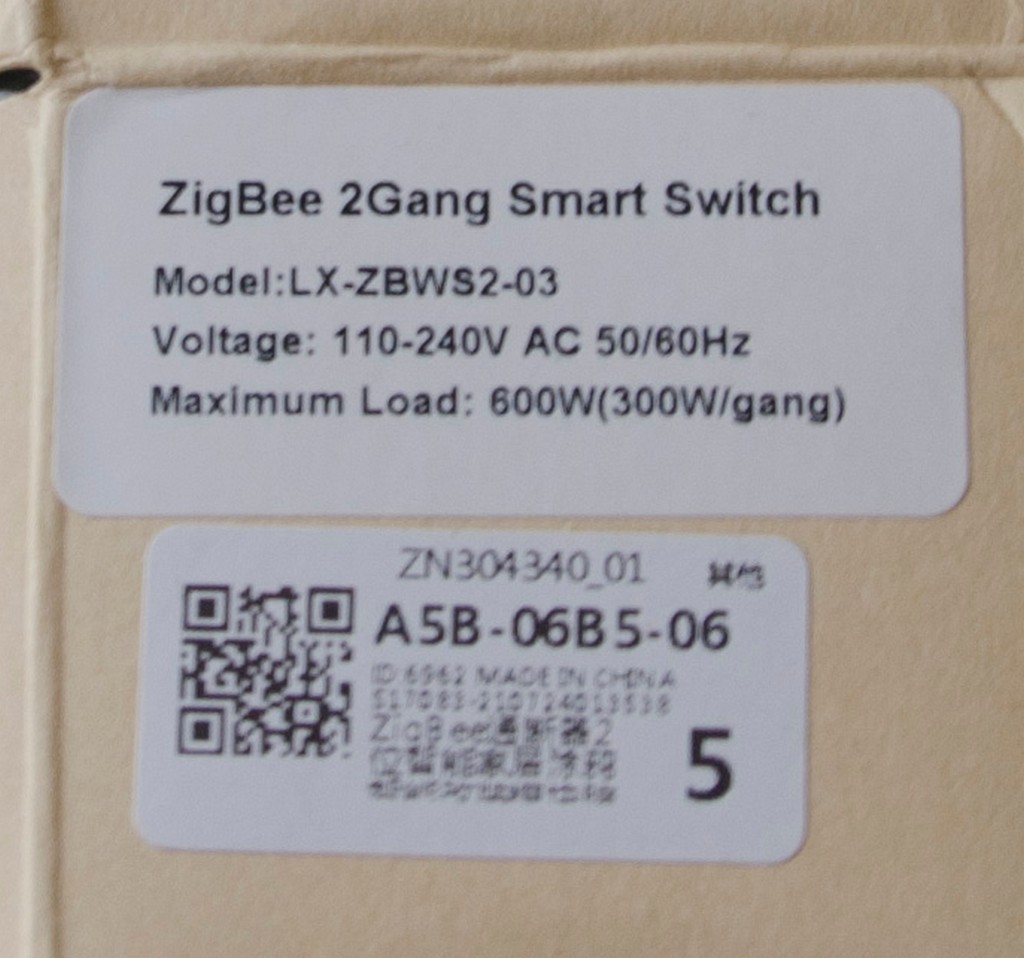

Are you fitting smart switches that can work with out the neutral wire, or are you adding a neutral wire? There aren't many than can work with dimming LEDs and no N wire.

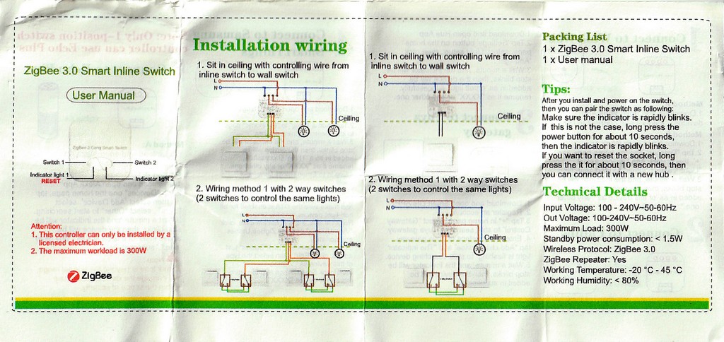

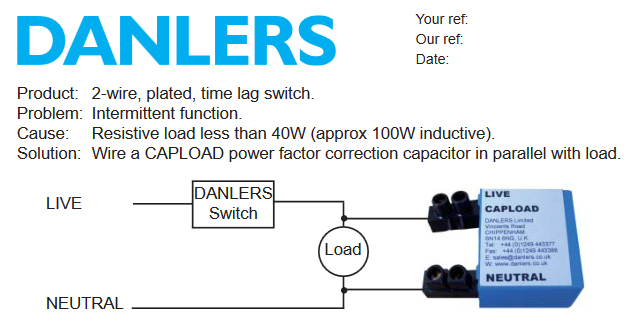

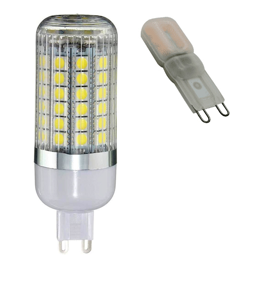

I have smart switches, smart relays, and smart light bulbs, each has there place. The smart switch comes in two versions with and without neutral, the latter some times causes problems with flashing when off and a shimmer when on, the flashing when off is cured by a load capacitor load-capacitor.jpg the shimmer when on by selecting bulbs, the smaller the bulb more likely the problems the G9 G9-comp.jpg shown the large bulb has a smoothing capacitor inside nearly as big as the small bulb, the problem is I have a collection of G9 bulbs tried before I found some which worked.

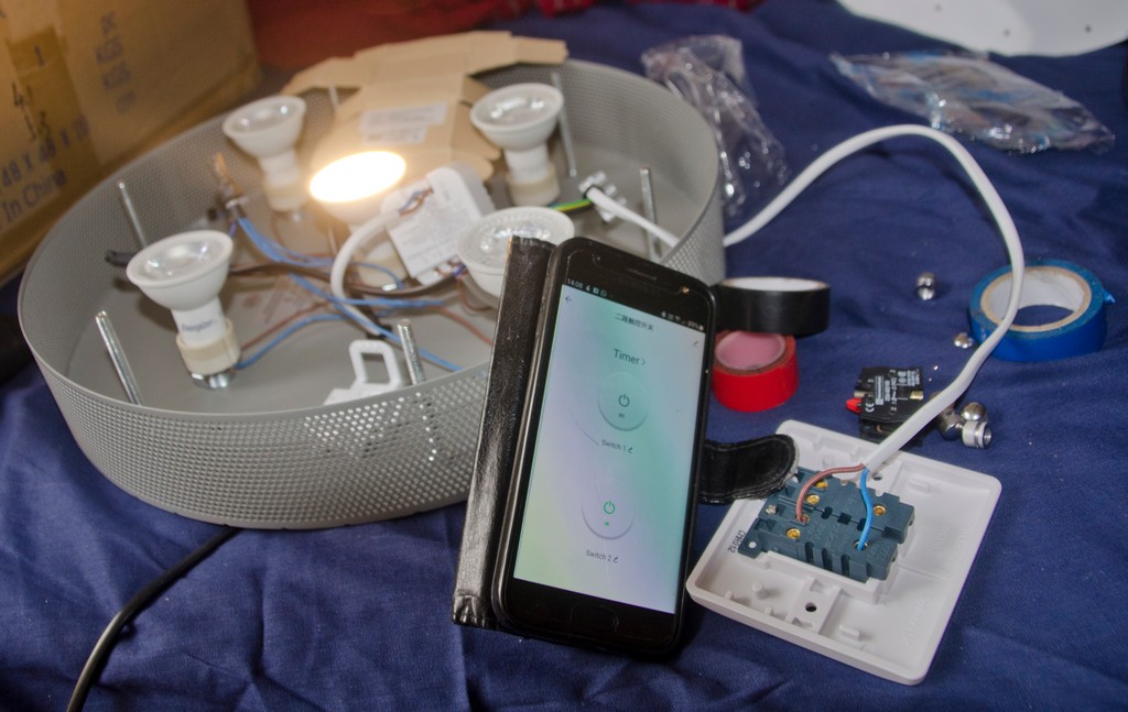

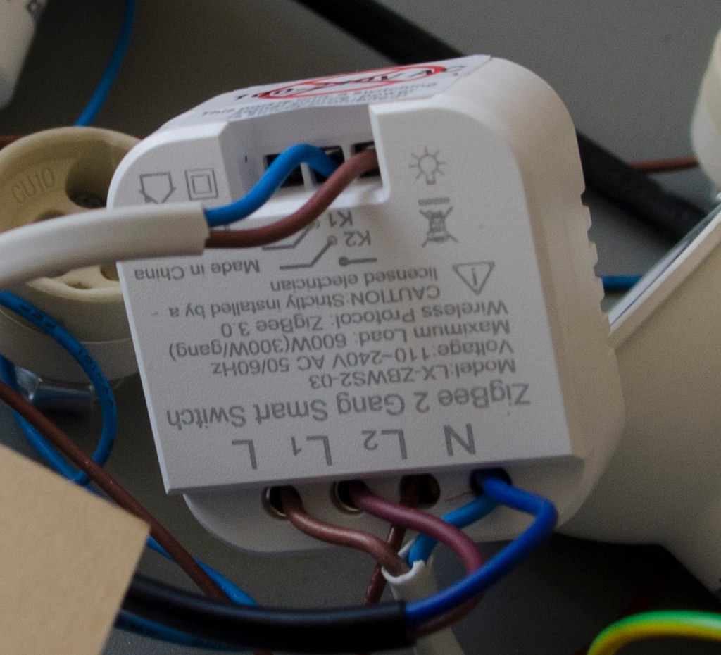

Using a smart relay DSC_6061.jpg is one way to switch where no neutral at the switch so both switch and smart controller can both control light. Also allows one to split the control in my case 1, 4, or 5 bulbs lit.
However the easy method must be the smart bulb, main thing any fault easy to change, no wiring, and no matching bulb to switch, nearly every smart switch has a list of bulbs that are claimed to work, I say claimed as the G9 listed as working OK did not.
Clearly with multi-bulbs in a chandelier smart bulbs are expensive, smart switches are cheaper, and the smart switch and relay allows both control with smart device and the switch, but in the main I now use smart bulbs, not worth the hassle finding out what bulbs will work with the switch and swapping switch when it fails, of the 5 smart switches I bought only 2 still in use.

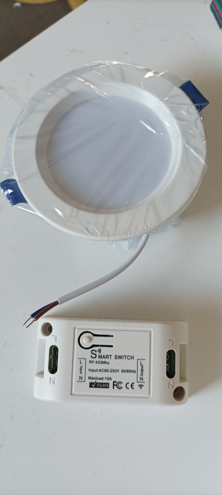

This is what I'm going to use:
3 downlights to one switch over the dining area and 6 over the living area with another switch on.
Just want to check whether to wire it from the existing on and off switch? I'm suspecting when I switch it on, both dining and living rooms ones would come on (unless the switch remembers it need to start with the off state)

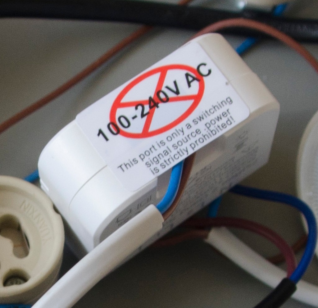

The relay I used DSC_6058.jpg DSC_6060.jpg DSC_6061.jpg DSC_6062.jpg Landing-light-relay-instructions1.jpg Landing-light-relay-instructions2.jpg has an extra low voltage connection for the switch, so still mounted with the lamp, but the light switch still works it does not matter if switch is off or on it looks for change of state so works like a two way switch with the phone app.
I connected it to test, but need special ladder to fit it so waiting for my son to install the light for me. At 70 not good on ladders.
