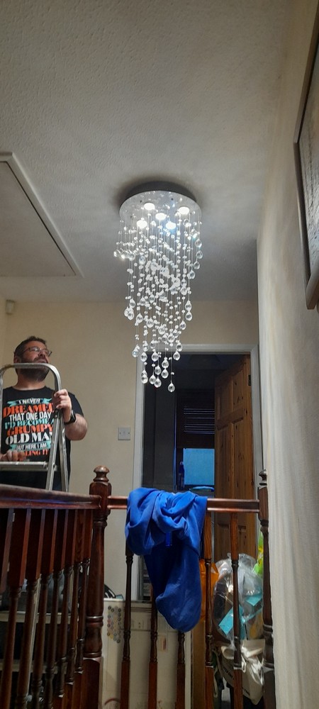

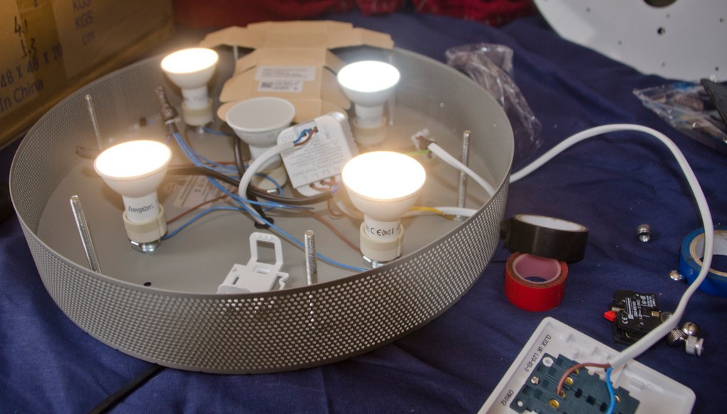

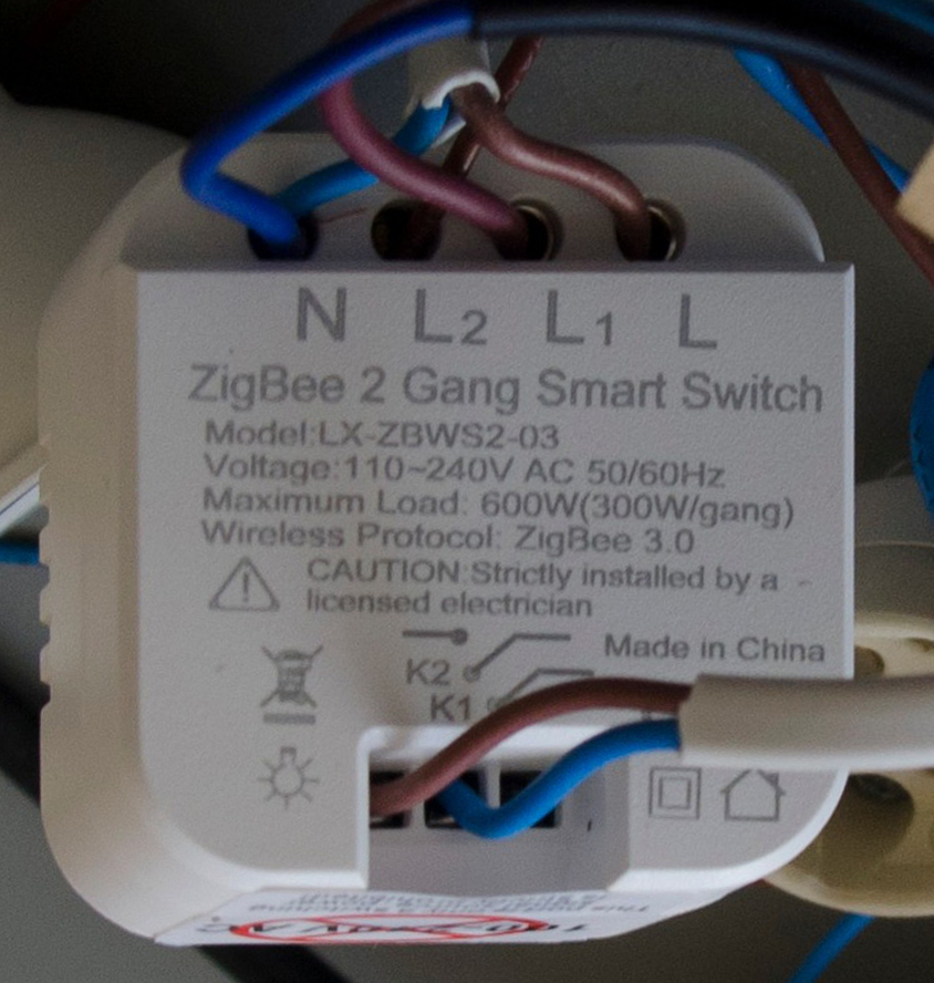

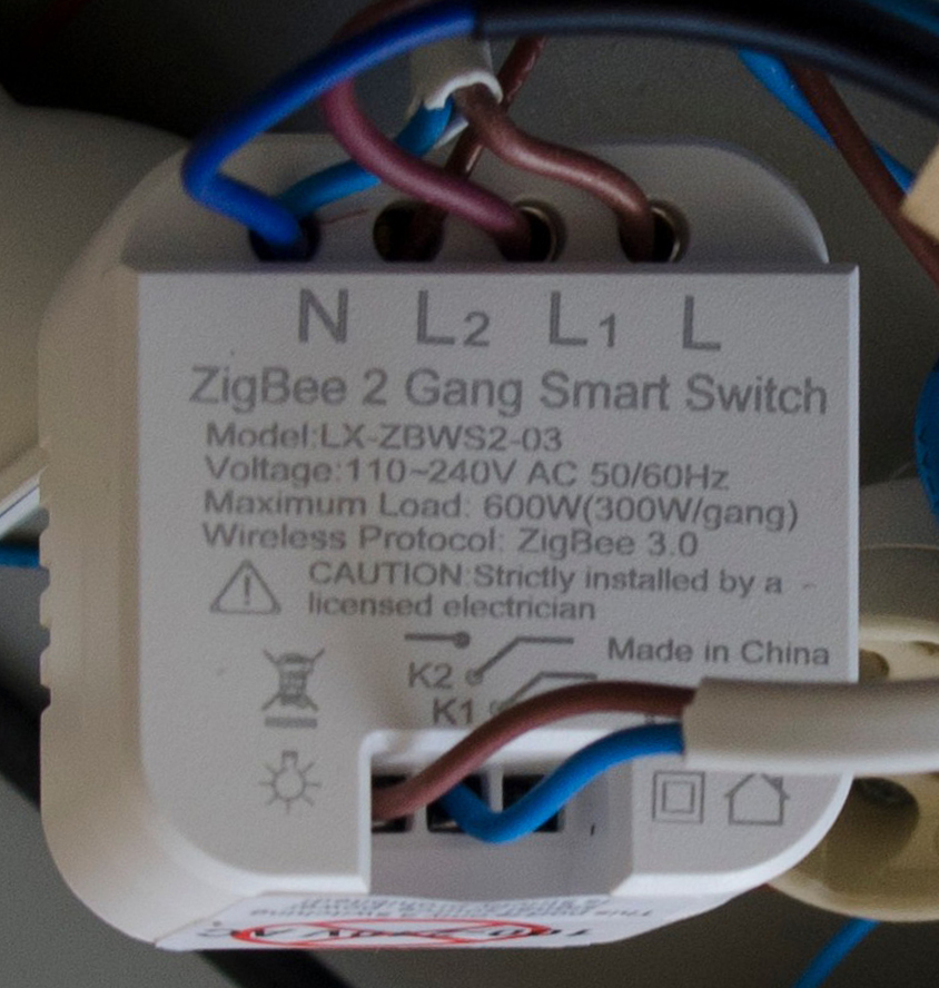

I in hind sight made an error, the light was large enough to take the relay DSC_6057.jpg so I put the relay DSC_6061r.jpg in the lamp, but the lamp is not easy to assess 20220529_211956.jpg so when the relay started to play up, it was too big of a job to access it again, it works A1 with the zigbee, but it should also work with the light switch, and this is intermittent, some days it will, some days it will not, but saying hey google turn on landing lights always works so not that worried.
However learn from my error, put the relay where you can assess it.
The other thing is it is seen as a relay not a light, with bulbs we can program a remote control to work them, but it does not work with the relay. Also general commands like hey google turn off all lights does not turn it off, as not seen as a light.

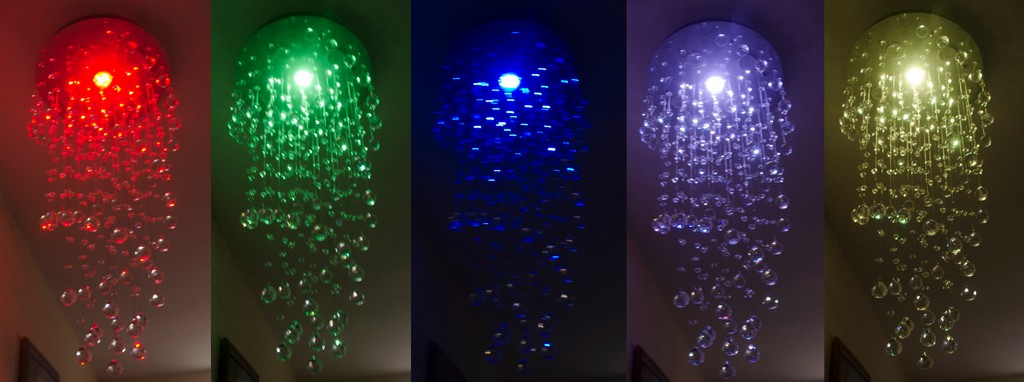

However with smart bulbs there is no need to rewire, and in hind sight would have been better to use 5 smart bulbs instead of relay. Centre one is smart anyway so I can get nice effects Centre_bulb_colours.jpg so not so sure really needed a relay, the advantage should have been with relay the existing light switches switch lights in same way as two way switches, change state of switch, and light changes state, but switches don't always work, and need to remember switches now extra low voltage not at low voltage (mains).
As said though if had to do it again I would simply use smart bulbs.

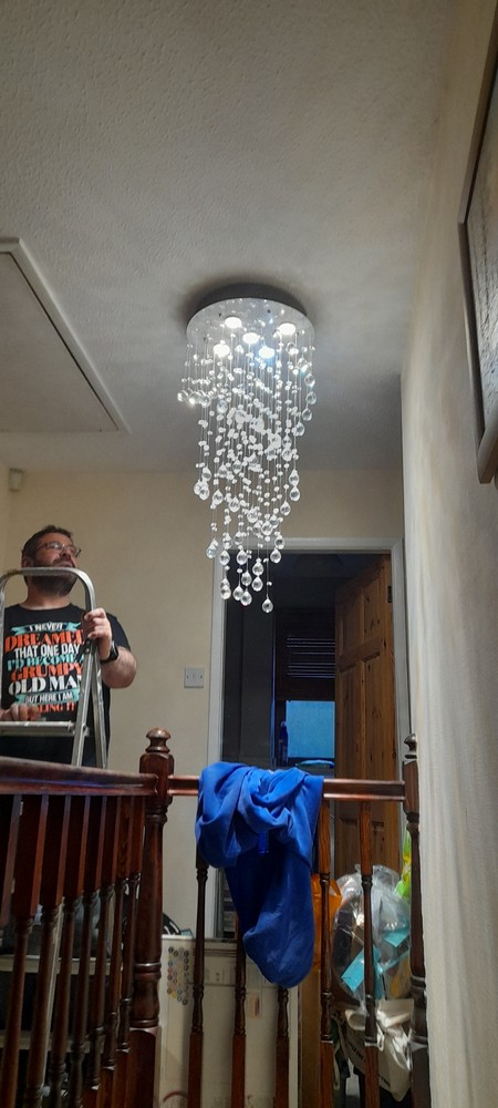

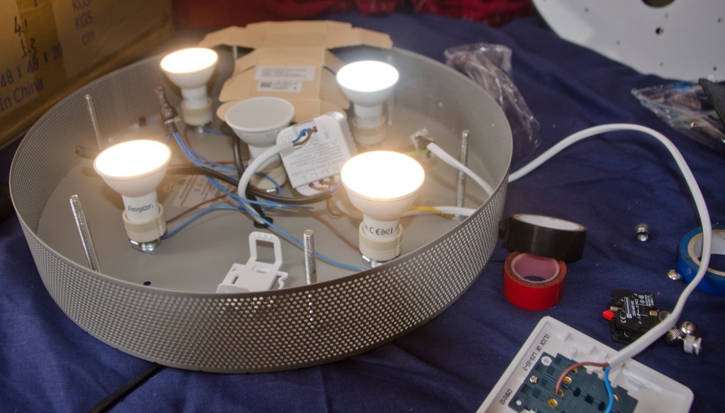

I in hind sight made an error, the light was large enough to take the relay View attachment 297272 so I put the relay View attachment 297273 in the lamp, but the lamp is not easy to assess View attachment 297274 so when the relay started to play up, it was too big of a job to access it again, it works A1 with the zigbee, but it should also work with the light switch, and this is intermittent, some days it will, some days it will not, but saying hey google turn on landing lights always works so not that worried.

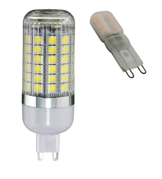

To my mind the problem is we have no idea what is in the bulbs, some are really simple, some are complex, and we get problems with them not switching off, and a shimmer when switched on, and I know the latter is often worse with electronic switches, seems likely some interaction between switch and bulb, but no idea how to cure it other than swapping the bulb.
I had it with G9 bulbs, G9-comp.jpgthe large one has a smoothing capacitor nearly as big as the whole of the small bulb, in general E14, E27, and BA22d bulbs don't seem to present a problem, G9 are a big problem, and GU10 some where between the two, I have had GU10's which have work without a problem for a year develop a flicker, move them to a different room, and flicker has gone. Replace one of five bulbs with a quartz halogen and again flicker on all bulbs has gone.
