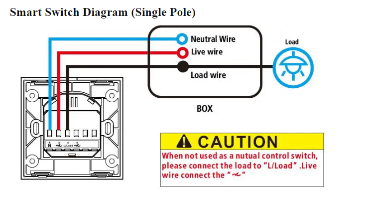

Use a 3 way WiFi switch for a single light?

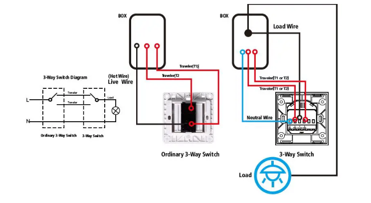

Seems to show two electronic switches, which seems pointless, as why would you want two switches for the same light controlled by an app?
So they can be used manually as two ordinary two-way switches ?
That would surely be equally true if only one of the two switches were 'electronic'?
I think I have to agree with eric here. Unless there was an issue of aesthetics (wanting both switches to look the same), if one has "two-way switching", I see no reason why both switches would need to be 'electronic' (operable by an 'app'). With one of those plus a conventional switch, either could be operated manually and the switching could also be accomplished 'by app' (which would do the same as manually operating vthe electronic switch.

Thank you @JohnW2 yes as said can't see why two electronic switches other than looking the same.

That would be true if they were essentially 'local' electronically-activated switches which communicated via some 'signal wire' (rather than by using conventional 'two-way' wiring). However, I am 'assuming' (I think not unreasonably in this case) that the diagram we have been looking at is correct, which shows two "SPDT" switches connected conventionally by 'strappers'. If that's the case, then it would presumably work just as well if one of the switches was conventional (mechanical).
Yes, I agree.
This would seem to prove you right.
