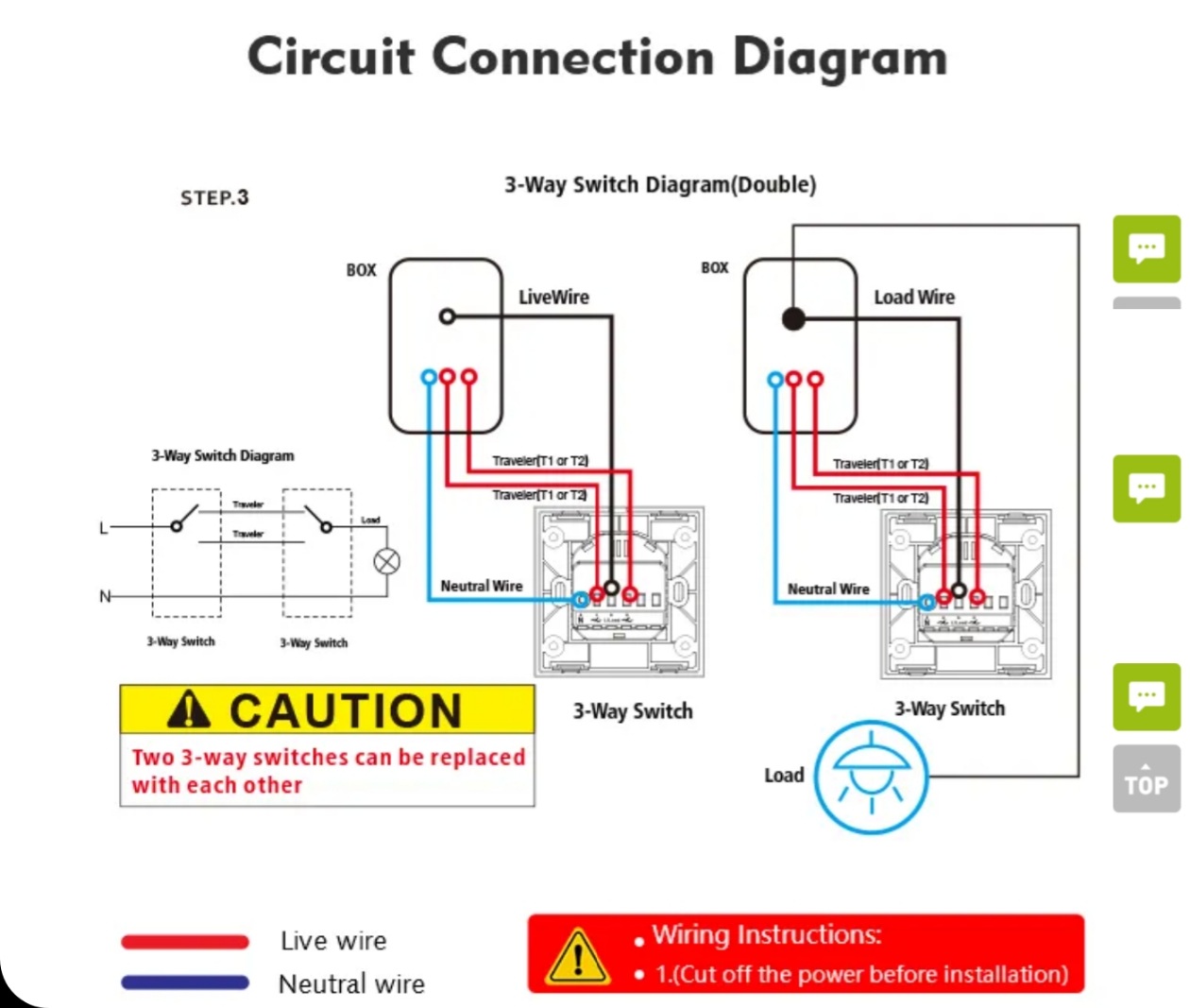

The circuit diagram shows that the switch should work with those connections.
But if it doesn't, just swap the 'L/Load' and 'wavey line' connections.
...and as above, hopefully the blue wires are neutrals!
That diagram will surely confuse the hell out of any inexperienced person.
The schematic on the left is correct but many Diyers are unable to read those, many will require a physical drawing and I cannot put my hand on my heart and say I understand what the middle and right drawings are trying to inform.
I was simply using the diagram to confirm that the switch should work when wired in the way that the OP suggested.
I.e. it shouldn't matter which way the wires were connected to 'L/Load' or 'wavey line' connections...
There are no other connections in the diagram, so for the switch to operate, it must be able to pick up a Live from any of those terminals.

The big question is where does the electronic switch get it's power from? And we simply don't have the answer.
@RandomGrinch diagram
screenshot_20230313-212539_chrome-jpg.298199
Seems to show two electronic switches, which seems pointless, as why would you want two switches for the same light controlled by an app?
However the electronic switches I use have a master and slave set up, we have found the switch KS-641 but not the full instructions for it.
No we don't know, however the drawing shows 2 schemes, middle shows 'Live wire' and right shows 'Load' for the L/Load terminal although it doesn't show what the 'Box' is supposed to be. However it appears to demonstrate it's able to get its power from any of the 3 (Non 'N') terminals.
No we don't know,
I would say we do!
As I said earlier, according to the diagrams, the switch, just wouldn't work (in the 2 ('3') way configuration shown) if they could not pick up the live from the other connections.
I would say we do!
My comment
...however the drawing shows 2 schemes, middle shows 'Live wire' and right shows 'Load' for the L/Load terminal...
(now edited) surely explains the device is designed to work in any configuration.
