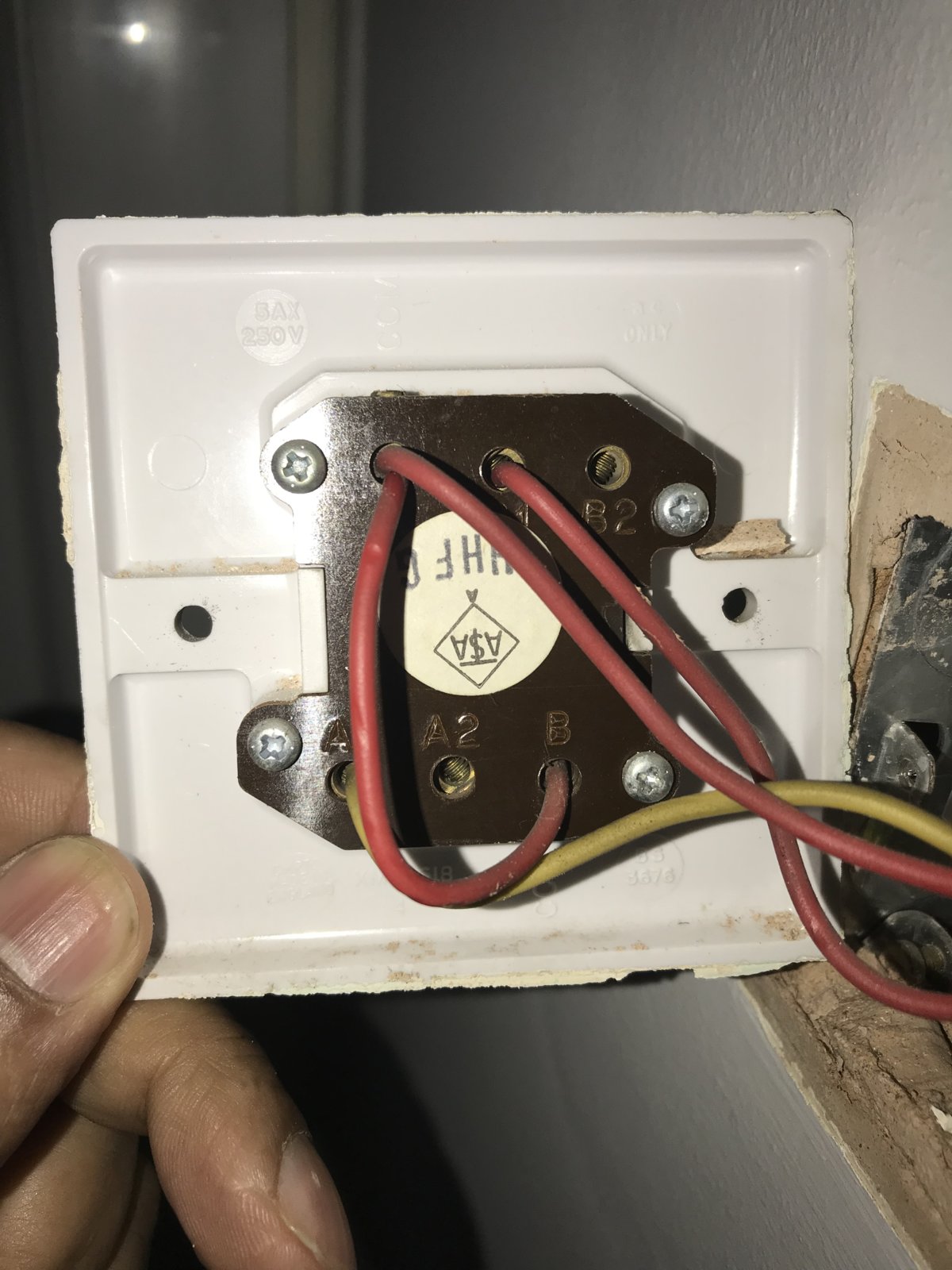

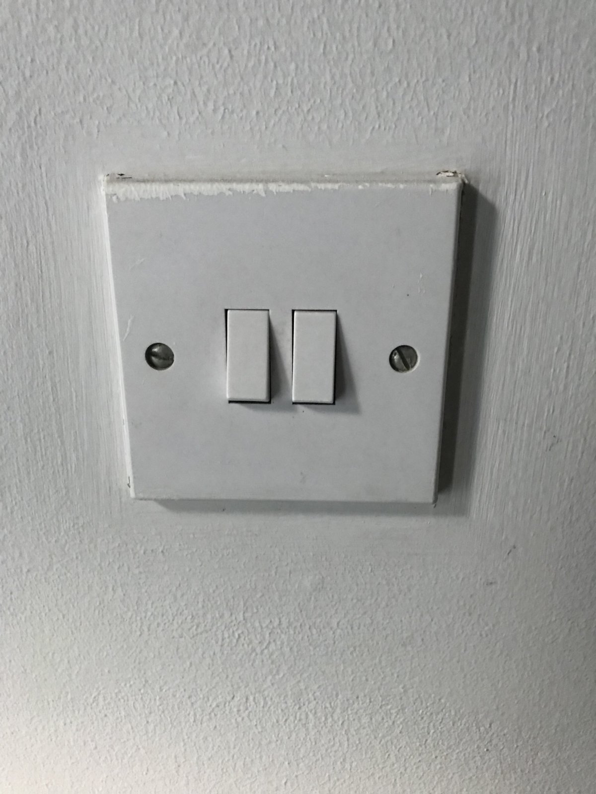

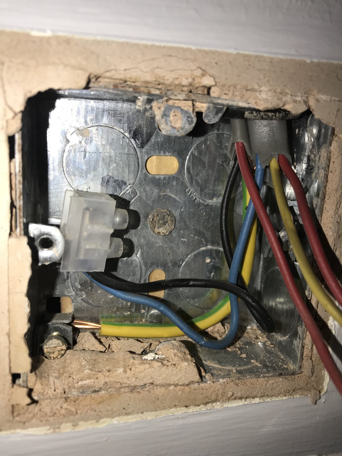

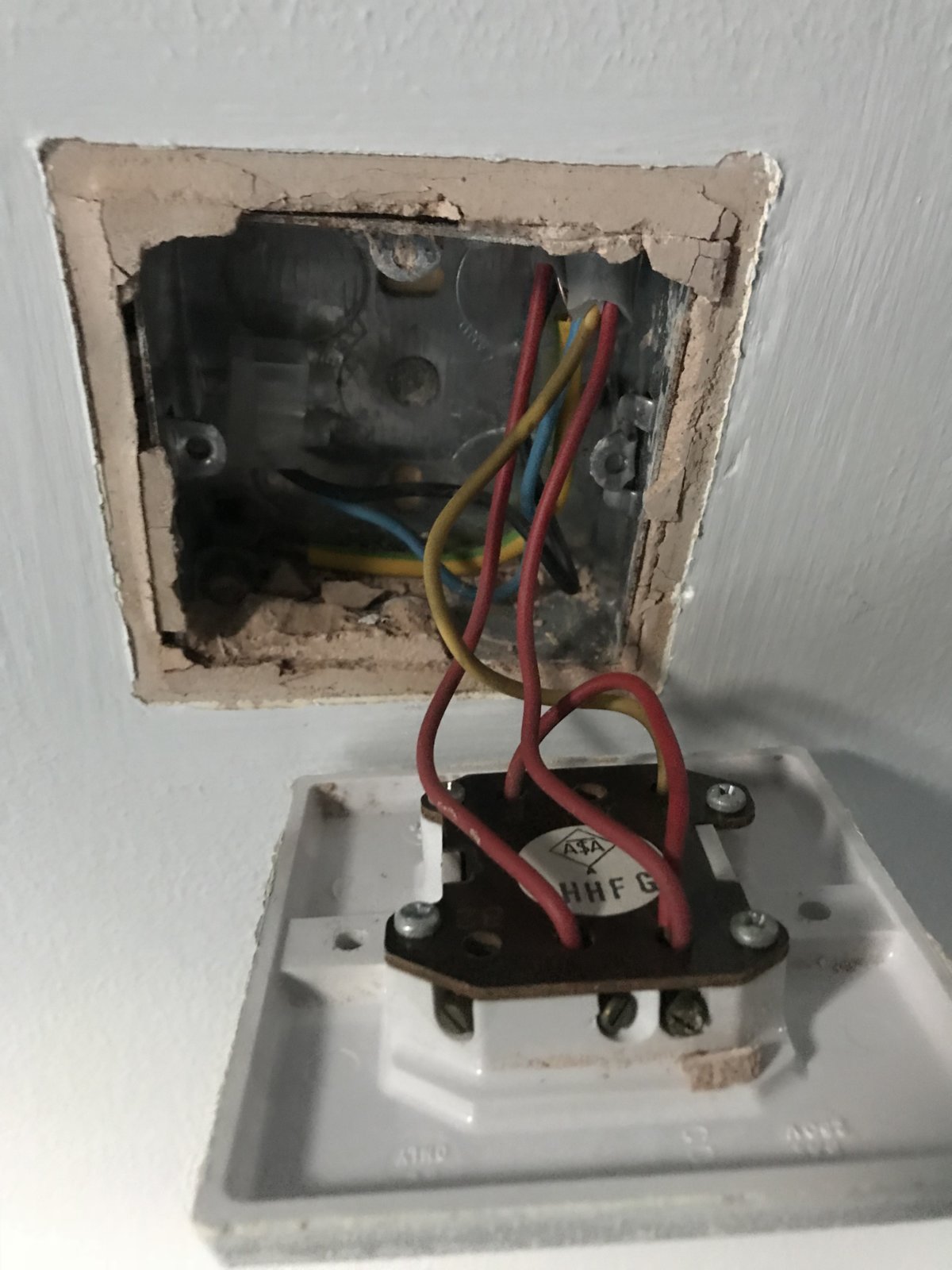

image2.jpeg image2.jpeg image3.jpeg Hi, managed to look at my existing light switch wiring, the two switches are for my outside light and hallway light (image 1). I have posted the pictures below.
I have 2 lives coming through for each light and not sure what the connecting wire is?

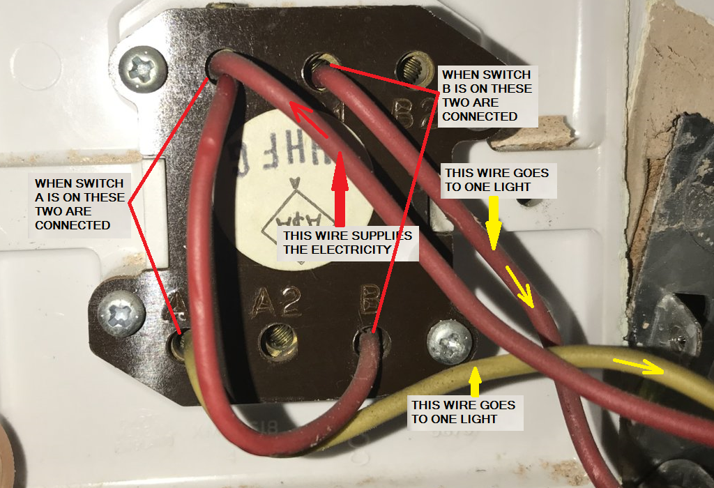

What does a switch do?
What do you think the right hand switch, B, would do without the link?
Therefore, what do you think the link does?
thanks EFLImpudence, i guess without it, it would mean the light would be on constant? sorry i am no electrician and was just looking to see how my current wiring would fit onto the wifi switch?
Your help would be most appreciated.
I appreciate you're not an electrician but you should understand how a switch works.
It just connects together two (or more) wires to make a continuous one so the electricity can flow to the (in this case) light.
Figured out what the link does?
On your new switch,
the wire supplying the electricity will go to L
the wire to one light wil go to L1
the wire to the other light to L2
(there won't be an L3 if you only buy a double switch)
Plus - you will need another bit of wire from the connector block with the black and blue wires to N
Excellent, that makes sense. thank you! i couldn't understand which wire was the one supplying the electricity but you've explained that to me.
