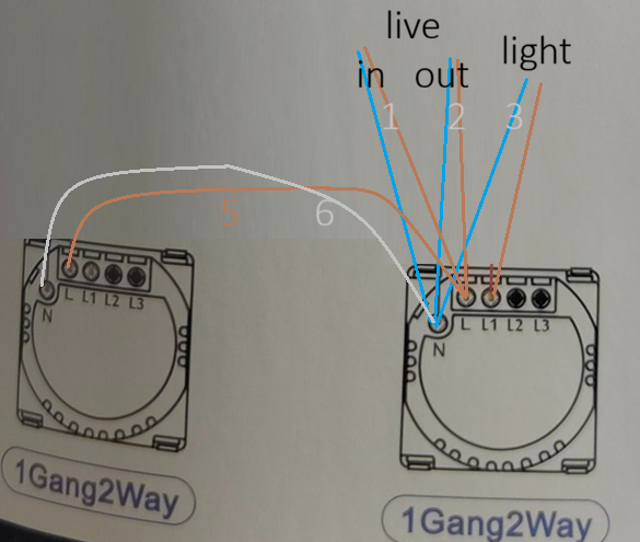

So how many wires do I show in L?2 in each

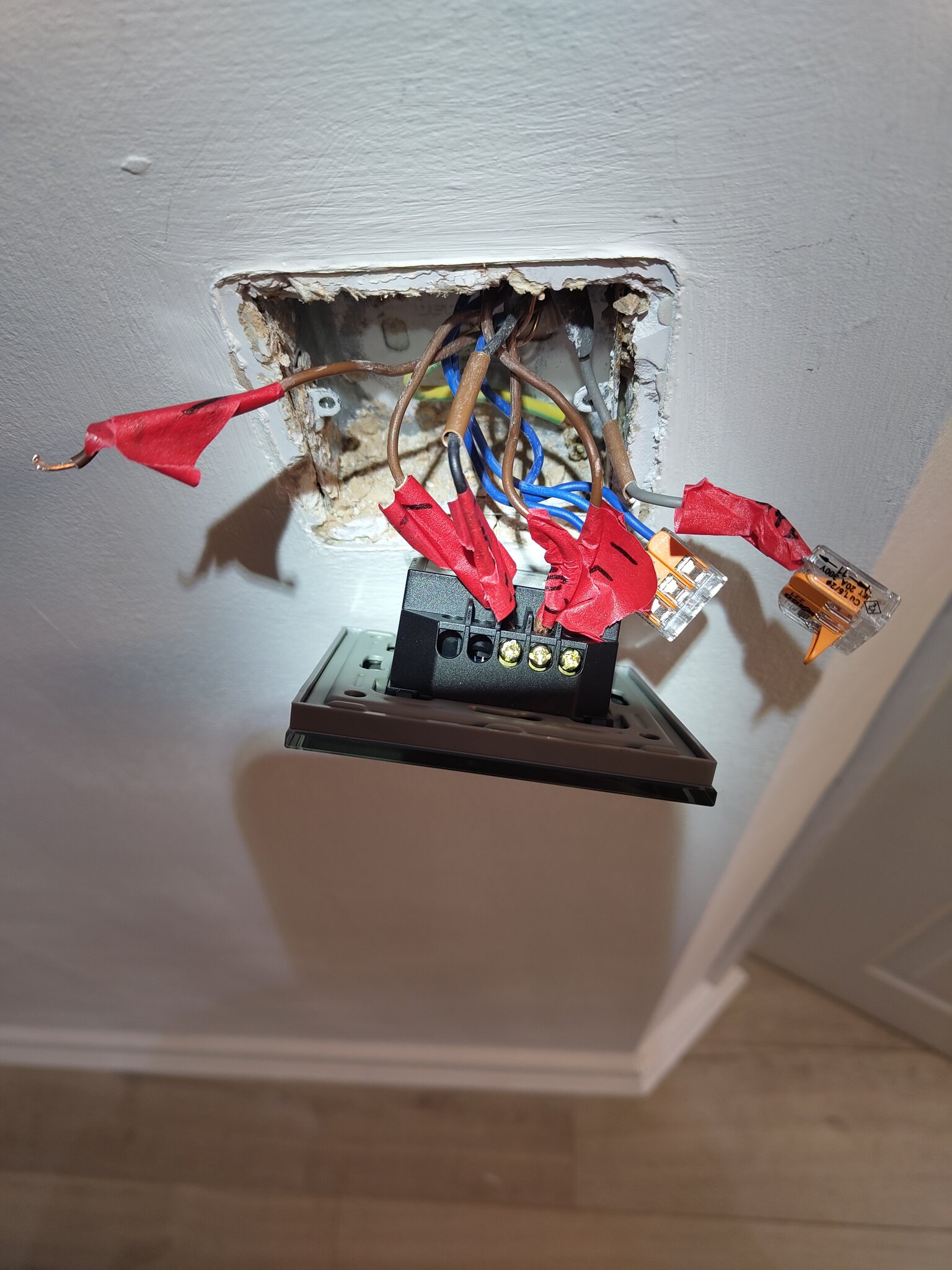

L: Black with brown sheath to send power to the L terminal on switch 2, plus solid brown to send permanent power to switch 1.

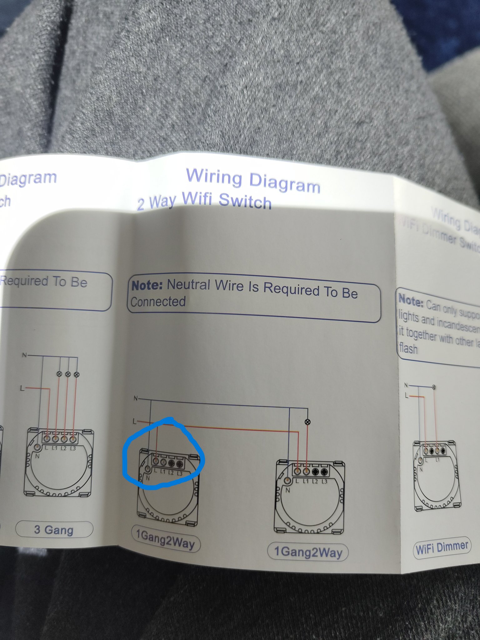

L1: Brown with brown sheath - live coming from light. And a solid brown, again to send power to the L1 port on switch 2 as it won't power up without 12v to L and L1. Despite what the manual says, unless it's defective.

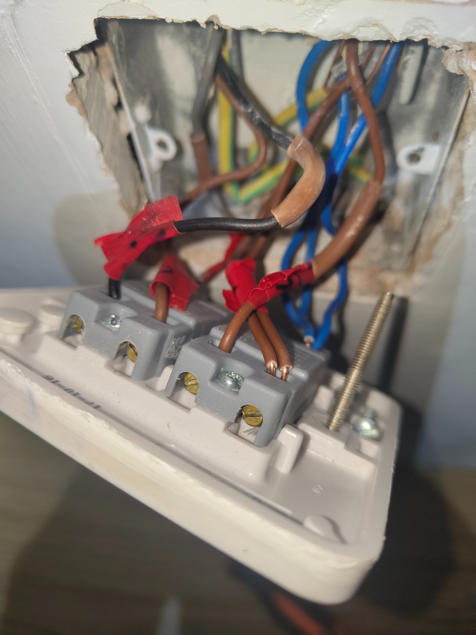

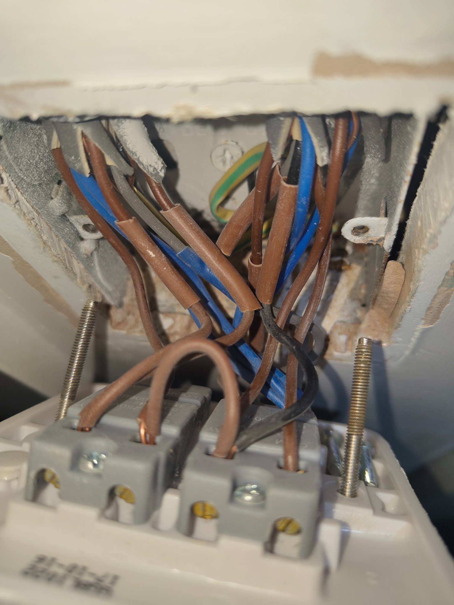

I now have 1 solid brown at switch 1 not connected to anything, and the grey sheathed brown isolated at each switch, not connected to anything.
