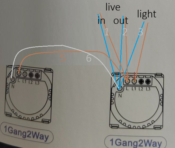

I did as you said and it didn't power on. However I switched the sheathed brown cable (which on the old switch was in the 2 way terminal) with the other 'i way' brown, the switch now works. So the sheathed brown wire must be the wire coming from the light.
To confirm at the master switch:
L = both solid brown wires from old one way terminal
L1 = Sheathed brown, brown wire which was connected to old 2 way terminal
Comm = isolated
3 neutrals = isolated
Black with brown sheath and grey with brown sheath = both isolated
The light turns on and off with no flicker, but switch 2 is dead
My previous clearly shows the sheathed brown in the 2 way position as number 3 and number 3 into the new switch - sadly I used the incorrect image of the wifi switches previosly posted.
This is what I propose next, if yours have no neutral terminal then keep the WAGO
Make the black safe (I'd habitually put it in with the earth at each end but others opinions differ)
I've sent a confirmed 12v feed to the L terminal on switch 2 and it doesn't power up.
I swapped the switches over and it will power up then. So the wiring diagram provided must be wrong. Something has to go into the L1 terminal on the second switch to make it power on

Yes sorry didnt notice, do you not need L1 aswell?
Wire 2 one way switches in parallel?
I have my doubts and the drawing doesn't show it... rather defeats the operation of wifi switches too.
But the 3rd wire (black) is there if it is required
OK I have it working as it should. Switch 2 does need power to L1 else it won't power on. So the diagram supplied is wrong.

Look at my numbers in your photo
Look at my drawing – how many wires in each terminal and which wires are they?
2 in each
L: Black with brown sheath to send power to the L terminal on switch 2, plus solid brown to send permanent power to switch 1.
L1: Brown with brown sheath - live coming from light. And a solid brown, again to send power to the L1 port on switch 2 as it won't power up without 12v to L and L1. Despite what the manual says, unless it's defective.
I now have 1 solid brown at switch 1 not connected to anything, and the grey sheathed brown isolated at each switch, not connected to anything.
