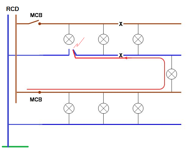

IF those neutrals both came straight from the CU and went nowhere other than to their one respective light, then I don't think there would be any problems swapping them (the two feeds from the CU would be effectively interchangeable). However, if there are other loads connected to either of the neutrals, then EFLI's diagram could come into play (IF one cut some part of the neutral path).
Furthermore, as I have said before, there is, as far as I can see, no problem with intact circuits - since 'swapping' two conductors which come from the same bar in the CU means nothing. The potential problem/danger arises if there are multiple loads and one breaks the neutral path at some point.

Thanks all, so to summarise, as we all know, the line for a circuit is defined by all things connected to the load side of the given MCB.
The neutral for a circuit (and I suppose the CPC) is defined by continuing the line core through all the connected devices/accessories and back to the neutral bar.
If the set of line, neutral and CPC cables doesn't match directly, then there's some borrowing going on (although in which direction and which conductors) the borrowing is, might be a matter of philosophical debate)
There's also the good practice of making sure it's connected to the expected place on the neutral/earth bar, if marked.

Do you have RCDs in your consumer unit? Are the lighting circuits on different RCDs? If yes to both, then they are the same neutral.
Just to reaffirm, this advice is nonsense. If there was one RCD then the advice would be correct. But he said RCD's ie more than one, that means the neutrals associated with either RCD have to be separate.
sometimes the landing light if it has 2 way switching is on the downstairs live and upstairs neutral, but that wouldn't cause you an issue.
That is a descrption of a borrowed neutral. Borrowed neutrals are an electrical shock and fire hazard and have caused many associated injuries and deaths. And anyone that can't understand that dangererous situation, should not be carrying out electrical work.
