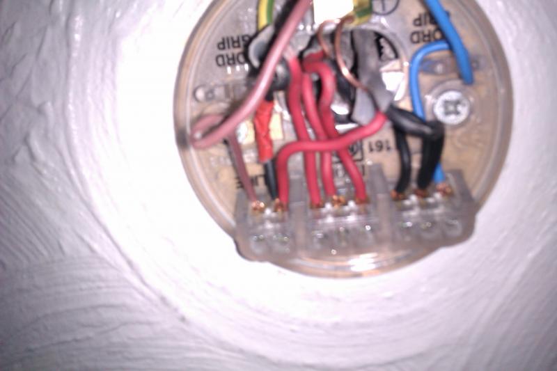

Haven't touched the switchs, apart from to ease away from wall for lining paper behind, and to take the pic attached.
The rose is wired as follows:
Apologies for the pics but the daylight is gone + I'm not going to play with live electrics...
Apart from the amount of copper on display everything looks right at the ceiling rose. I will assume that you took note of how the old ceiling rose was wired and wired the new one the same.
The picture of the switch is a little unclear.
Looking at the picture I take it the rear of the first switch operates the upstairs light and the furtherest switch operates the downstairs light.
I would normally expect to see three core wire here - but it possible that the switches have been wired using the conduit method. Are these single cables or is just the angle of the photograph?
//www.diynot.com/wiki/electrics:lighting:two_way_lighting - scroll down for conduit method.

Assuming the switches worked before lets leave them alone and concentrate on the ceiling rose.
Are you sure that you have correctly identified the Twin & Earth containing the switch live and the Twin and Earth that links to the second light.
The reason I say this is the fact that the front ground floor light is constantly on despite what the switch is doing tells me that it is connected to the live loop.
I feel you may need to clarify this with the multimeter - doing continuity tests while the circuit is dead - but better wait until the morning.
To do a continuity test - make sure the circuit is dead - then connect in a terminal block what you think is the live and neutral of the cable link to the second light. Set the multimeter to low ohms and test between the live and neutral at the second light. A low ohm reading will indicate continuity and you have identified the cable.
Then do the same for the switch wire at the ceiling rose and the switch itself until you establish which is the switch wire.
Then wire as outlined above.
