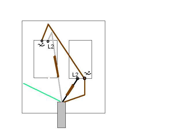

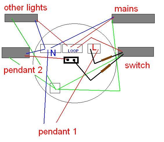

Attached is how I have it wired at the moment. Nothing is working... I'm still as confused as before :(

now tell us how the switch is wired..
the brown may not be the perm live to the switch..
Phil, both your diagarams are correct for the ceiling rose and the 2-gang switch - they're exactly as I said they might be in my previous reply.
That's not to say that you've actually identified those cables in the flesh and connected them accordingly.
You started off by saying that pendant 2 was 'on' permanently, which suggested that you had wired it across the feed at pendant 1. Now you say that nothing is working?

it's changed because he's changed the wiring to suit flameports instructions. .
that picture shows the "live" in the dimmed output of the dimmers..
do the dimmers have a 3rd terminal ? what is it's marking..

Yes Jack, I can see it's changed 'on paper', but having connected the actual cables wrongly in the first place, there's still the chance that a second mistake has been made - even though the theoretical diagrams are correct.
Perhaps the dimmer should be removed and a temporary connector used to join all three wires together, just to rule out the possibility of a faulty switch........
