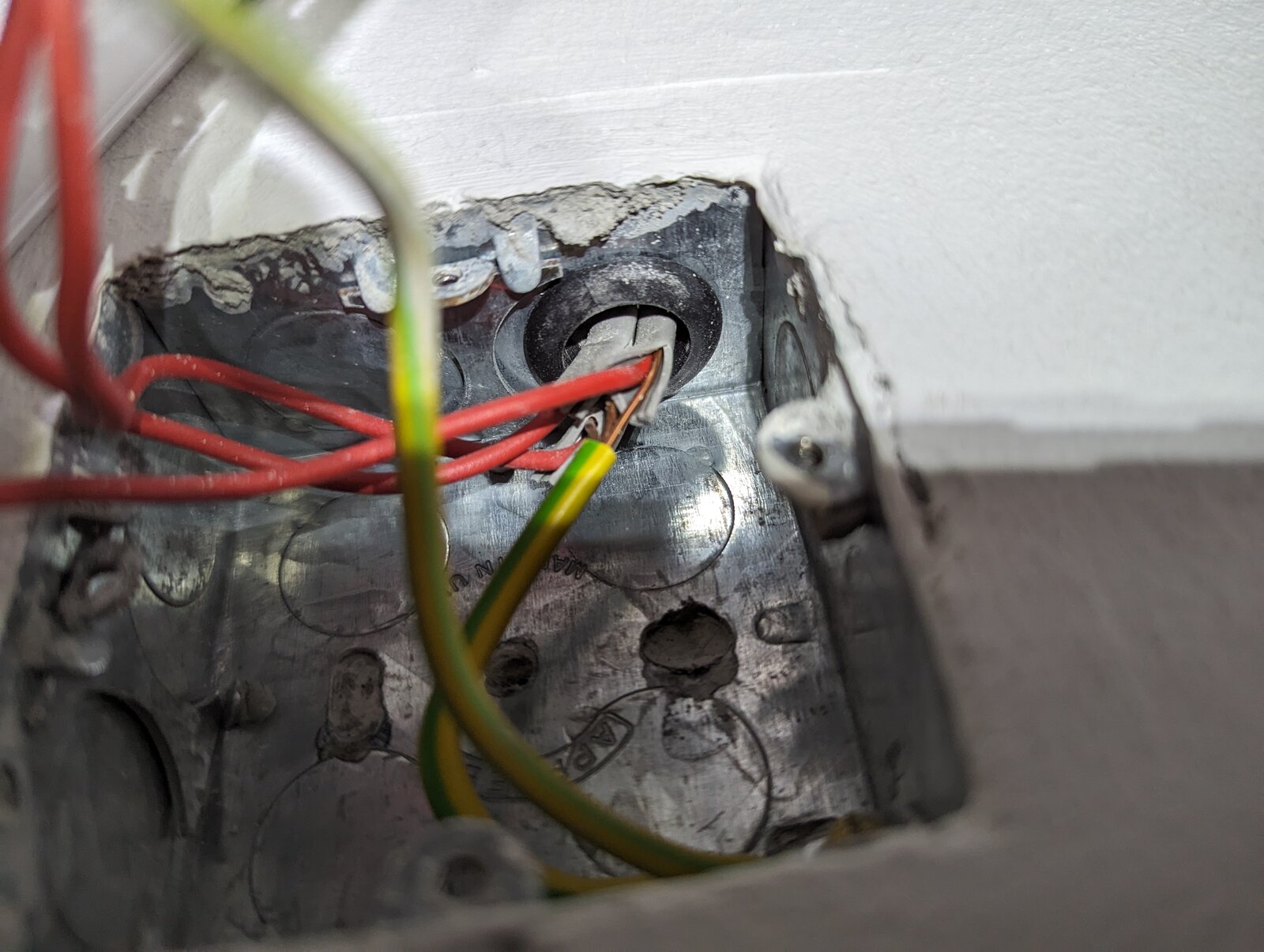

Can we have more pictures of the switch wiring in particular showing where the earth wires(s) come from?
I have uploaded a couple more photos for the switch.
The earth wires seem to be from the single-core live and earth cables

To add more lights, you can only follow the same method by extending the Line(live) from the switches and Neutrals from the lights.
You could run a Neutral from an existing light to new switch and then to new light - or vice versa - if the locations made that easier.
@EFLImpudence The light looks to be in an accessible loft space. Could the OP identify the live feeds looped to the switches and insert a junction box with the looped neutral, then feed new switches and lights using T&E

If the live loop is buried in the wall and terminations not accessible anywhere other than switches the thing I'd suggest is add a junction box to one of the live cables, It is possible that the cable running bottom left to top right for example.
