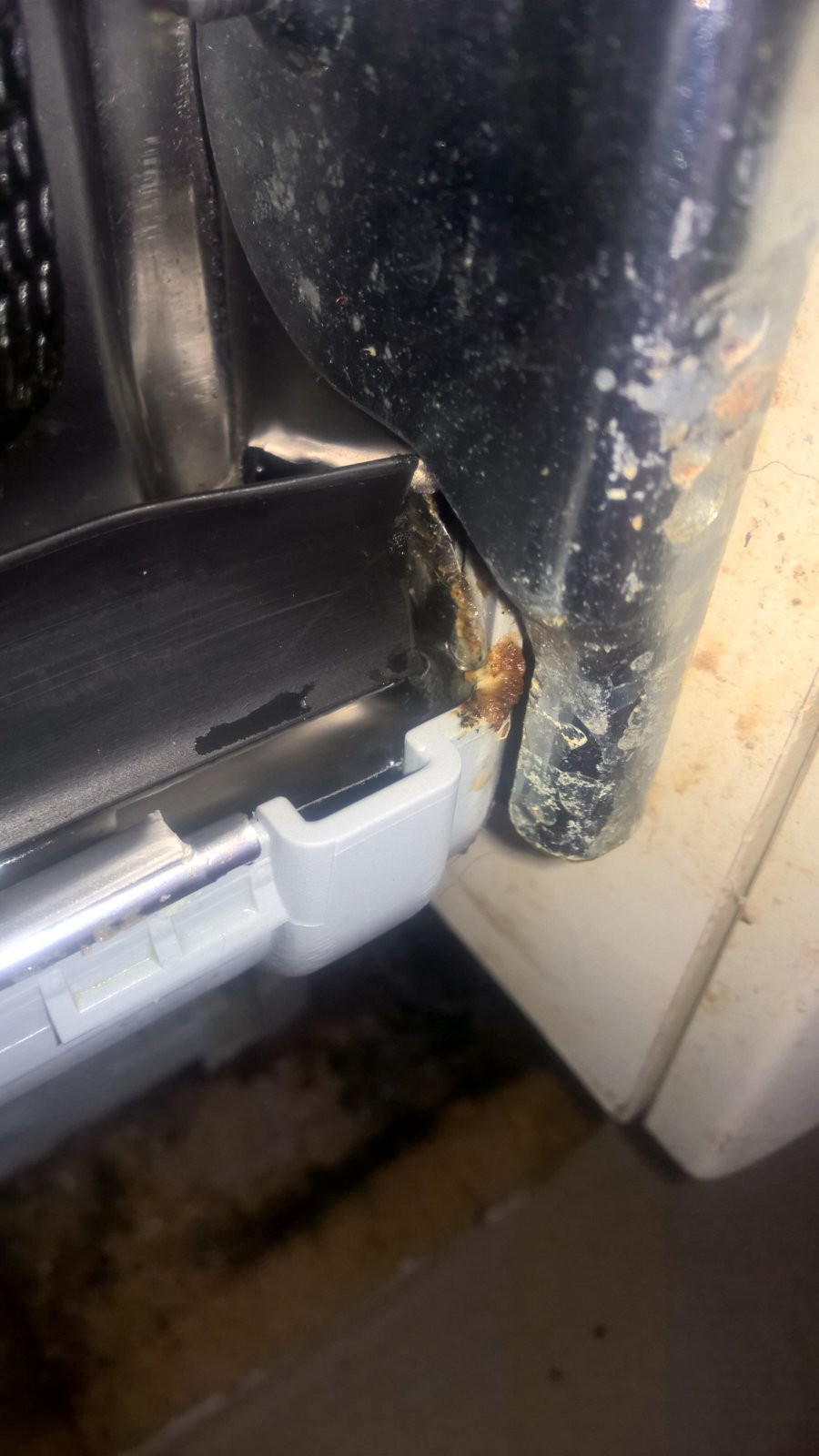

After some advice regarding my dishwasher. It's about 3 years old and about twice in the time period it has stopped working following a build up of water in the base triggering the float switch cut off. However this it now happening every cycle.
After some investigation I have identified where the water is leaking from, it's coming from the door where the wiring connects. I assume that this will be the lower door seal that's failed but just wanted a second opinion before I take the plunge and order the part.

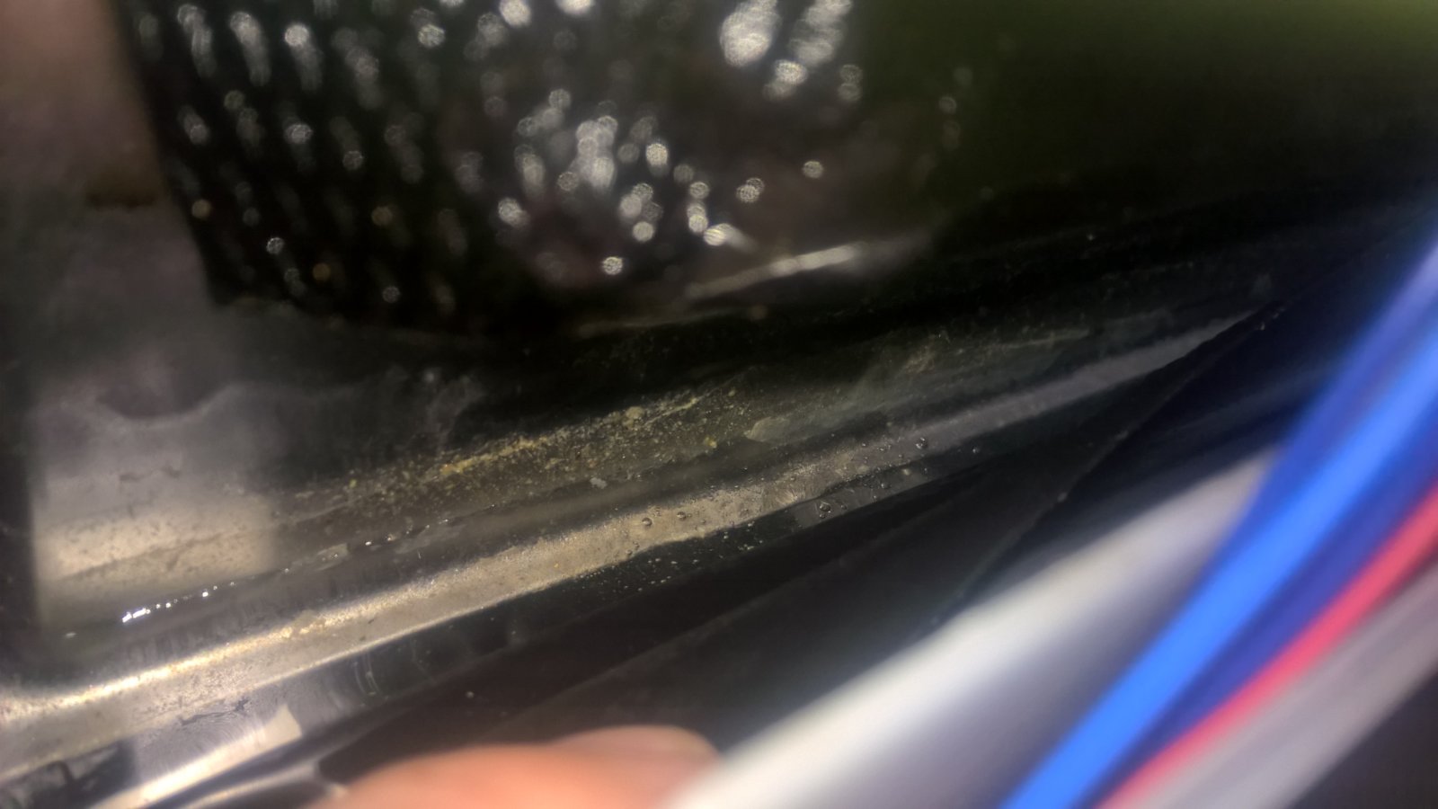

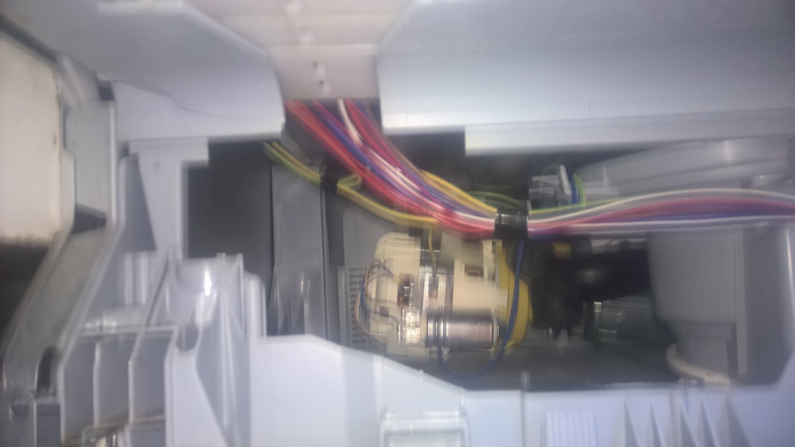

Appreciate this has been a long break but got round to fitting a new lower door seal as everything seemed to point to that being the issue. However it hasn't resolved the issue however having dismantled the door to fit it I now have a better view of whats going on. So the "tray" under the door fills up, primarily through the two gaps in the lower door seal which are present on the original so I assume are there for a reason.
The water then flows into what look like drains/overflows at each end and into the bottom of the machine.
Not being familiar with these things is it expected that a small amount of water gets into this "tray" but then is supposed to drain back into the machine through the gaps in the bottom of the door seal?
In which case if my issue a drain issue, ie. too much water in the machine leads to too much water in the "tray"?

Have a close look at the lower spray arms, they sometimes spilt on the side seams and put a sideways jet of water out, overwhelming the lower seal.
After reading all the above threads which correspond to my problem I took your advice and hey presto the side seem is split! Very many thanks and will try a new spray arm.
