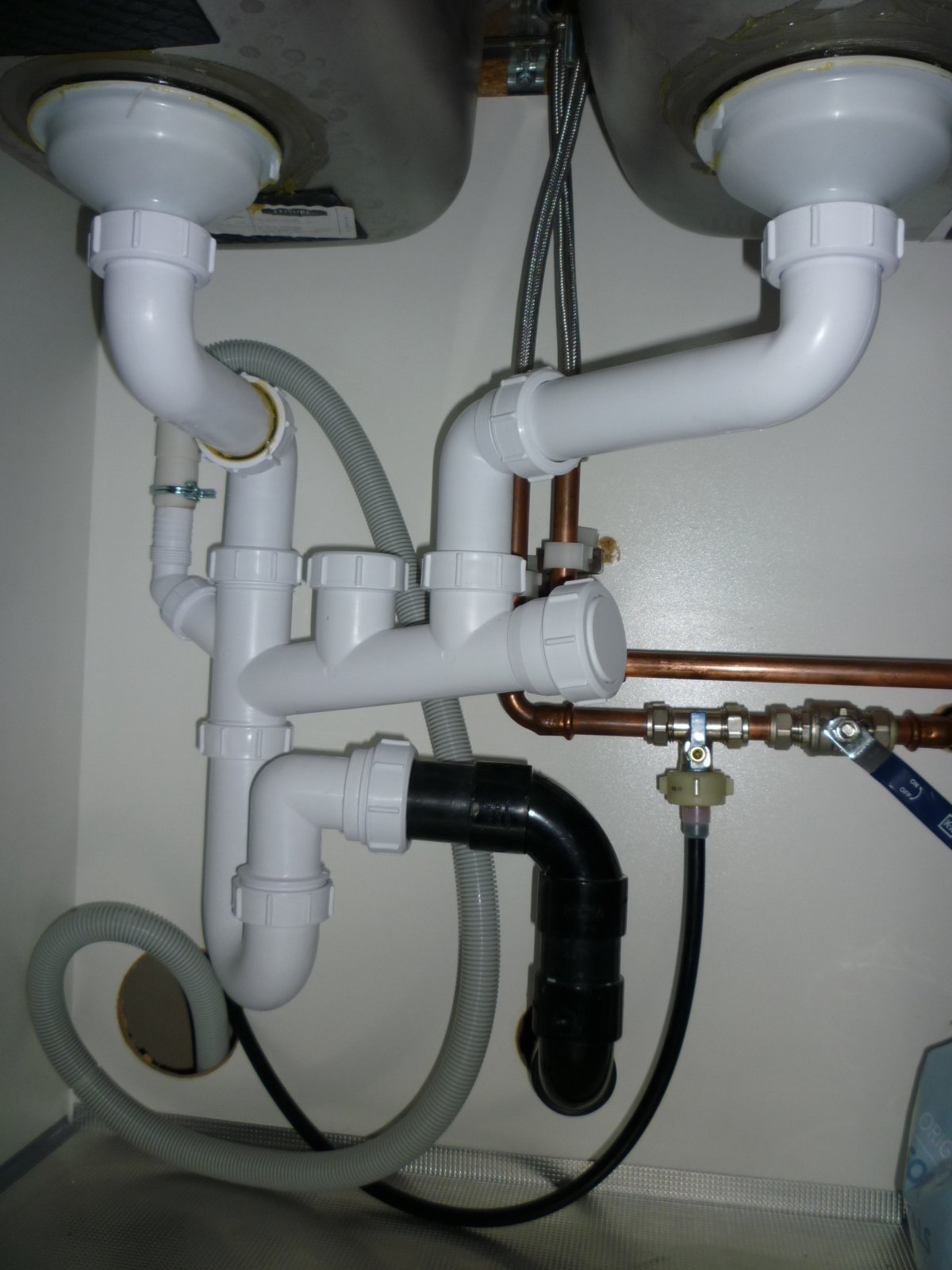

Had a new kitchen installed in 2017 which included a double bowl s/s sink with new drainage plumbing beneath. Since early on, there's been an unpleasant smell coming up through both sink bowl plugholes. I haven't used expensive "foaming" type cleaners but the usual disinfectant, bleach and detergent based cleaners knock the smell back for a week or two before it returns.
Late last year, I dismantled the drainage plumbing beneath the sink, cleaned it thoroughly and reinstated it. No smell for a few months but now it's back. I'd rather not disassemble the drain pipes 3 or 4 times a year or resort to expensive cleaning agents - I'm looking for a more permanent solution.
The plumbing beneath the sink connects the two bowls and the drainage from a dishwasher before reaching the U-bend. This means there's a couple of feet of near horizontal pipework connected to the bowl outlets prior to the U-bend. This seems to be the source of the smell. Would it be a good idea for me to fit a U-bend (or bottle trap?) directly beneath each bowl drain then allow the pipework to join afterwards before joining the dishwasher drain and then a final U-bend through which all drainage will pass?
Guidance and opinions appreciated.

Thanks for the feedback. As suggested, a photo. Note: the sink is designed with no overflows fitted to either bowl. The coiled grey flexible tubing is the dishwasher drain.

Yes so looks like you have space to rectify, although trapped, it's a while after, so smells will get through. I would definitely recommend altering it to prevent smells. 2 traps (x1 appliance - reutilising existing) a tee and some elbows. Also sort drain hose, shouldn't be trailing :)
Before you do anything else, lift that dishwasher hose up, and support it. Any appliance discharge hose should rise up, then fall back down to the drain point, it will currently have a load of dirty water trapped in it, and could well be causing the stink. Waste setup isn't ideal, but I've seen a hell of a lot worse.
Agree with Hugh, that dishwasher hose is wrong and the sink could be draining back into it. I'm not a fan of hoses straight into the sink trap due to noise either, if you put an appliance trap in under there somewhere it would help all round.
Guilty. I fitted the new dishwasher earlier this year and as the smell started over a year ago, the dishwasher probably isn't contributing to the stench - yet. I understand what you mean about the possibility of the sink waste water draining/syphoning back into the dishwasher but there's no sign of that at present. As suggested, I will improve support for the dishwasher waste water hose though (and raise the hose as high as possible in the process). I don't understand what's meant by the hose shouldn't be trailing? It's a flexible trailing-type hose, isn't it?
I appreciate your views on hoses connected directly to a sink trap without venting but I'm not keen on adding an open vent arrangement beneath the under-sink cupboard unless I start getting back-syphoning problems into the dishwasher - though I had such an open vent arrangement for a washing machine in my old kitchen for 20 years without problem or serious smells.
Time for a bit of PP origami!
Hoses are fitted for ease of installation, but still need to be set up correctly. The machine will pump out as required, but it is designed to pump straight upwards, and once over the high point, the water drain away by gravity. This also prevents dirty water from other discharges finding its way back into the machine.
The drain hose also offers the facility to empty the machine, should a fault develop and it stop mid cycle, still full of water.
What I meant by it shouldn’t be trailing, is it shouldn’t be trailing on the floor and be lifted.
