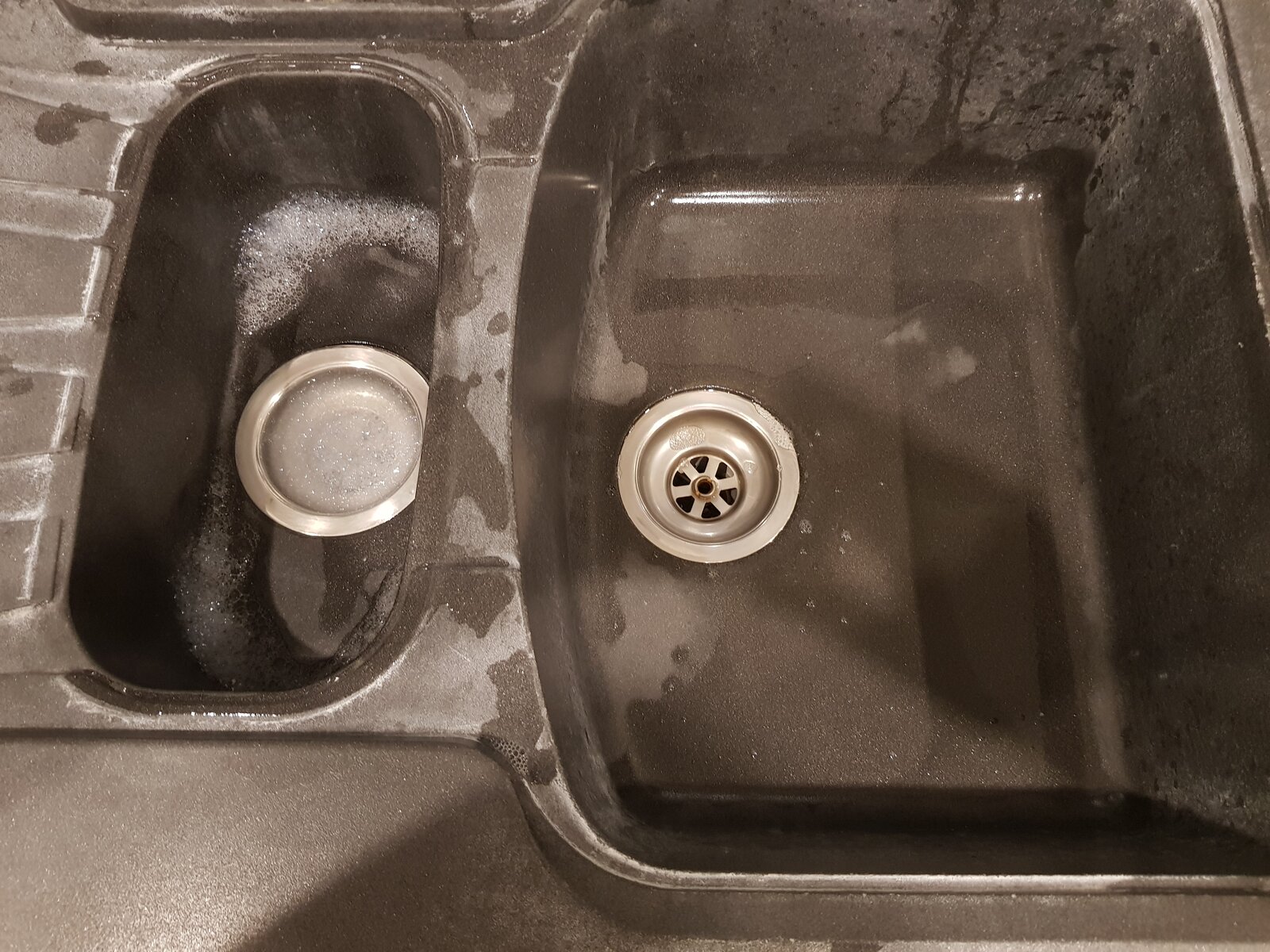

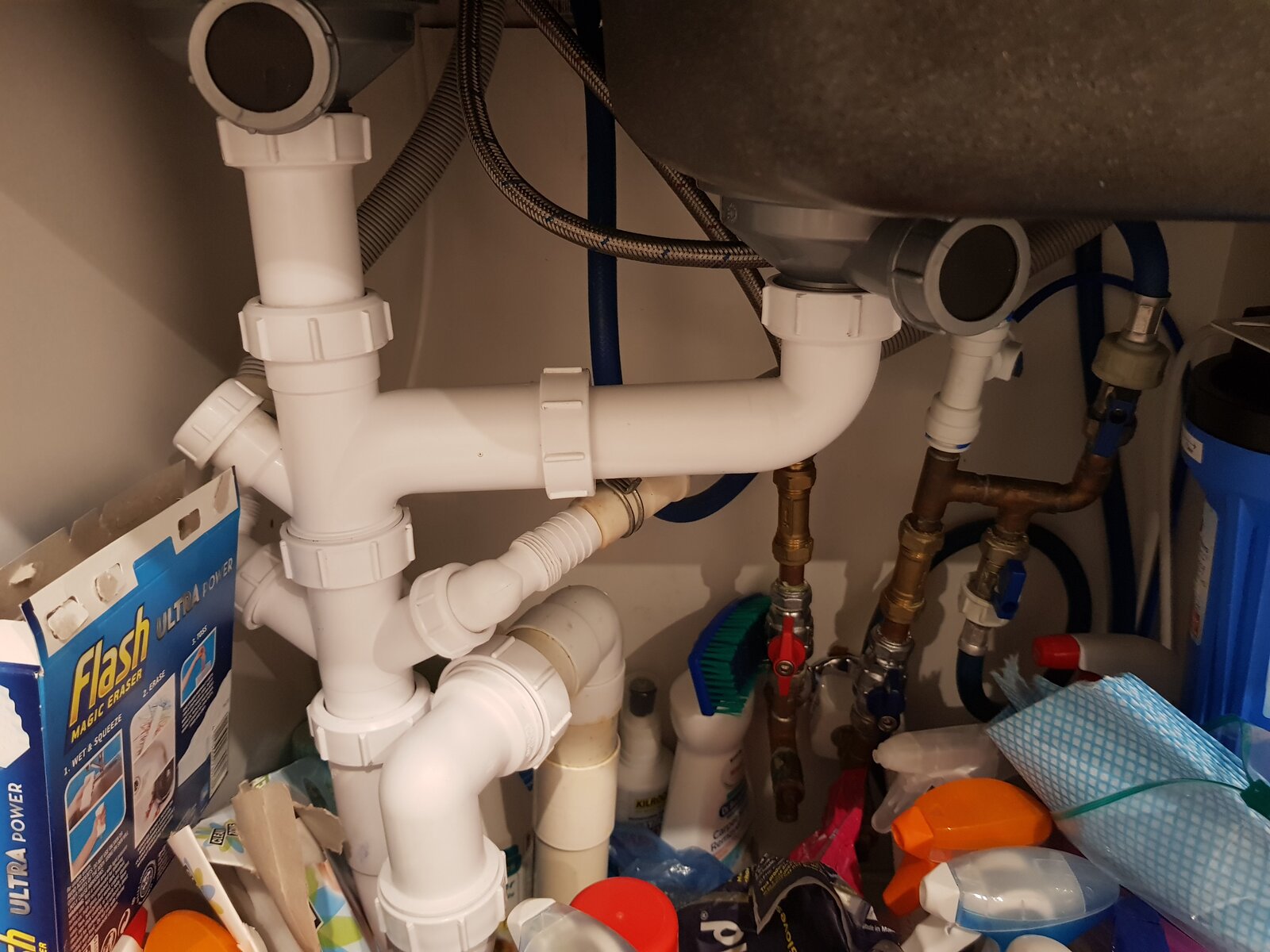

The back of the kitchen cupboard smells really badly of rotten eggs this eve again. Intermittent. The sink waste goes along behind it then into boxing to the soil stack (I opened the boxing earlier to check for leaky or split pipe). I pulled out the washing machine and can't see any leaks etc. Had a washing machine engineer check the washing machine and dishwasher today just to rule it out of desperation but said they are fine it is definitely a drain smell issue....
Is it worth trying to change the AAV in the loft??
Here's photos of the sink

Take off the AAV in the loft and flush all toilets to check correct operation. While you are they fit a new one.

The hole in the roof is the best option but would incur other costs, so best option would be to replace with the Osmadrain, order online and refit.
