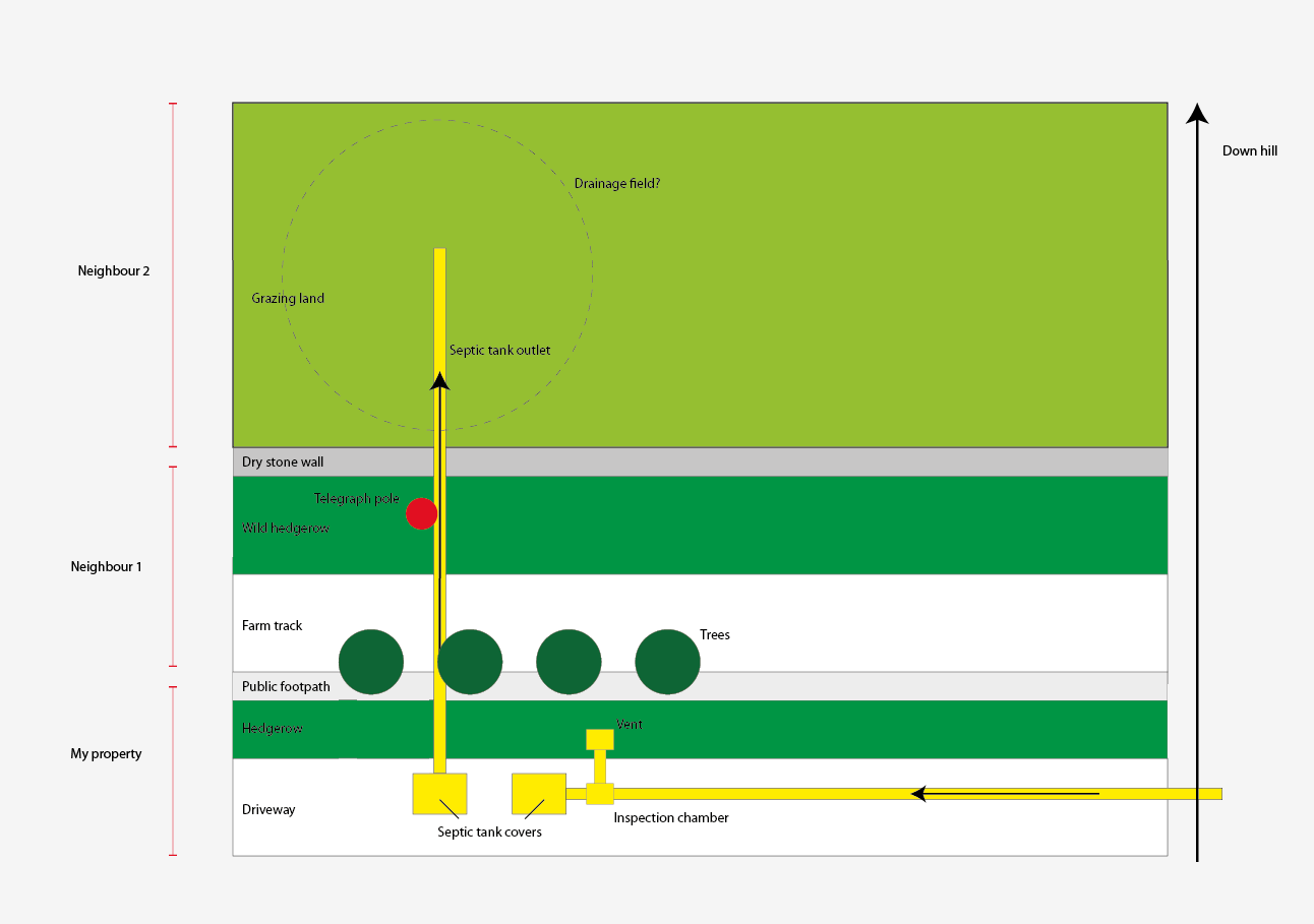

I have drawn up a basic plan to show where I think the septic tank outflow & drainage field may run. One new development is that a new telegraph pole was put in a few months ago, and it would be smack bang in line with the septic tank outlet - the old post would have been a little to the side. Not something I would have even considered to mentioned when they put it in, however I suspect our issues have predated the new post, but might have been exaggerated as a result.
Should drainage fields have an inspection chamber / sample chamber? There is a thick / wild hedgerow before the field. I am wondering if something is possibly buried under it all?

I recently had a similar problem when selling a property. Our septic tank was across a road and in the garden of a neighbour. My neighbour did not use it and had his own tank. It had been there for 70 years but we had no paperwork.It cost us £1500 for a Deed of Easement to be registered with the land registry for both properties. I was lucky that my neighbour agreed to this as it meant our sale could proceed with less hastle.

Normally, any work into the ground requires a detailed ground survey/assessment for underground services. If this pole has damaged the drainage system in any way, then there is negligence, and with that comes the responsibility and costs of putting it right.
If not already done, you may want to have a CCTV or other mapping survey done to determine the layout, location and condition of the system
Stephen Stephen - Honestly I was pretty surprised. I distinctly recall the guy who emptied the tank saying it was around 1000 gallons. So I was surprised to see the water level at the top a month of so later. 2 people bathing and flushing, dishwasher, washing machine and typical grey water discharge. I didn't think we would fill it that quickly. One thing I have noticed is that the old cast covers dont seal that well any more, so I am wondering if rainwater is running off the drive and helping to fill the tank? Not sure how realistic that is, but we have had some biblical rainfall towards the end of last year.
Woody - A CCTV survey is definitely the next course. I know the outlet dip tube has a concrete cap on it, which I assume needs to be smashed off before a camera can get inserted into the pipe. Little concern that trying to remove the cap will also damage the dip tube as well as its clay / terracotta. When the new posts were put in they just rocked up, ripped the old ones out and drove the new ones in, pretty certain no survey was conducted.
