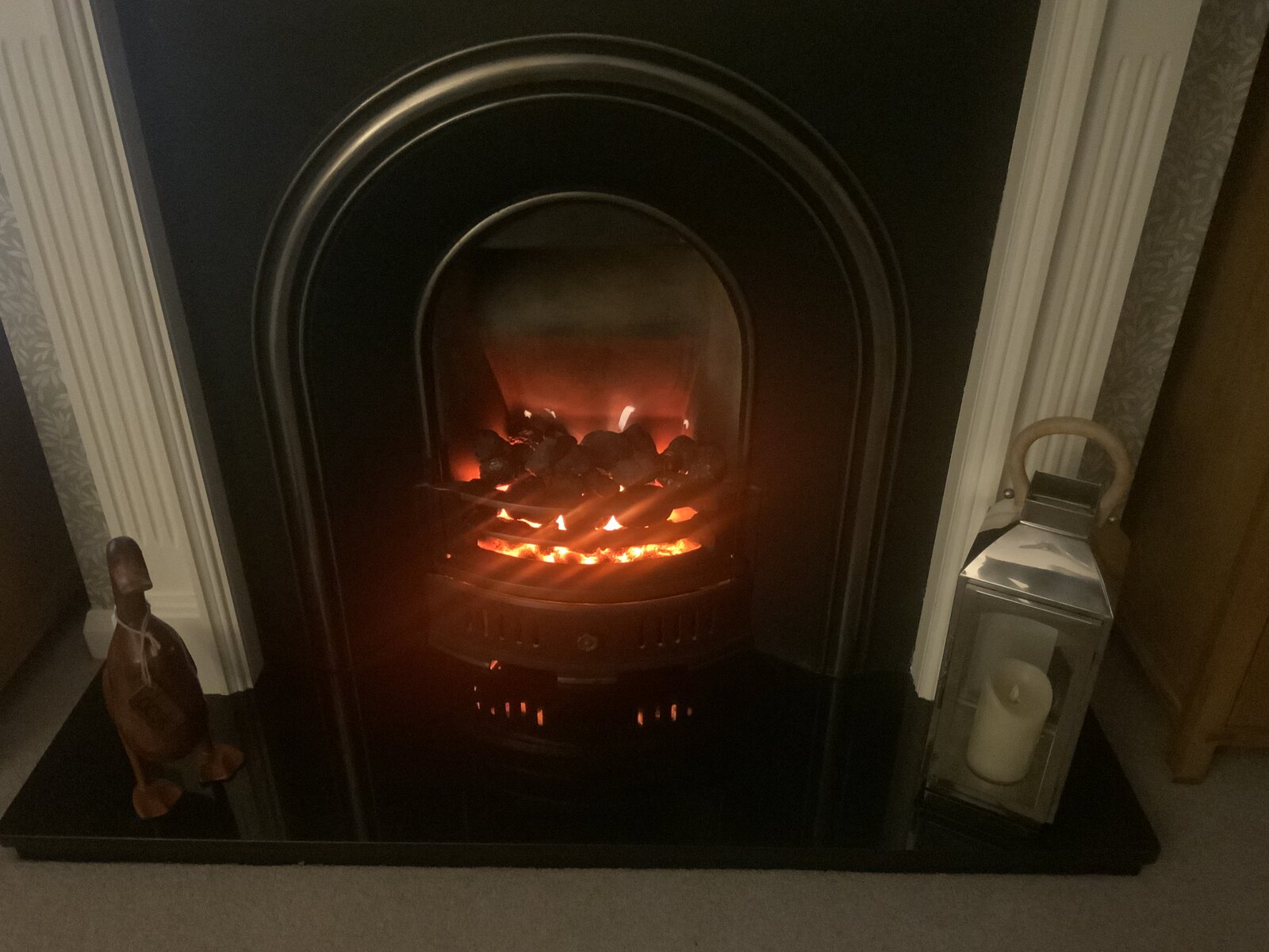

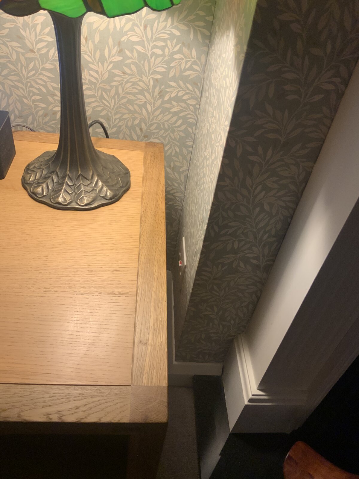

We have a false chimney breast in our lounge (so in effect, no different to what you have) with a socket inside to power an electric coal effect fire with a fan heater. Only ever used the heater a couple of times when heating was broken so it's mainly for show. The socket inside is fed from a switched spur on the side of the breast which is connected to the downstairs ring.
Providing that the socket itself and therefore any plugs in it are not subjected to excessive heat then it seems to me to be a good idea to have a DP switch in a more accessible safe postion to control it . Likewise some slight ventilation to avoid it becomming a dead air space too.
This is perfect - as it's almost identical to what we will have.
Any electric "wood" burner we fit will also be mostly be used for decoration and lighting effects rather than actual heating, as we'll be relying on the central heating to do all the heavy lifting on warming the room.
It's always reassuring to know other people have taken the same approach.
