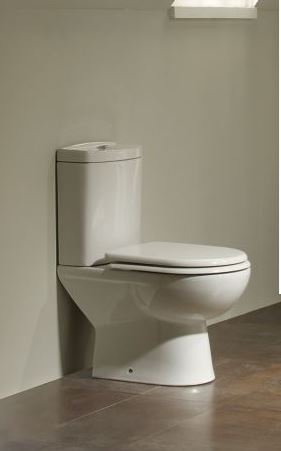

I want to have the soil pipe from the toilet pictured above going out to one side, rather than straight out the wall at the back of the toilet.
To achieve this, do I need either a
a) FloPlast SP561 92.5° Bend Double Socket 110mm
or
b) FloPlast SP161 92.5° Bend Single Socket
(both pictured below) or something else? Thanks!

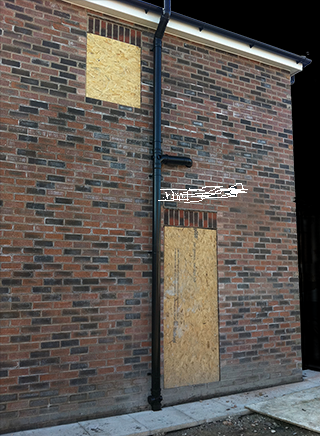

It's something like the image below.
There is currently an external soil pipe attached to the stack pipe, but this soil pipe will now be in the wrong place and no longer required.
The new soil pipe will be longer and will attach to the stack pipe slightly lower down in an uncut section of the stack pipe. (As I have sketched in white below).
Does this answer the question?
Once you've determined where to cut the stack
You need one of these http://www.screwfix.com/p/floplast-sp502-92-5-access-branch-black-110mm/49750
Connected to the stack with one of these http://www.screwfix.com/p/floplast-sp105-double-pipe-coupler-black-110mm/47977
With this, cut to length, for the new branch http://www.screwfix.com/p/floplast-sp3g-single-socket-soil-pipe-black-110mm-x-3m/49565
With this at the end (to go throught the wall into your bathroom) http://www.screwfix.com/p/floplast-sp161-92-5-bend-single-socket-black/70115
And a few of these to hold everything to the wall http://www.screwfix.com/p/floplast-sp82bl-pipe-clips-black-5-pack/76037
If you're lucky, you may be able to get the old section of the soil/vent pipe to fit into the top of the new branch.
