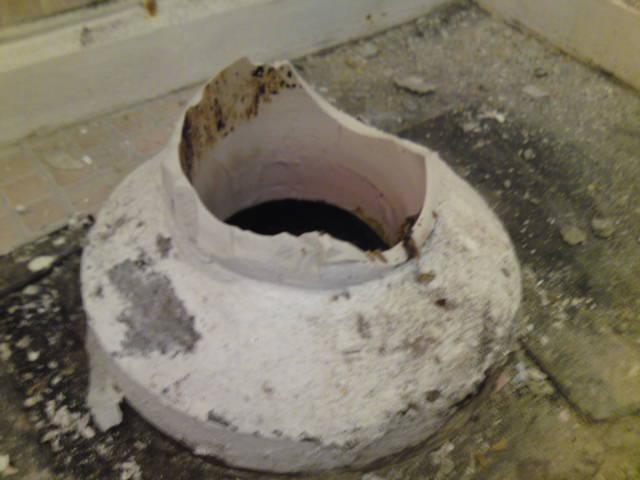

I am in the process of fitting a new toilet in my flat and I am not sure how to tackle the soil pipe. The original toilet was a nightmare that was cemented into the floor and took ages to remove and level the floor.
The white collar around the soil pipe is either cement or something stronger, as you can see from the picture some of the toilet pipe is still attached.
My question is how should I now proceed?
Should I take a cold chisel just to the toilet remains and get rid of as much of it as possible without damaging the white collar?
Presumably a can then get a fitting that just pushes into the white collar?

Chisel away remains of WC without dropping china down hole (try wedging a bag in to catch debris). Once smooth a standard McAlpine pan-con should fit in cement collar.
Nock off the White/brown :x collar level to floor :idea: Watch the ceramic remains of WC pan :!: Like a razor ...those edges :shock:
You can also use Brick acid the type they use for cleaning, this should soften the cement and make it easier to break away. Be carefull it BURNS

Sorry, I know this post is old but I have the same problem. A victorian house I am renovating has this pipe and collar fitting. The plumber has told me I will have to change my toilet as it won't work with this fitting.
Am I understanding the above posts properly? Basically stuff a bag or something into the hole to stop debris going down. Then get rid of all the visible pipe above the floor - take it down so that it is just a hole in the ground (level with the floor). Then fit an appropriate McAlpine pan convertor?

Personnaly I would not take the pipe down so low so its just a hole in the floor, if there is any movement or leaks with the WC, you may not notice it before its too late.
Either chip away the mortar around the rim, or cut away female coupling rim, leaving part of the soil pipe above floor level and connect suitable pan connector
