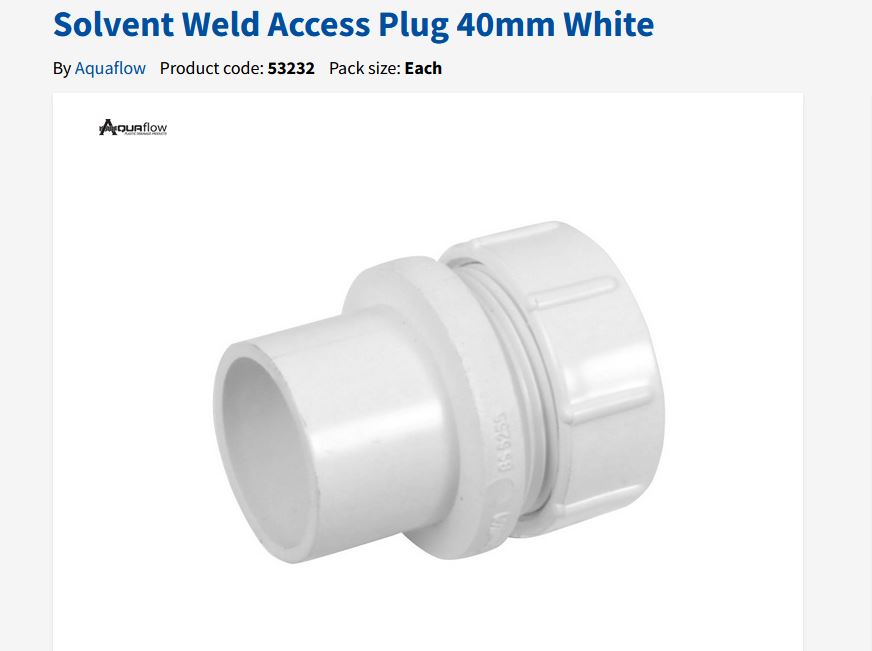

For the blanking plug, is this an ideal product?
https://www.screwfix.com/p/mcalpine...55281954514&ds_rl=1249404&gclsrc=ds&gclsrc=ds
What you have in your link is wrongly worded, it is a blanking "CAP" for capping off a pipe, what you want is a blanking "PLUG",
this will push straight into the boss pipe, no need for any other pipe or fittings.
https://www.toolstation.com/solvent...kJWVH9CZqUpK5i3jg14aAmfIEALw_wcB&gclsrc=aw.ds
"Sometimes" it is possible to cut the end off the pushfit boss and solvent weld a 2" coupler over it with a plug glued into other side of coupler.
You may find that those access plugs may be a little too small to fit into the push fit sockets tightly, especially if the seals are worn. No reason not to try though.

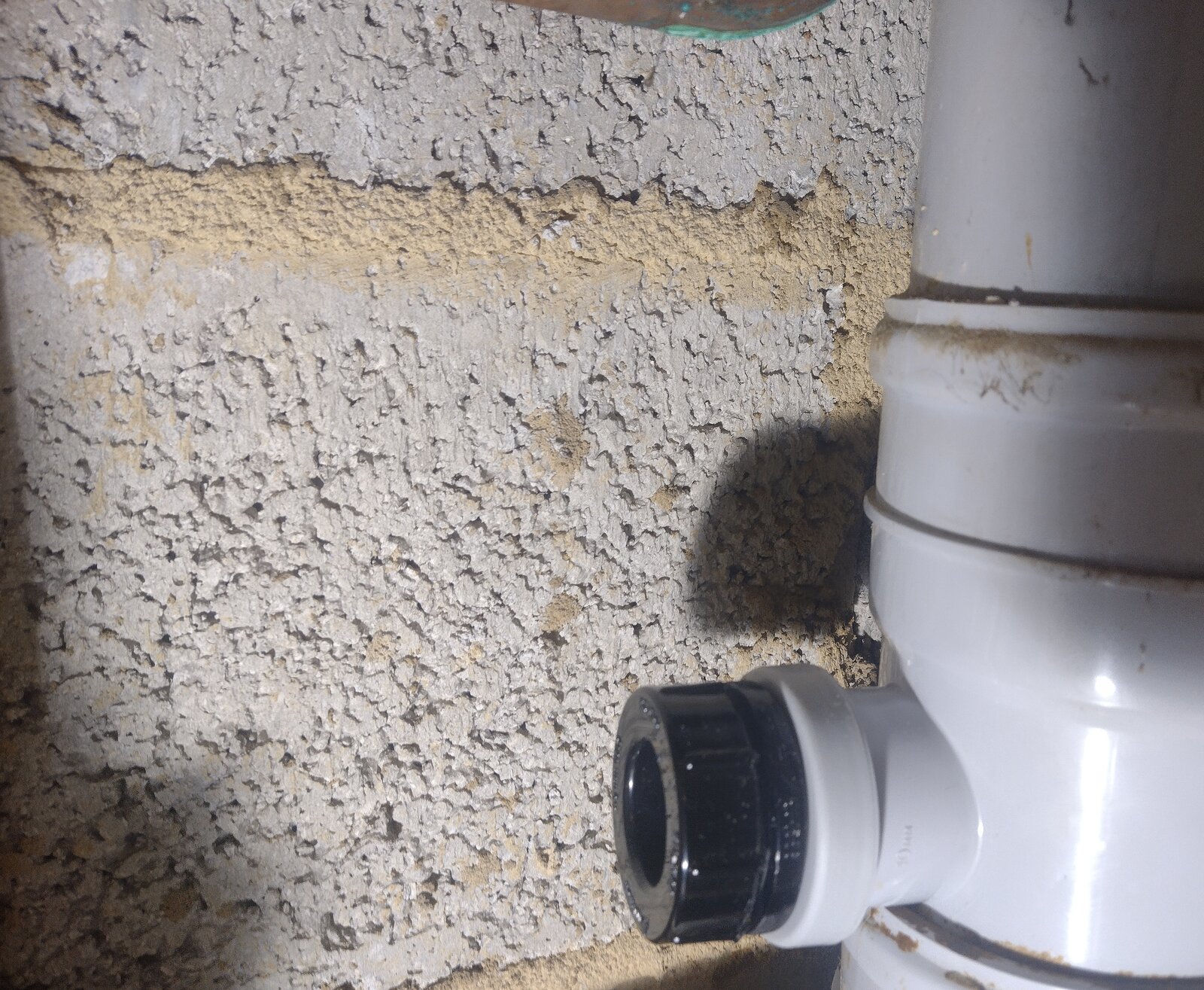

The plug went onto the boss adapter with a nice tight fit. The leak is sorted :D:D

I spoke too soon
I just noticed that I have a small weeping drip now
It looks like it's coming in the area between the plug and the boss adapter
What is the best action to take now?
Silicone around the plug and push in again?

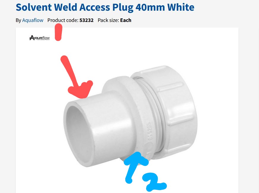

Yup .... did you squeaky clean and dry the seal and internal area of the boss??
Use a little silicone adhesive on the fitting, like Wet Grab/Strong Stuff or similar, not a normal sanitary silicone and give it a twist or 2 when fitting
The adhesive will grab in wet conditions and then set permanently like a firm rubber, a normal silicone won't seal if it's at all damp (like behind the seal).
Yup, CT1 will do the job fine, just a light coating on 1 will do, as you fit it, twisting as you go, it will coat the seal and boss and will push the excess adhesive out and up against 2. Just wipe round with a cloth to clean it up once it's all the way in, might want to use rubber gloves as it can be a mare to get off the skin.
