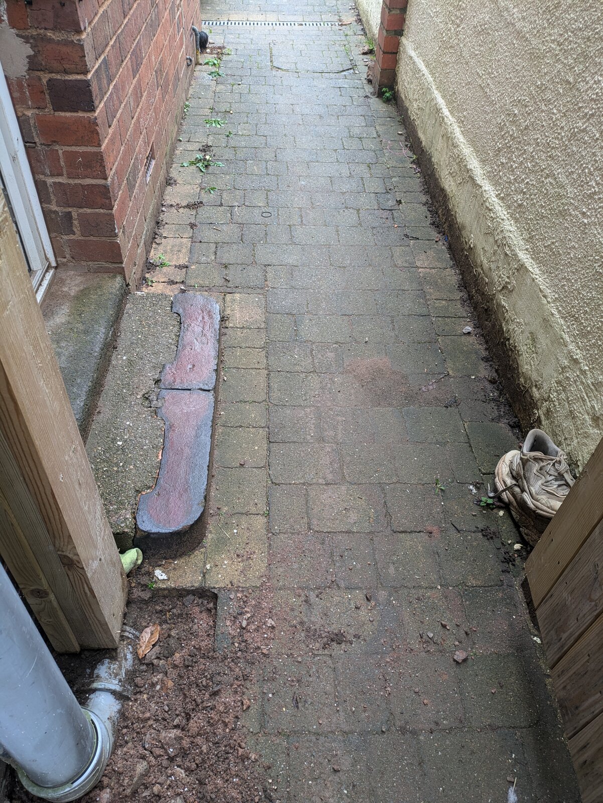

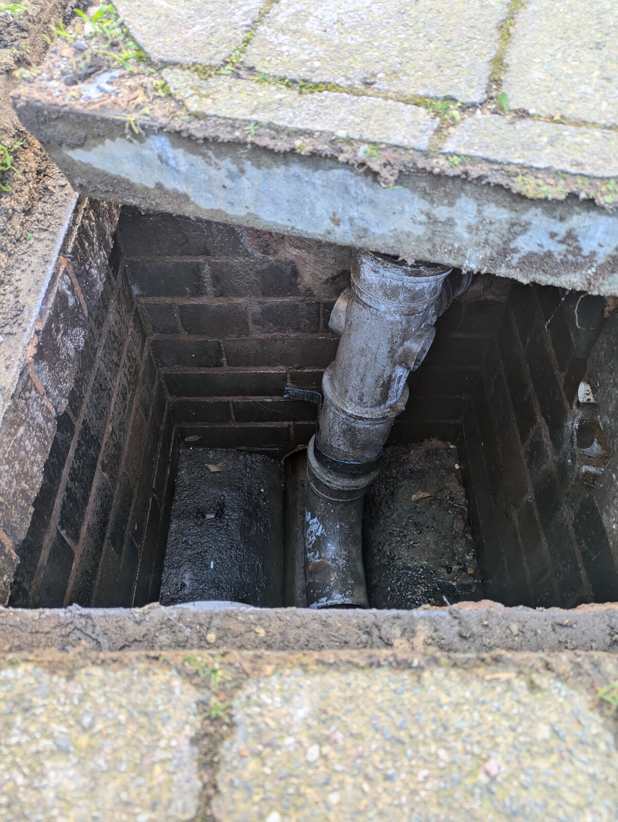

I would certainly agree with @Hugh Jaleak and recommend that as this needs doing that the original pipework is set @ a lower level if possible. Being monobloc it's shouldn't be too much of a challenge and there seems to be enough room certainly have enough room. Can the chamber cover be lifted to see how deep the chamber is? Could also look to alter the drains routing and get it away from that step.
The chamber entry may not be the deepest so to allow for the fall on the pipework, that may be why the initial pipe run is so high.
thanks mate I'll get the drain cover and take some photos

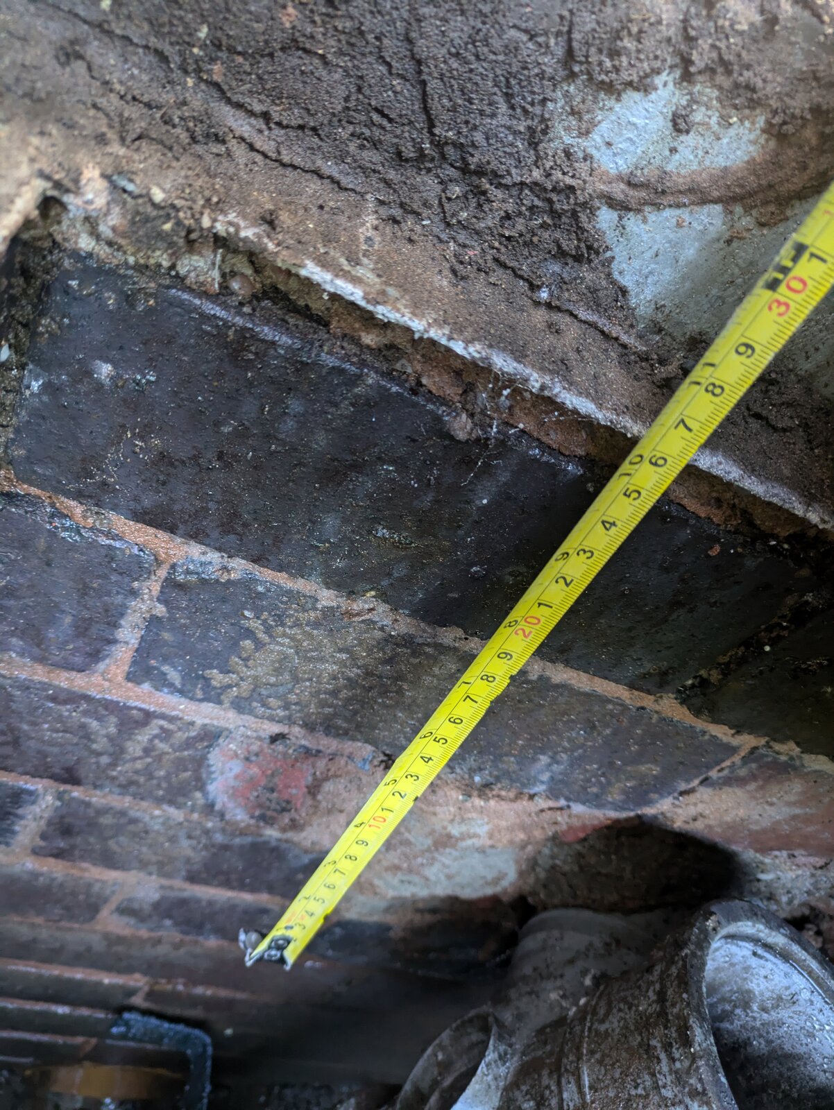

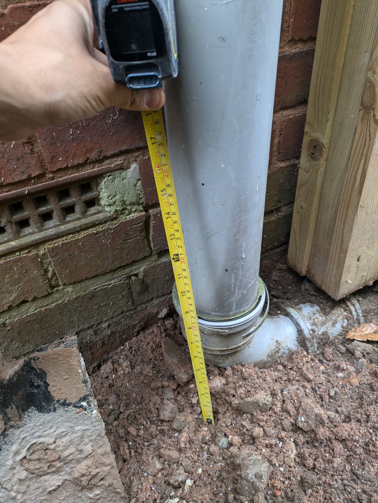

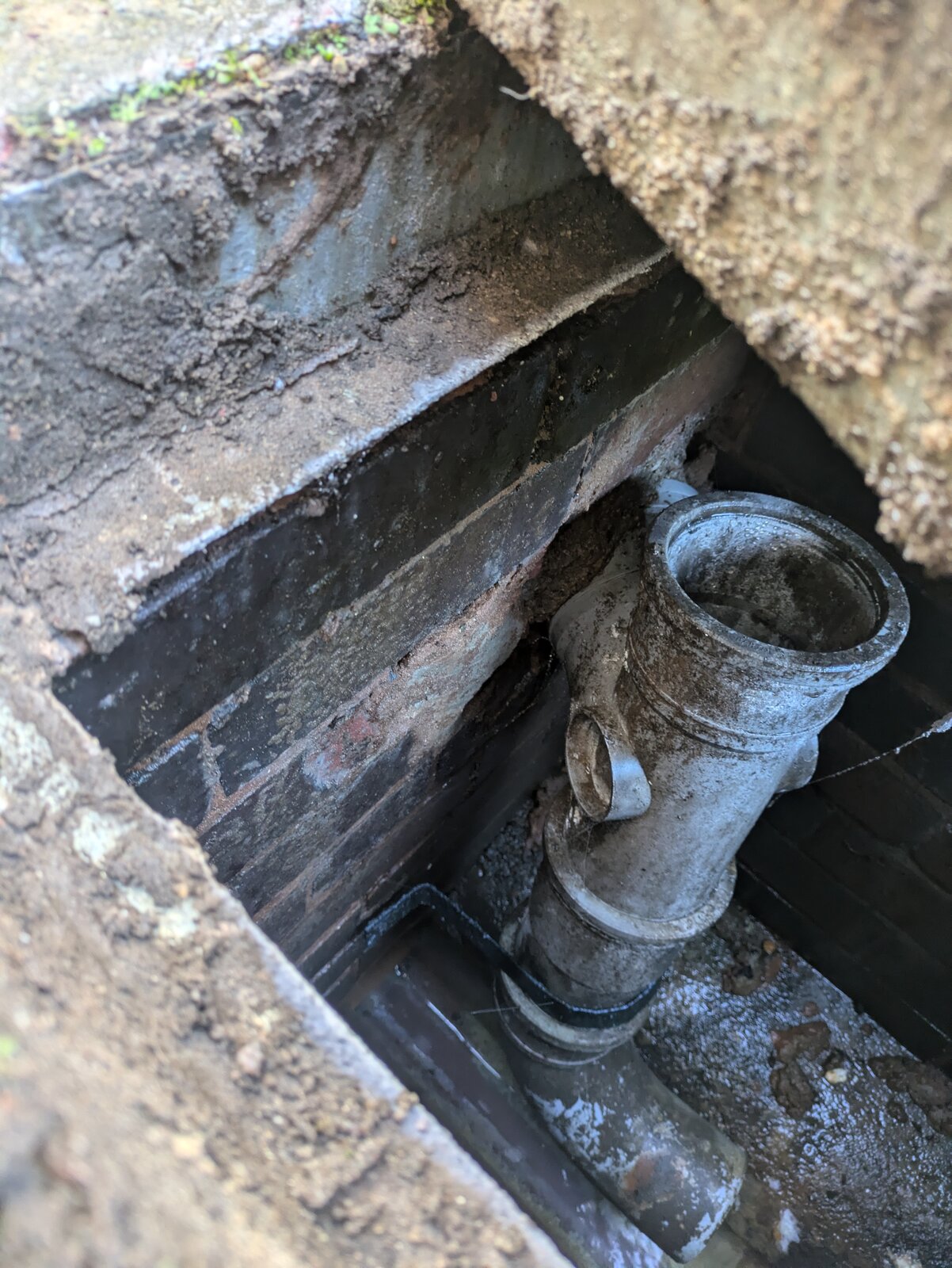

I'll wait for @Hugh Jaleak to comment on that, tho I know what I think of it and I'm sure that can't be correct. Especially if the primary channel/drain is active but I'm certainly not as experienced as he is at drain/chamber works and what would be considered acceptable (or not).
How far above the main channel is the outflow of that plastic soil pipe, can't quite see in the pics.
Thanks Rob.
Internal Backdrops are permissible, but that setup is far from ideal, looks rather like cheap bodge up, as the original installer couldn't be bothered to do too much digging and fit it properly.
Given it's dropping in dead in line with the existing drain, I have to wonder where that pipe is going. Thoughts are, you could dig down adjacent to the building where the stack drops, find the sewer, and look at connecting the existing stack in there, which could also provide options for connection of the proposed new WC.

so have found out that this manhole services the property to my left and 2 properties to my right so they all join in.

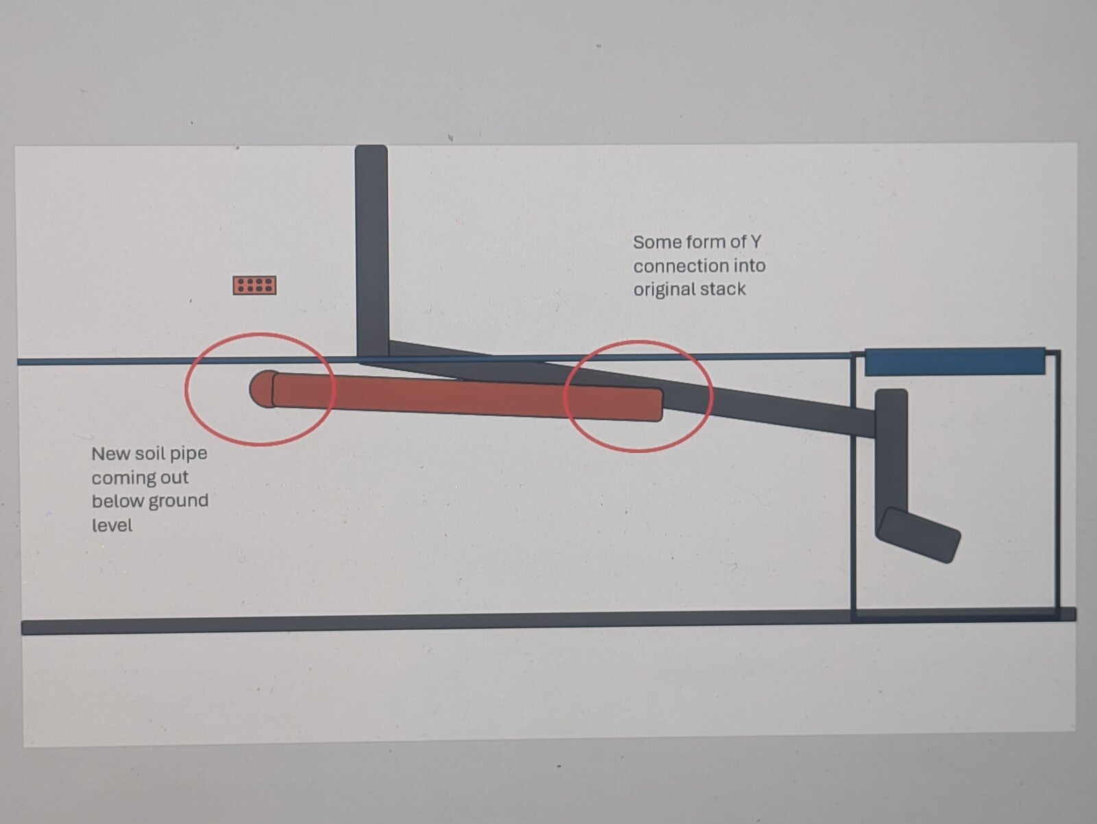

could I just dig a channel internally and lay the soil pipe at a fall of 1 in 80 and come out of the wall and cap off and then do all the digging around Feb to connect to the drain?
Then you will need the Water Co's permission to do anything with it as it's their asset.
You could, 1:40 fall is advised, external details would need to be agreed with Building Control and/or Water Co.
would I only need the water Co permissions if I change anything within the chamber?
or would I still need permissions if I chopped into the stack underground between the bend and chamber
If working on something that only serves your property, no. Soon as it's shared with another property, it's the Water Co's responsibility.

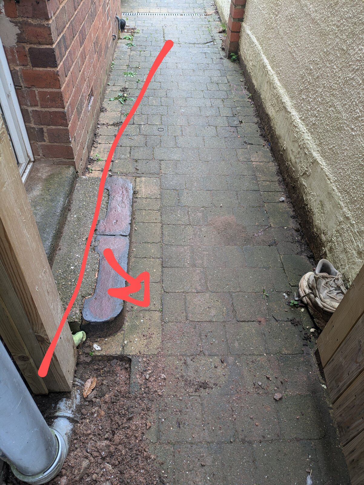

Going to try and achieve something like this
