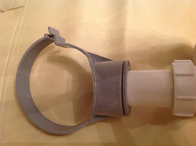

Soil Strap Boss wont solvent weld!
31 Aug 2013
10
Cambridgeshire
I recently added a new Soil Strap Boss to my soil stack and am having a nightmare getting the darn solvent weld to bind! I've built lots of fittings over the weekend with the cement and its worked a dream, but for some reason it just wont work on the Boss. The surface gets a bit gooey but it doesn't really stick. I tried redoing it last night but the same problem it just wont stick.

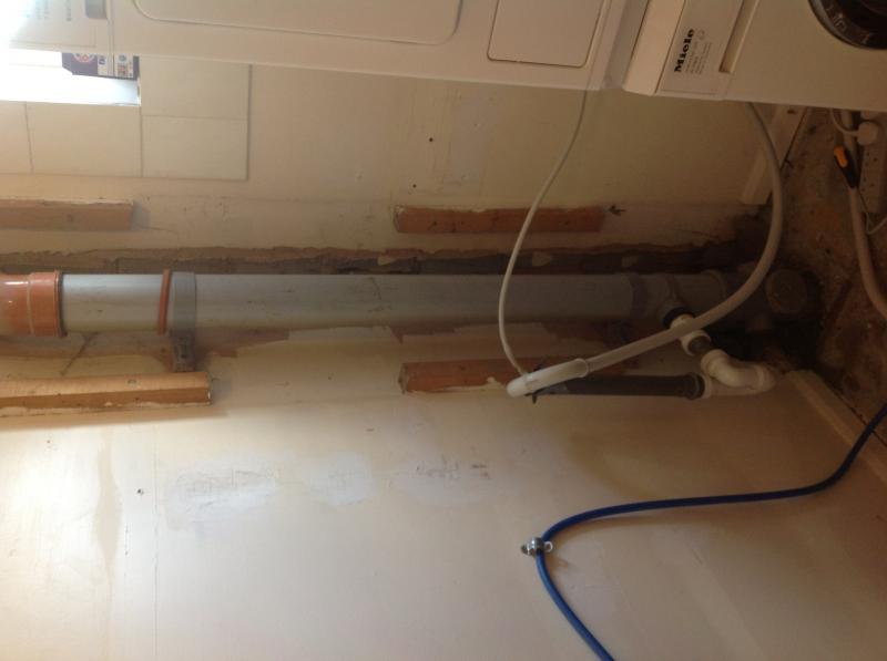

Where did you get the Strap Boss from? (Manufacturer and part number?) Assuming it is the same stack as per your picture in the other thread, then I see no reason why it wont stick unless the strap boss is the wrong type of plastic!
I got it from the local plumbers merchant and had no trouble solvent welding the 40mm adapter into it. I'm going to pop in tomorrow morning and get some primer to see if that helps
Boss is here:
And yes it's the same pipe as the old photo
Thought I'd create a new thread as its technically a different problem!
Odd, there is no reason I can see why that shouldn't fuse. :? I would give the mating faces on the boss and pipe a going over with some sandpaper to roughen them up a bit before making another attempt. Not had this problem so unsure as to how well the plastic will fuse if there is already dried residue from the previous attempt. Gap filling cement will seal a slight weep, but the damn thing needs to be stuck firmly in the first place, especially on an internal stack!
Try cleaning it with solvent weld pipe cleaner (or steel wool as said) dirt will stop the glue working.
Really? It is pretty filthy! That might explain it as everything else I've welded has been brand new!
Sandpaper looks like its done the trick. I think there was a lump on the fitting that was stopping the two surfaces coming together cleanly
