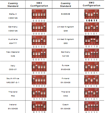

I look at the set-up on mine 1755003962844.png and how the dip switches are set for the region, but the dongle,
I would guess, would just swap old to new? But to allow anyone to configure the inverter is asking for problems, and I would have thought Solar Edge would have a list of installers who have completed their training course. And it will not be left to chance.
