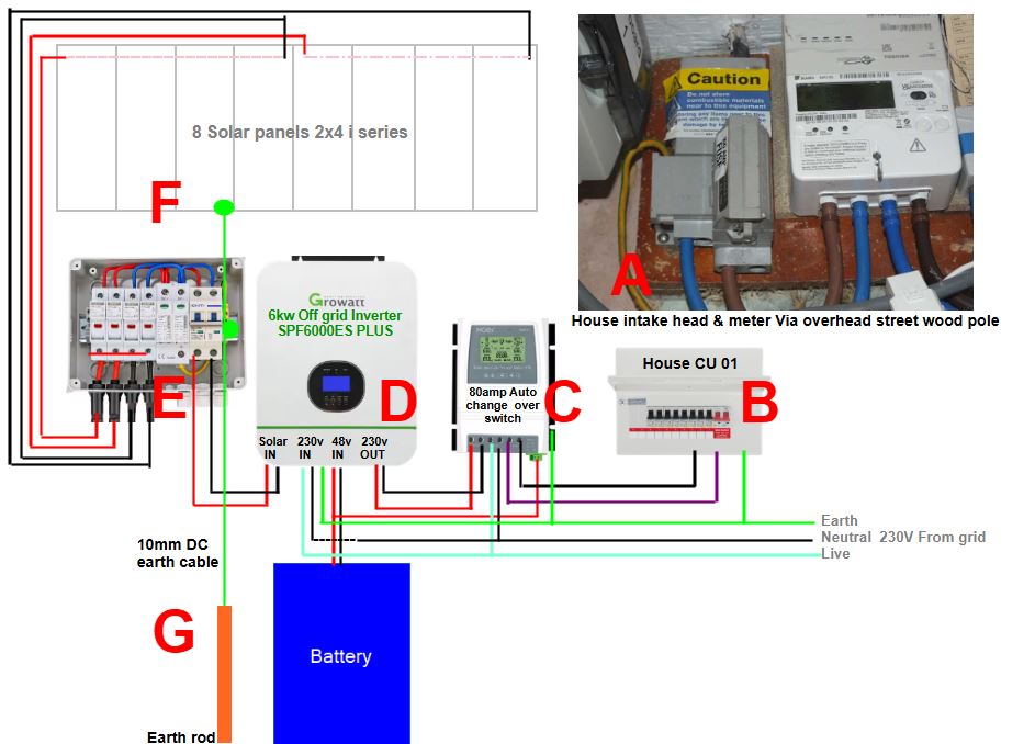

Hi, i am at the planning stage of a solar panel system & getting a lot of contradiction on earthing. The drawing is the plan & i would say earth ABCD earth off the incoming main as all will have 230'ish volts. But not sure on EFG & weather G is needed if connected to the main intake.
I am even more interested as i was chatting to next door with solar panels & his son got a shock whilst cleaning them. So, any help with EFG would be appreciated. Plus it would be nice to avoid possible ground loops & lightning problems. Thanks

I assume the changeover switch is to provide an EPS in the event of a power cut?
In which case your inverter and subsequently any circuits protected need to have an independent (rod) earth as you can’t rely on the DNO earth if there is a power cut.

In the main, the inverter does the change over, it is not the earth which is the problem, an earth rod can be simply added, it is the neutral which is the problem, when in Grid mode the neutral is not connected to earth, but in island mode it is, and the inverter to comply with G99 or G98 has to be configured depending on which, even as an electrical engineer, I did not install my own solar, there are a load of hoops to jump through.

The point I was making, is at some point, be it at the transformer, or in the cable with TN-C-S or at the generator for the safety system to work, the neutral needs to be made into a neutral by linking it to earth, otherwise we are running an IT system, and our protective system use with a TN or TN system will not work.
With my solar panels, the inverter does this, and when the grid supply is lost, neutral is connected to earth, but this must not be the case when we have a grid supply, and not all countries have the same rules, and so there is a row of dip switches that need setting for the country it is used in, and with the UK there are two settings one for G99 the other for G98 and since I did not do the installation, I have no reason to even look at the switches. I just know they are there.

The change over switch
That switch is pointless and will cause problems.
The inverter already has built in switching between mains/solar and can also power the loads using both at the same time.
If you install that clunk-o-matic changeover thing, then you won't be able to use excess solar to power loads during the day when the battery is full or when solar power exceeds what charge power the battery requires, and every time you change to the battery only and back to the grid there will be a break in the supply which will mean internet router, oven clocks and the like will need to be reset. if you intend to actually use the battery to power things at night, then you will have to switch the 'auto' thing manually every time.
A more sensible solution:
sling the changeover switch away
connect the consumer unit to the inverter directly
mains input to the inverter must be through a suitable protective device, it can't be connected directly to the mains supply
incoming supply will require T1 surge protection if it hasn't already got that.
don't bother with any DNO supplied earth connection, make the whole lot TT all the time, you will need earth electrode(s) installing for that if you don't already have these.
all of this assumes you have sized the PV, battery and inverter appropriately for the loads in the building.
That inverter has 2 separate PV inputs, so it's also pointless to combine them into one before the inverter.

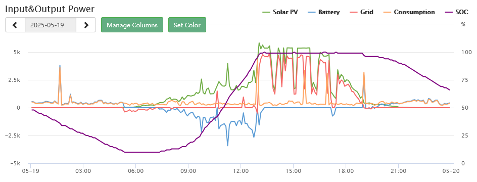

The problem is, you want the state of charge to be low enough to take the solar output. Typical curves with no off-peak.

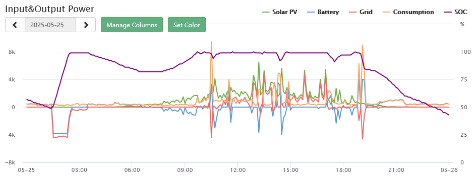

And typical curve with off-peak.
On the first one from around 5:30 am to 8 am, I was using grid supply, in the second the grid supply was 1 am to around 3:30 am off-peak, but the state of charge did not drop below 82% so the solar was exported rather than being used to charge battery.

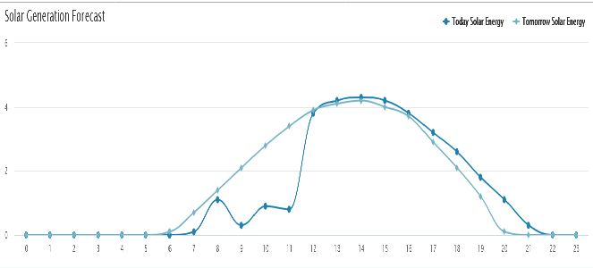

I do get a forecast, ⁣but1751875403109.png not that accurate, and the software does not allow me to set how much it charges the battery, I can set how fast, and for how long, but when I went from 3.2 kWh to 6.4 kWh battery size, it did allow solar to charge it at 4 kW instead of 2 kW, and it to discharge at 5 kW instead of 3 kW, and it lasted until off-peak started, which is what I wanted, but it also resulted in the battery still being charged when solar started, which is OK if being paid for export, but not when not being paid for export.

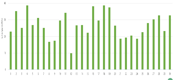

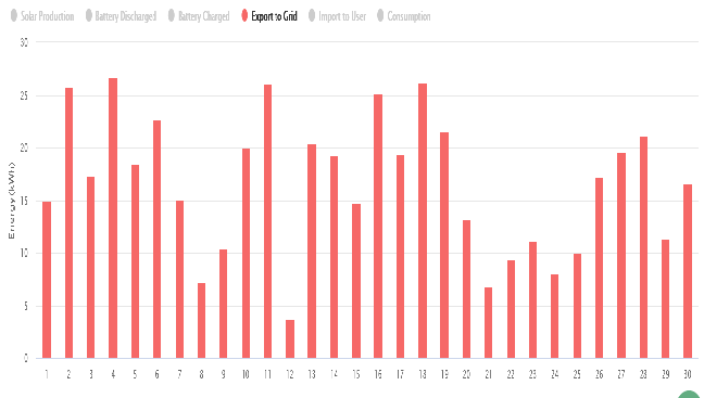

Last months' production, to set how much to charge overnight to match that, is almost impossible. Export to grid
for same month, 12th was very low 3.7 kWh but the 4th was 26.7 kWh total for month 499.4 kWh exported at 15p/kWh = £74.91 why would one not want to get paid for export?
