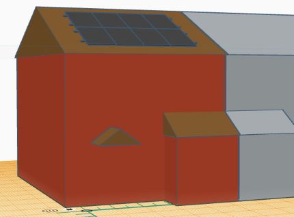

Scale mock-up (based on 340w 1m * 1.68m panels and renusol fastenings):

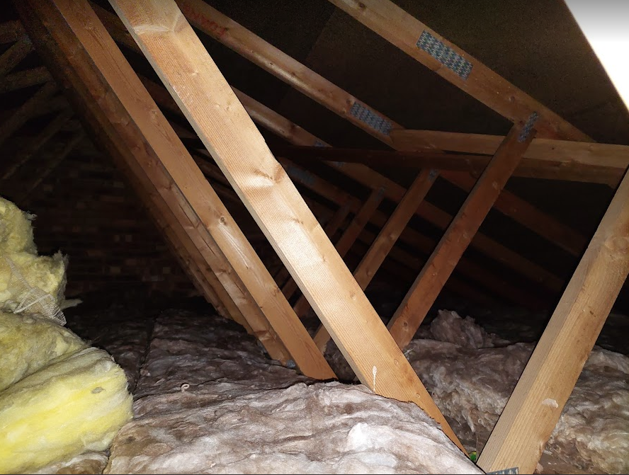

Your better off asking a truss manufacturer who can tell you for free, or seeing if there is a label somewhere on those trusses that shows the load capacity
Thanks for the suggestion, good idea- I'll take a look for label tomorrow.
This is partly about having "something" to show insurer, building control, future buyers (if I sell the house) etc that the matter has been properly assessed. If there's a clear label or indication that 0.785kN/m^2 (standard trussed roof design load according to the MCS doc) then it's fine. If there's any doubt though I'll probably keep chasing an engineer.
I have a hunch some MCS installers just whack panels up thinking "it'll be fine... at least till I get paid". The LABC guidance suggest 15% additional dead load as being the threshold at which a competent person to assess. Combinations like Redland Renown at 50kg/m^2 with 11.5kg/m^2 of panels (i.e. +23%) is surely very common. Yet, I don't see a lot of MCS installers claiming to part of a CPS for assessing it and also there aren't a lot of structural engineers who specifically advertise it. Anyway sorry for the tangent!

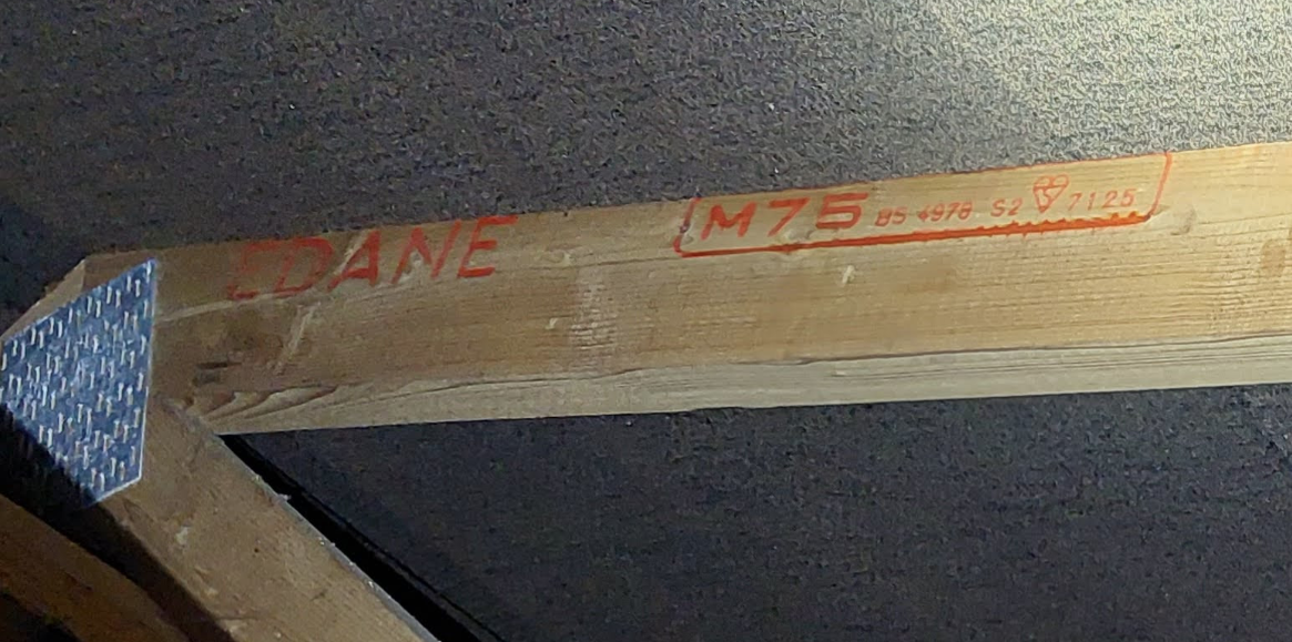

I couldn't find a label- only for the timber itself ("EDANE M75 BS 4978 S2").

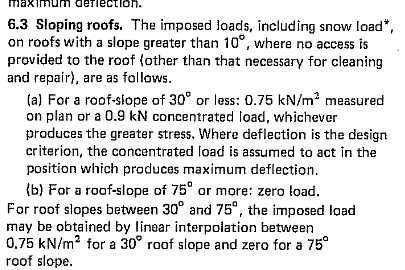

With more Googling I found a copy of the 1984 BS 6399, which should have been in force when my house was built. It already has the 0.75kN/m^2 imposed load specified for 10-30 degree roofs. The snow load here (also West Mids :)) is 0.47 kN/m2. So, I think the panels are really no problem. Perhaps no structural engineers are responding because of that.
