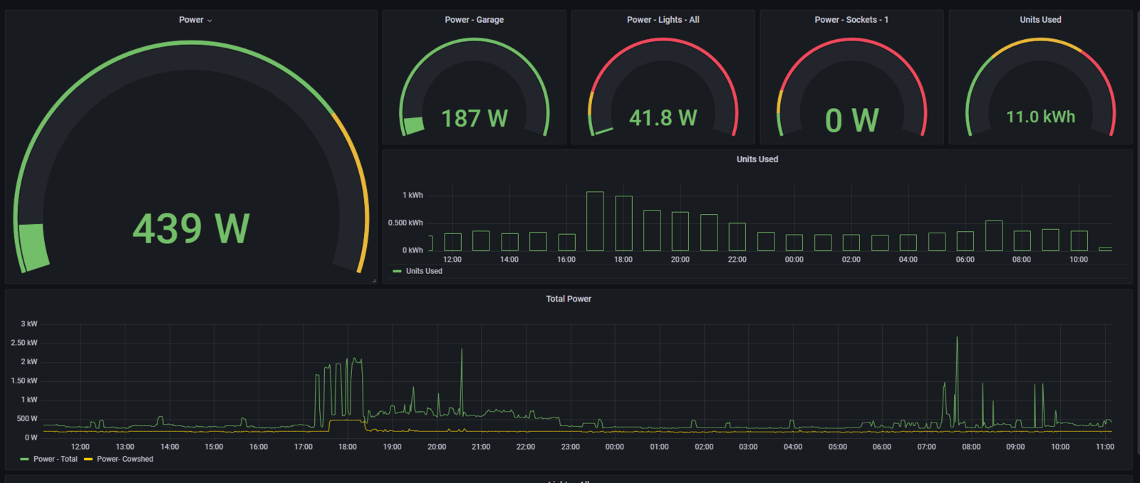

You main consideration should be the ability to recharge the batteries during the day. My house seldom uses lots of power so will focus on battery recharge. Below is over a 24h period.

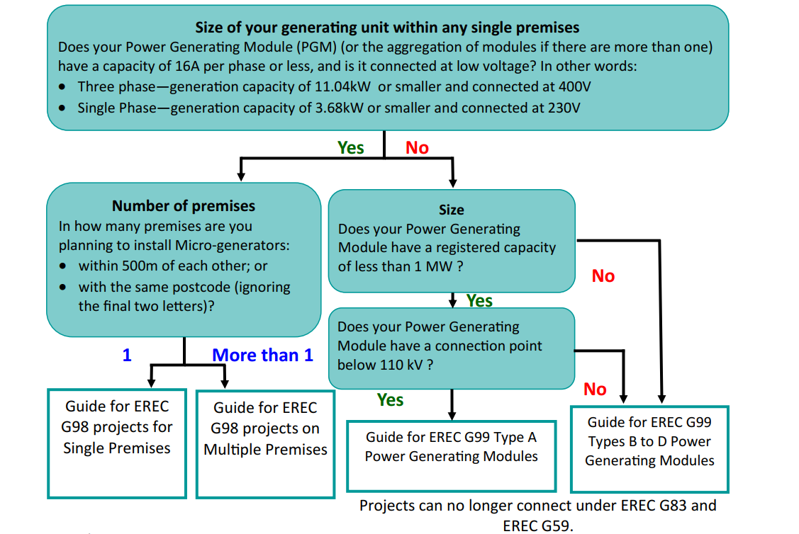

Costs have been hovering around £9500 (inc VAT @ 5%), 12x400w Jinko panels, 5kw inverter & 5.2kw battery, both GiveEnergy. This is with GlowGreen but in all of several conversations he 'forgot' to mention we'd need a G99 from DNO & it's not on his full breakdown. When I asked about it he told us they will get that done, BUT there "might" be a cost of £200. Made me wonder if they weren't going to bother as up until recently we didn't even know that had to be done, he had no answer as to why that "possible" cost wasn't on the quote!

My understanding - while not exactly exhaustive - is that a G9 is if you are going to feed back into the grid.
My system will, by day, charge the batteries, run the house and has it has a sensor on the incomer, try and maintain that at zero - i.e. not feed back into the grid.
I understand then that I would not need that but...I will double check with the installer.
If you have batteries I assume yours would be similar to this and might too not need.
I can see one flaw in my thinking - as it's not a hard disconnect such as a contactor, it could still feed back so it might be that it would be needed.
