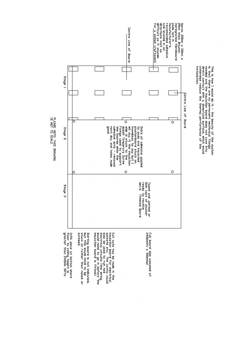

Solution - you may not be agreeable, but I will still make it as a suggestion: stick 25mm bitumen impregnated felt in small sections say 75mm wide by 200 long onto walls at correct spacing and stick insulated plasterboard panels to the felt dabs. Possibly need an insulation thickness of 80mm on 12.5mm plasterboard and skim coat of plaster to finish: this will give you an insulation U value of around 0.25 to 0.3 W/m2C compared to the original U value of 2.1W/m2C for solid walls in normally exposed areas.

Damson in distress!! I have done a sketch for you - on the basis that one picture is worth more than words alone!!
Other people may have other idea's, but the solution means that the insulated panel is not fitted directly to the cold/damp wall which would otherwise affect the performance of the installation.
I have done some calculations, which I thought might interest you. The existing wall has a U value of 2.1W/m2C and looses the equivalent of 114kWh of energy per square metre of wall area. The proposed solution would reduce this energy loss down to a mere 12kWh of energy per square metre of wall area (that is on a cold day where the temperature difference between the outside and inside is 15 degree's C) the wall will than have a revised U value of only 0.22W/m2C (impressive don't you think?)
From a sustainability perspective the saving in energy consumption of 102kW is equivalent to a reduction in CO2 emmissions of 53kg/kWh.
One final note: You could reduce the insulation thickness to 50mm and this would give you a revised consumption of 17kWh/m2 and a U value of 0.31W/m2C.

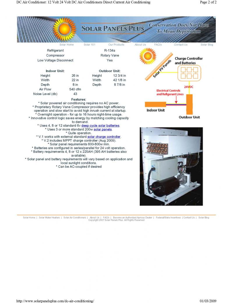

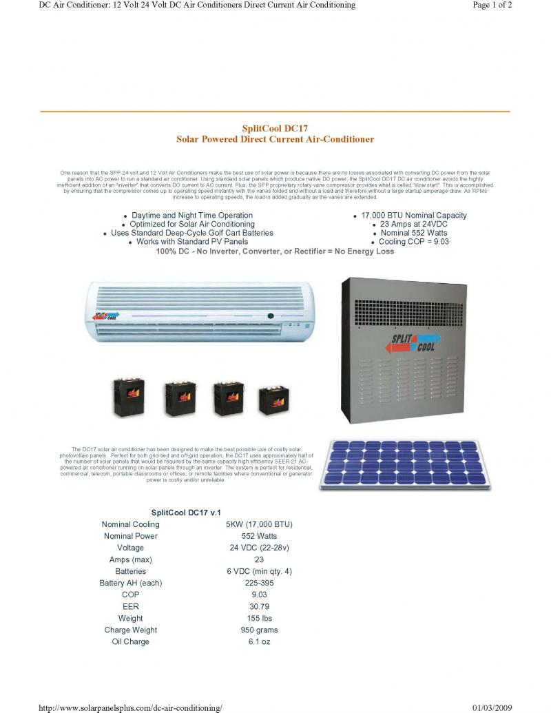

now for the big question - do you know if there's a solar power method that can ran an AC in extreme hot climate - like the middle east Dubai .
being doing some googling and not found much ? :)

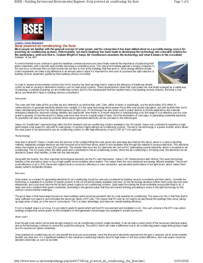

I have carried out a short search on google and have come up with the attached sheets, which may be of interest to you. One is an article by BSEE which gives a useful head's up on the current benefits of PVs. The others two sheets are systems currently available, which may or may not be of interest to you.
Regretfully, net has given codes that don't relate to the titles so I am assuming that the article by BSEE is the middle file!
