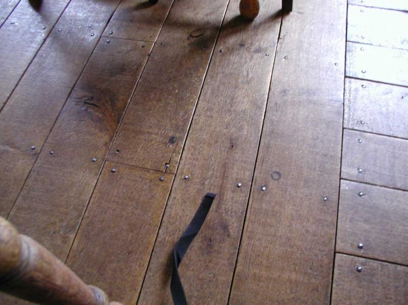

There is a restaurant in Burgess Hill that has had solid oak square edged boards nailed to joists over underfloor heating for so long I can't remember, but over 12 years at least.
I'm considering doing the same as I like the floor very much.
Does anybody have any experience of this type of floor and anybody have any opinions?

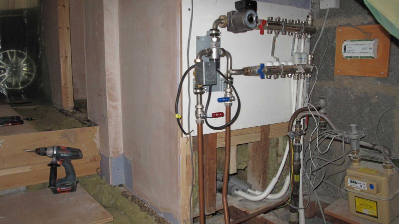

Professional install for the UHF. The fitters are coming this morning.

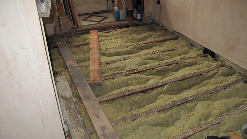

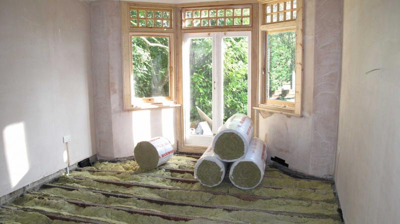

Spec is spreader plates over 100mm Rockwool between joists on nettting. (I've already installed that in conjunction with improved subfloor ventilation. As a matter of interest the subfloor is 150 mm of tarmac. I have a 100 year old house of slightly strange construction.
They have CAD drawings for the install and I've sent them photos of the insulated foorboardless floor. They seem happy enough with the preperation.
I realise the floor will not have the same mass as a concrete floor but there is a lot of mass in the walls and floor, system water etc. combined and the amount of heat needed is not great from the amount heating I have in the other rooms. I have a weather compensated Vaillant boiler and the flow temperature with an outside temperature of 7 C is 35 C with the rest of the system.

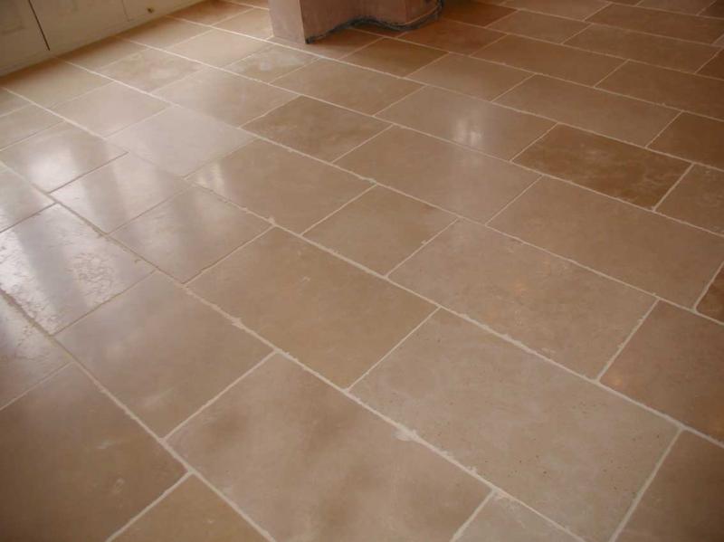

I've uploaded some photos of the floor in the resturant and of my prepared floor.

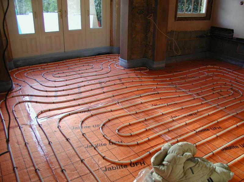

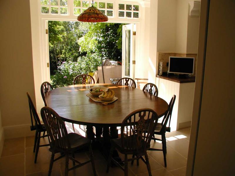

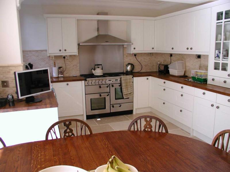

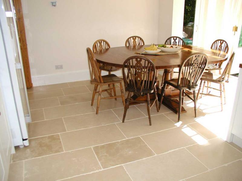

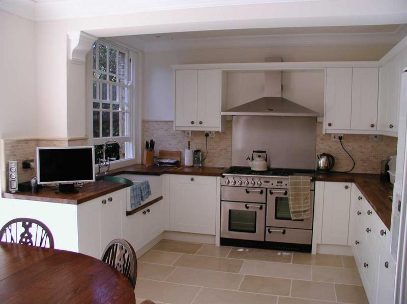

In the kitchen I removed the suspended floor and filled the void with insulation and cast a reinforced concrete slab on top with the underfloor installed under the screed on underfloor heating insulation. To do that in the rest of the house would have been a very difficult and expensive option because of all the gas pipes. primary heating pipes and electrical and network cables.
