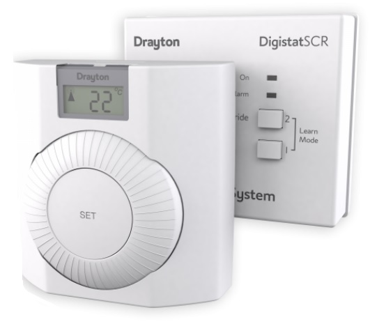

The red 'Receive/Alarm' light on the SCR flashes periodically for around 5 seconds every five minutes or so (which means that the Digistat and SCR are communicating) and the green light is 'on'. This means that we should be getting heat.
However, the zone valve doesn't actuate, the boiler doesn't fire and the radiators remain cold.
If I then turn the digistat DOWN to below ambient (e.g. to 10C) then back up to 24C, the valve will actuate, the bolier fires and we have heat.
Is this simple to fix?
Is there a procedure for 'resetting' the SCR (WR1) unit (e.g. power off/power on).
Does the Digistat need re-pairing with the SCR unit? (seems unlikely as when you turn the stat down to 10C and then back up to 24C, the green light goes off and then back on again.
From what I've managed to find on-line it suggests that there is a problem with the SCR unit (either not sending the signal to the boiler or some other issue). Is the SCR easy to replace (I've know that Toolstation (98517) and Screwfix (73146) have these for between £80 - 110). I'm competent at electrics (just not Part P qualified) so is this something that I could replace myself or do I have to call out our heating engineer?

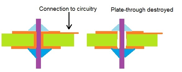

Those holes in the PCB should be cleared of solder with a de soldering sucker before putting the leads of the new capacitor through them.
There is every chance that the plated-through connection from the under side of PCB to top side will have been damaged or destroyed.
Without the plated-through connection the reliability of the joint cannot be guaranteed.
When the plated-through connection is intact the dark blue solder is connected to the top side of the PCB
When the plated-through connection is not intact the only connection is through the light blue solder on the top side of the PCB.

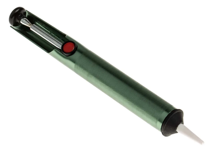

Thanks Bernard.
Aware of this but thanks anyway.
I have a solder sucker (I really need to get out more and meet people).

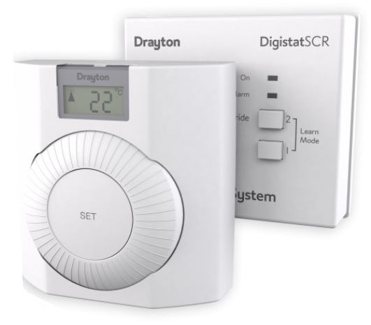

The replacement capacitor arrived this morning.
Turned mains supply off (& verified), removed WR1 (SCR) unit from the wall managed to prise the clips holding it together apart (without breaking any) de-soldered the old cap and re-soldered the new.
Re clipped everything back together, put WR1 back on the wall and set programmer and thermostat to call for heat.
Minor problem - WR1 (SCR) had a solid red light (indicating it wasn't receiving data from the thermostat), so removed batteries from Digitstat, counted to 30, put batteries back in and yay, we have heat.
Adjusted programmer & thermostat so that there was no heat demend, changed programmer time to come on in 5 minutes, turned Digistat up to 23C and waited.
At appropriate time, valve opened with a click and boiler fired up.
One Happy Bunny (especially since a new Digistat+ RF / SCR would be somewhere in the region of £80-110 and this cost me the grand total of £4.45 plus around 10 mins of time).
