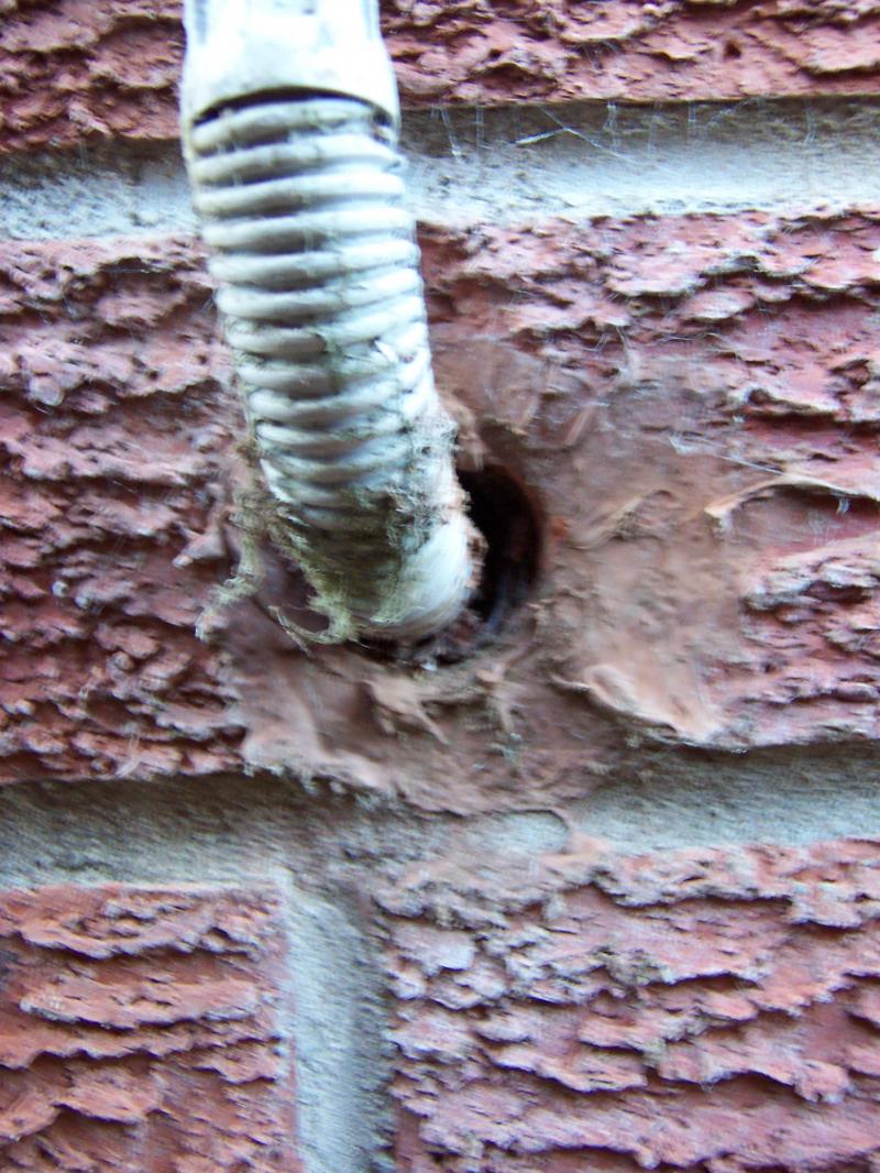

This is the water pipe connection to outside tap.
This is just below the outside tap.

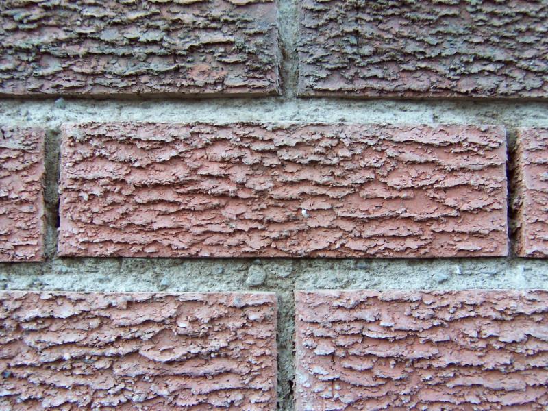

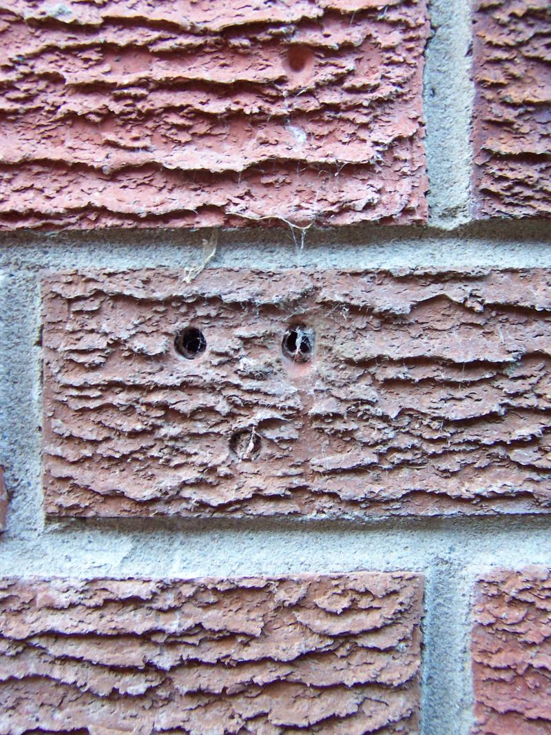

Walking round the house found these in one area:
picture 1
picture 2
picture 3

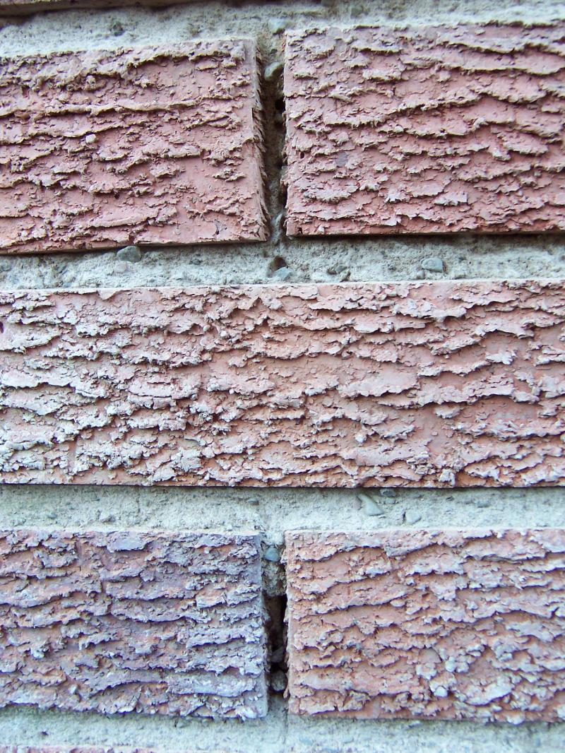

Any finally, what is this?

From what i have seen, it is largely a case of lazy tradesmen though not the end of the world.
The perp's look as though they have been laid quite tight, couple this with the fact that piecework brickies tend to overlook the more stringent methods of filling the perp's and you will end up with poorly filled perp's.
Not unusual but annoying.
The drill holes in the brick could be filled with mortar or brown silicone.
The exit hole left by the outside tab just needs tidying up - as above really. I personally don't like the method they have used to pipe the water to the tap but ho hum.

No. The gaps in the bricks (perpendicular joints or 'perp's') will look better pointed with a similar mortar to existing and struck with a jointer.
The reason i say use silicon for the other situations is for its ease of use and that the eye will be distracted from looking for a mortared joint because of the presence of the tap or by the fact that the holes are in the brick and not the mortar joint.
