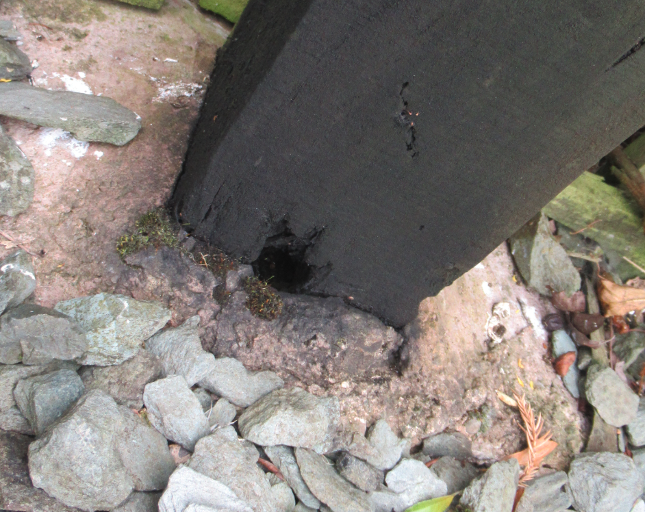

So many variables it is difficult to guess - I have a line of 10 posts in one part of our garden all set in concrtete 24 years ago, 3 have rotted quite quite badly, the others seem perfect.
I noticed the rot in these posts maybe 5 years ago, and I poured a lot of old engine oil in - they have not deteriorated since.
It is amazing how far the oil has worked up the post (rising damp)

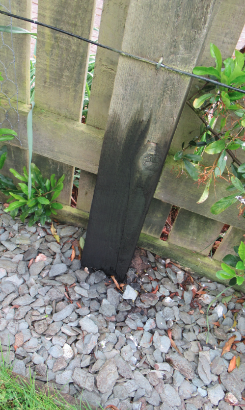

Never had a post treated with engine oil fail. I mix it 50/50 with kerosine and paint it onto the lower half of new posts.
I know a farmer has posts he is going to use stood in a 45 gallon drum of a mixture like that, lets them soak in it for weeks beofre knocking them in - they don't rot - the oily nature of themm makes them easier to knock in too
What a mess though
Used engine oil is a fairly toxic unpleasant chemical, it will kill any life around it,
as for the one's I did above, I drilled a hole down, fitted a pipe and then set up a drip allowing the oil to slowly soak in. that could have been 5 years back and they don't seem to have got any worse - and the plants either side didn't die.
