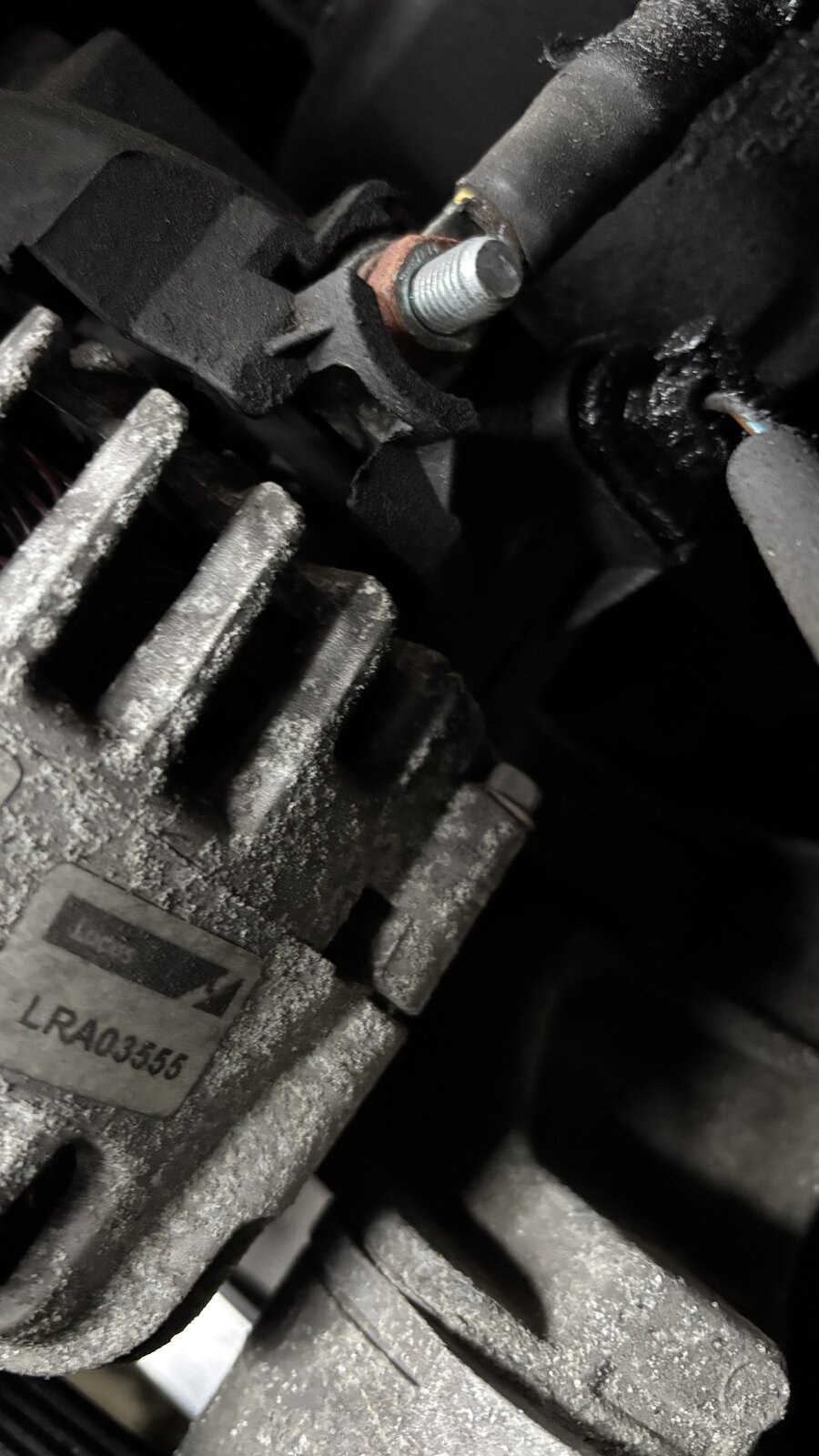

I've a 2013 Ford Galaxy with a 2.0 TDCi engine. For some time been having slight electrical issues; soon after shutting off the engine (but keeping radio on for example) see a "Low Battery" message on the dash. Occasionally a red battery light appears while driving (and I believe this is "smart alternator is operating in dumb mode"?)
If I check the battery with a multimeter I might find it less than 12v even after a run, and a couple of times recently I've read sub 12v with the engine running (but then when i checked again after 5 minutes drive it was reading 13.5v)
Other odd symptoms, the power steering jerking and being difficult to turn the wheel (kicking back against the turning effort) - I think this is something to do with low battery voltage as it appears to be an electric PS pump, and one time when it was doing it at night the headlights were flickering in line with the steering jerking
Also, a strange whirring/purring/soft whining sound that changes in line with engine revs - if the car had had a mechanical PS pump I'd have said the fluid was low, but it's not quite a sharp a sound as that, it's a bit softer and is present all the time, even when the steering isn't being used. Fluid level in the ps bottle is ok
There's hot/burning kind of smell, not as sharp/acrid as a cooking clutch, in the general engine bay area
At the moment I'm thinking to swap the alternator and see if anything changes, but the thing I was curious about is that the multi plug going to the alternator only seems to have one wire, and I thought Ford smart systems had 3?

I can see the bolt on wire and a plug that's big enough to be a multi plug but that wire visible in the photo is the only wire coming out of the plug.. I thought there were 3 and two of them were some PWM control signals for alternator output..

I had similar issues to yours but on a Zafira. The alternator had 4 wires, two of them were the charging for the battery and the other 2 (control wires) came from the ECM. I checked the control wires with my scope and i saw the computer was commanding the alternator so i replaced the alternator and the problem went away.
You only got one wire though. I'm thinking it could be LIN from the ECM. Have you carried out voltage drop tests from the alternator to the battery?
To answer the original question, it seems this particular alternator/charging system on this TDCi engine genuinely should only have the large wire that goes to the battery and the small wire that seems to carry some kind of PWM AC signal, according to the scope I bought to check it
I've replaced the alternator and since got a sensible 14+ volts at the battery, the whirring/purring sound has also disappeared..

The alternator in mine had 4 mounting points
The two on the belt side are really long bolts with a 16mm head
The two on the other side were a cone shaped bolt in an expanding collar (top) and a thick collar held against the engine block with a metal P shaped finger (bottom). Use of a mirror on a stick and maybe a head torch will help considerably in finding the Allen bolt holding the finger
I found I could just loosen the top bolt a little, and loosen the #4 Allen bolt holding the finger, remove completely the long bolts on the belt side, and then the alternator would wiggle and slide sideways towards the belt side, turn 45 degrees then lift out
When refitting the replacement alternator I noticed the fairly thick outer sheath on the small wire had chafed the insulation on the wire so i squeezed a bit of silicone down the sheath to stop it being able to carry on chafing, and i also cable tied the sheath to the alternator to limit vibrations on the chafed section
