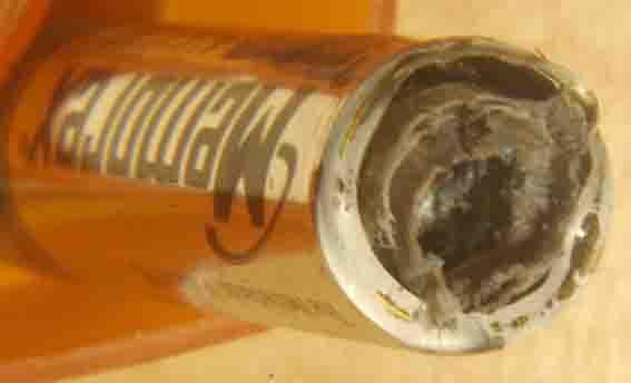

Batteries can explode and when they do it leaves loads of nasty stuff behind as I found to my cost. This was not a rechargeable battery and it was not in the charger when it went bang. It looked similar to some rechargeable ones and a couple of days earlier it may have ended up in charger by mistake.
Point to remember there was a good time between mistake and going bang well over 24 hours.
