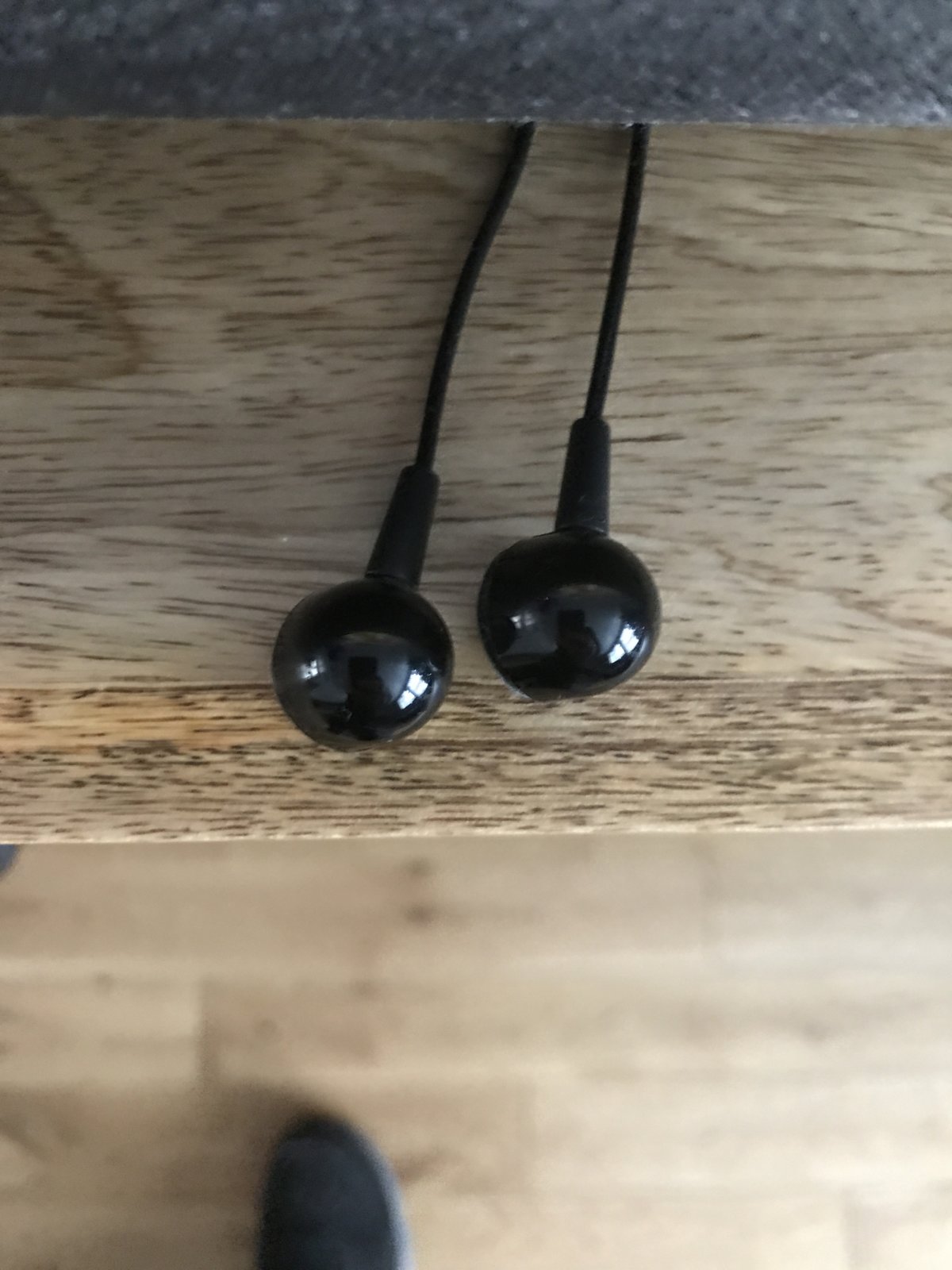

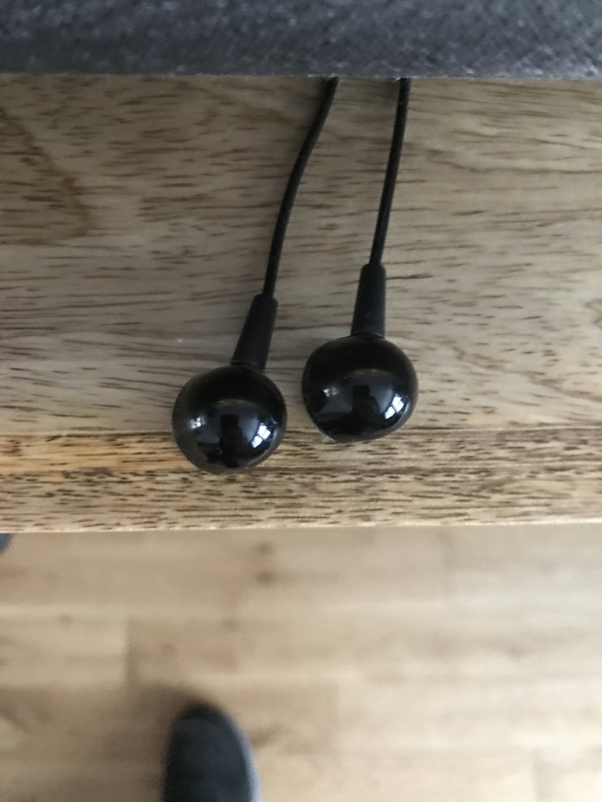

These are either IR emitters or IR Receivers. They are used for controlling gear that's out of line-of-sight to the infra red remote. One example would be when there's a sound bar blocking the TV IR receiver. Another is where a source box such as a Sky satellite receiver is in a cupboard. Have a look at your manual.
