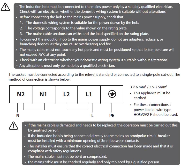

1. Induction Hob - Logik LINDHOB10:
Total power: 6.4-7.2kW
Cable type / section: H05V2V2-F 3x6mm2 / 3x2.5mm2
From the instruction manual:
Why the N1/N2 and L1/L2? European compatibility?

1. Obviously I don't want to invalidate the warranties by not using the manufacturer specified heat-resistant flex, but how do you safely drop from 10mm2 to the sizes mentioned? Through Cooker Connection Plates? Do these need fusing (ie FCU)?
2. Can both these appliances be safely connected to the single 45A Cooker Switch? What size 2+E to run from the Cooker Switch to the Connection Plates and/or directly to the appliances?
You change the MCB to 32A and use 4mm² cable for the oven.
Actually 4mm² would be satisfactory for the hob as well.

A pair of 4mm2 cables from the cooker switch to the hob and oven respectively are okay even though the switch is supplied by 10mm2?
Yes, but from the connector under the worktop - not the switch.
4mm² butyl flex is good for 35A.
