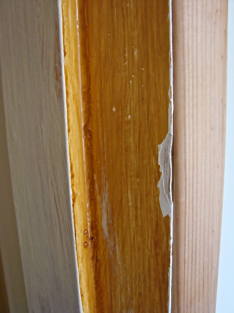

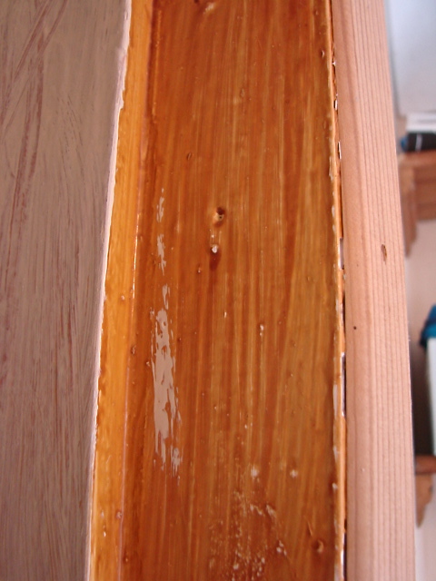

Part of our bungalow inside is wood clad, stained and clear varnished. The door frames are 'painted' in what I can only describe as a 'varnish paint'. It is a streaky, stained look but not a wood stain with clear varnish topcoat. It chips off to show wood primer underneath. I cannot strip it (too much + curved mouldings) so need to recover in a similar streaky type paint/varnish.
I tried a google but the word 'varnish' gets in the way !
Does anyone know what this paint might be or what it is called so I can get some ?
Cheers
Brian.

show us some photos.
It's possible to get marbled paint and spotted paint, but not striped paint.
This is a flat door frame, others are rounded and same effect but darker.
It does look a bit like Graining but it could also be a coat of stain sloshed onto the already painted casing and then varnished on top !
