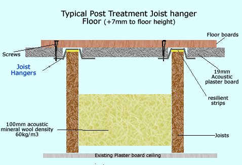

I just moved into my new flat which is on the first floor of a house that consists of 2 floors, myself upstairs and neighbors downstairs.
I am currently carrying out some work on it and i looking to sand the original floorboards and use that as flooring.
I noticed that there is no insulation between me and them, just a plaster board ceiling..... i can hear when there kettle has boiled.
So i thought i should tackle the problem whilst im doing work on the place, i have pulled up the old floorboards and fitted 100mm thick sound proof Rockwool between all the joists.
After putting down the first layer of Rockwool i have noticed i could fit a second layer between the joists.
My question is....
Do you think that would be overkill or is one layer enough?
Im not looking for dead silence, but i defiantly dont want to be hearing their morning bathroom activities whilst im trying to enjoy my breakfast :).
Thanks in advance!
Im not looking to use carpet i would like to use the old floor boards.

The more sound insulation you can fit will help.

Used this system in London conversion where there was no sound insulation.Worked very well.
https://www.soundstop.co.uk/soundproofing/soundproofing-floors/sif1-joist-hanger-solution3.php
