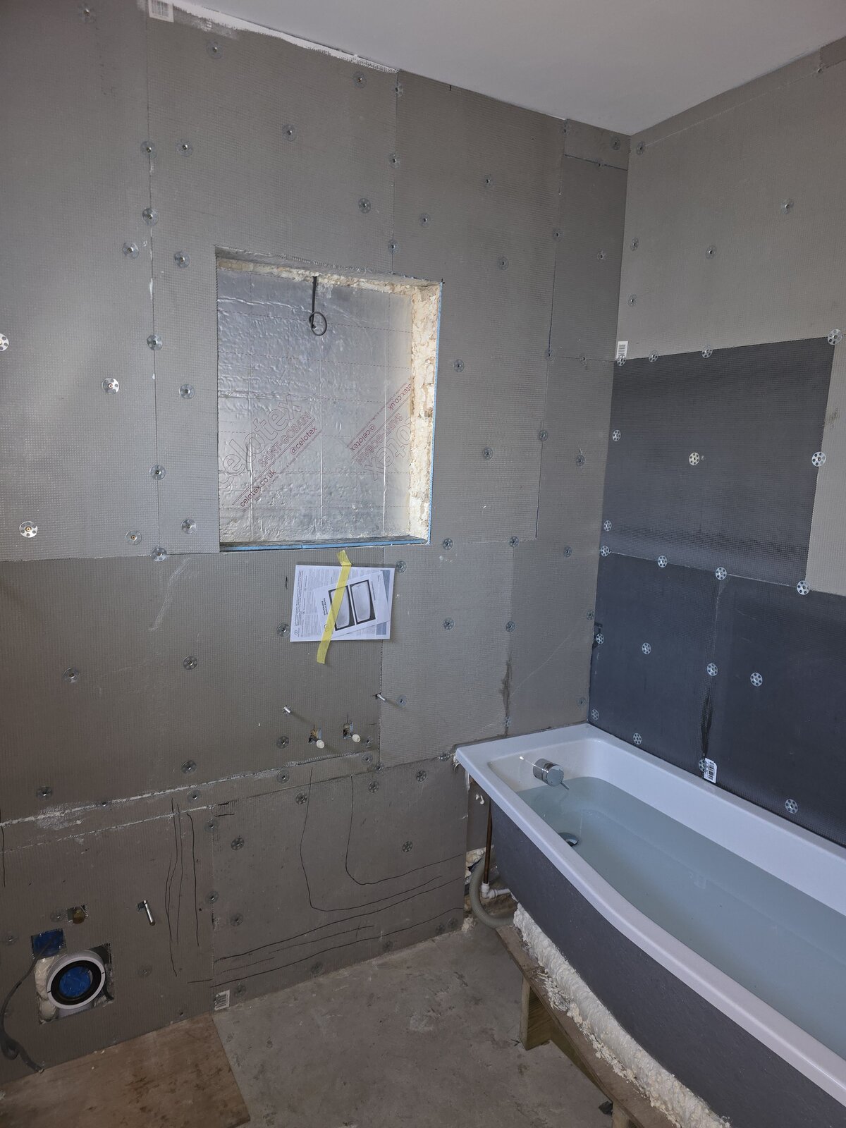

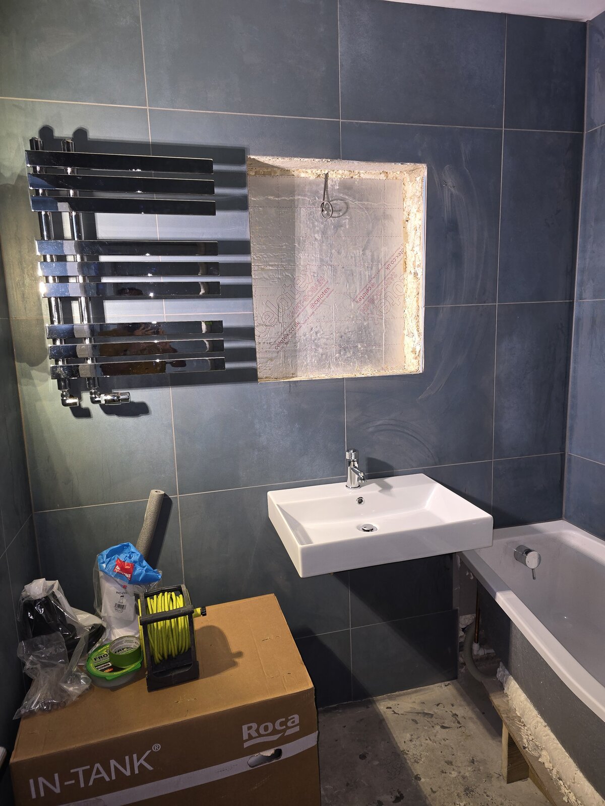

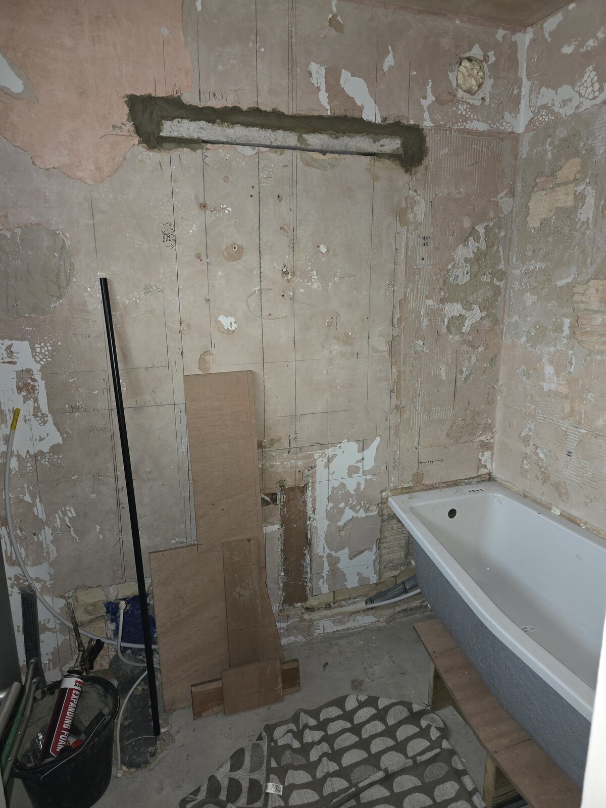

Cladded the window wall with Prowarm boards and will do the other external wall to the right, once the pipework is in.
I'm hoping this will be effective as an instalation.
These houses can suffer from mold and condensation. Just need to work out on the best way for a warm floor without UFH.
It's slow due to my work, but it's moving.
Frame has started for bath.
Lintel is in place for recessed mirror cabinet.
It's slow but sometimes life gets into the way.
Tiles should have been today. Next week now.

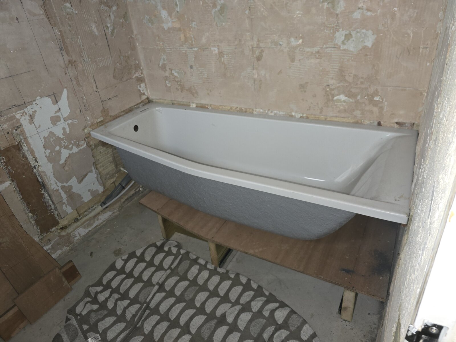

Why the foam under the bath. i can see you have lifted the bath up on a plinth for some reason so you now need a set of steps to get in and out whilst wet and slippery. i assume that the bath is using its own legs on the raised plinth but i would worry that the foam stuck to the plinth and the bath is going to stop the bath from expanding and contracting as it would normally and maybe crack or split somwhere
The bath is higher. Not by much.
Learn by mistakes. I have pond project for the summer. This is the second bath.
The foam will settle. It had 3 heavy tool boxes in the bath is on supports around the sides.
Now it's boarded we have seal the sides.

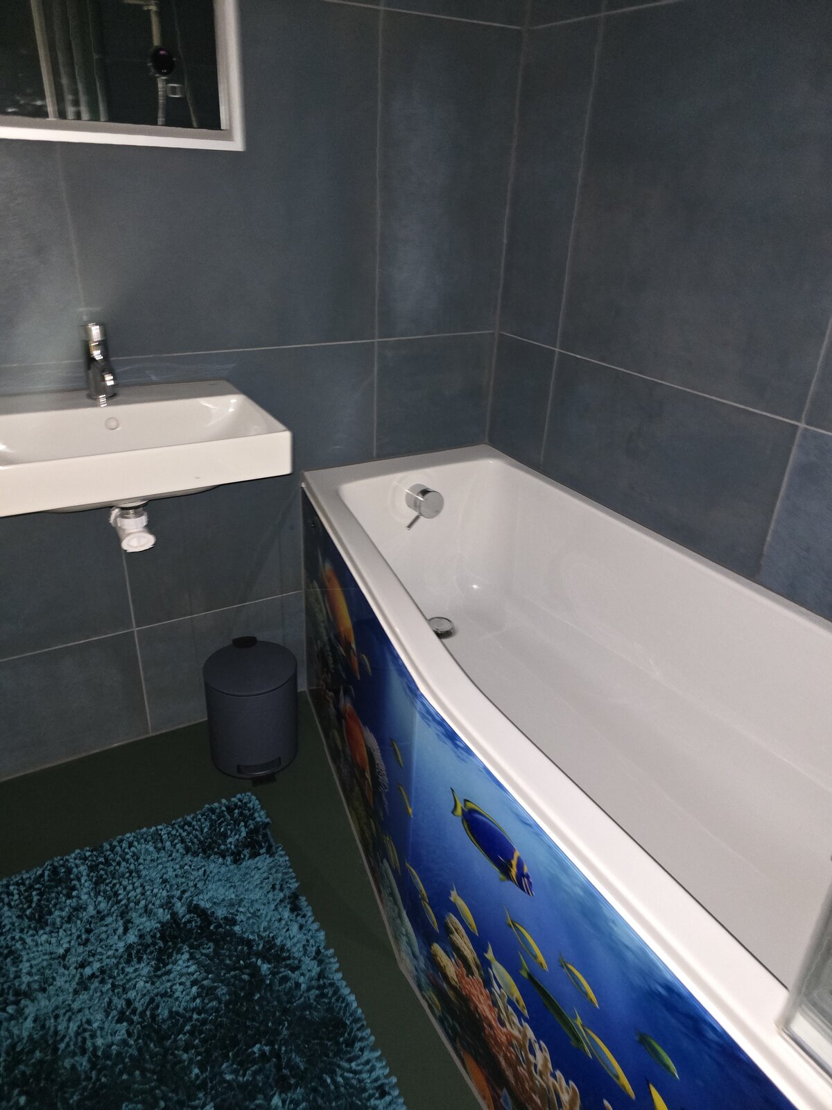

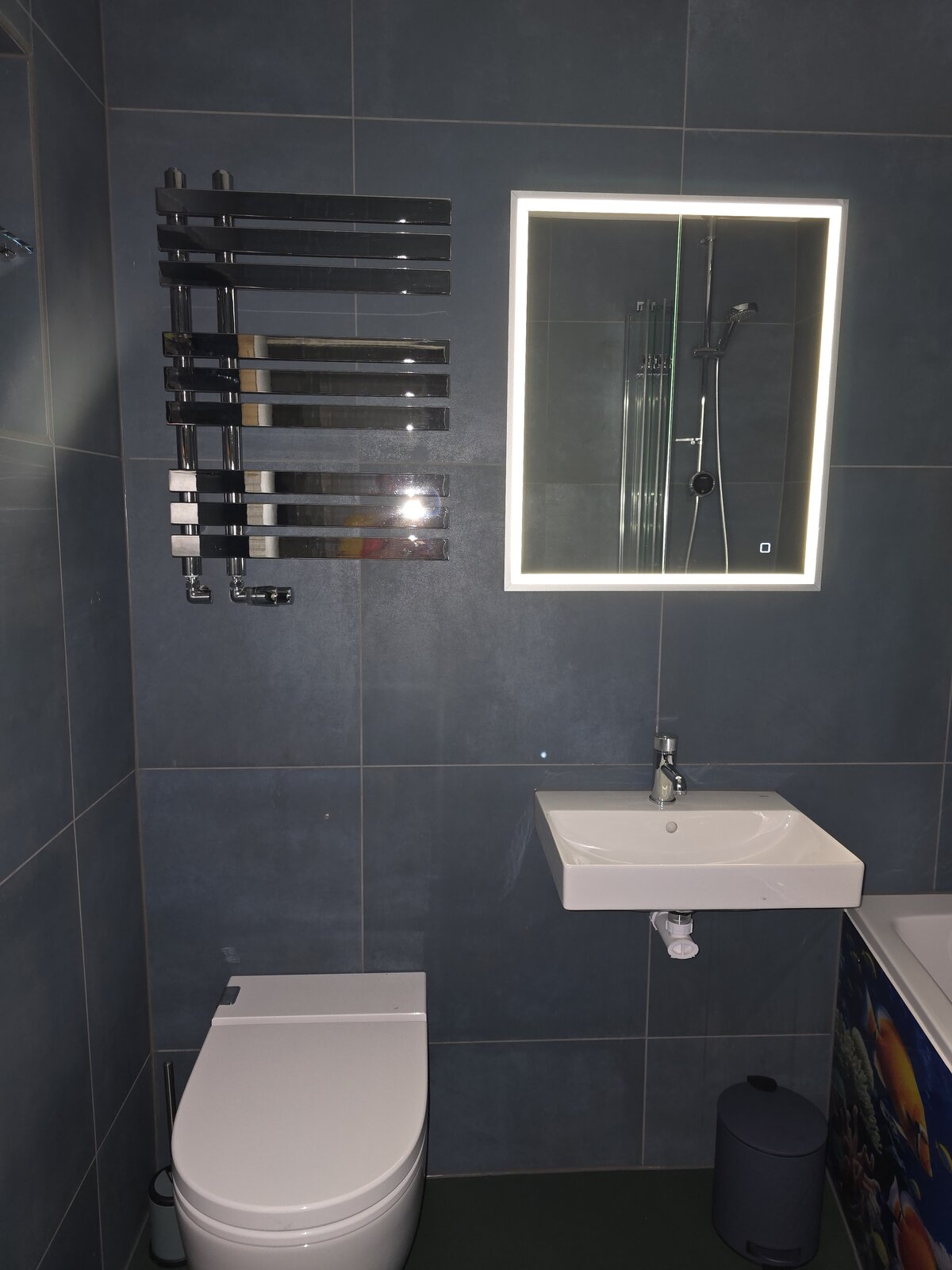

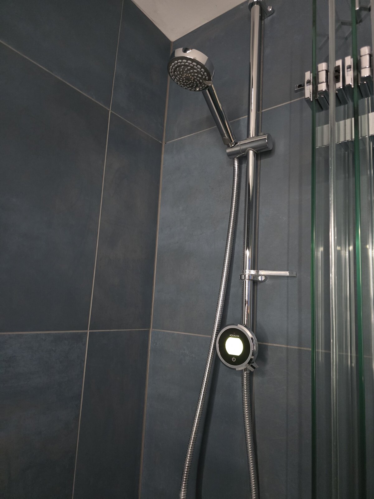

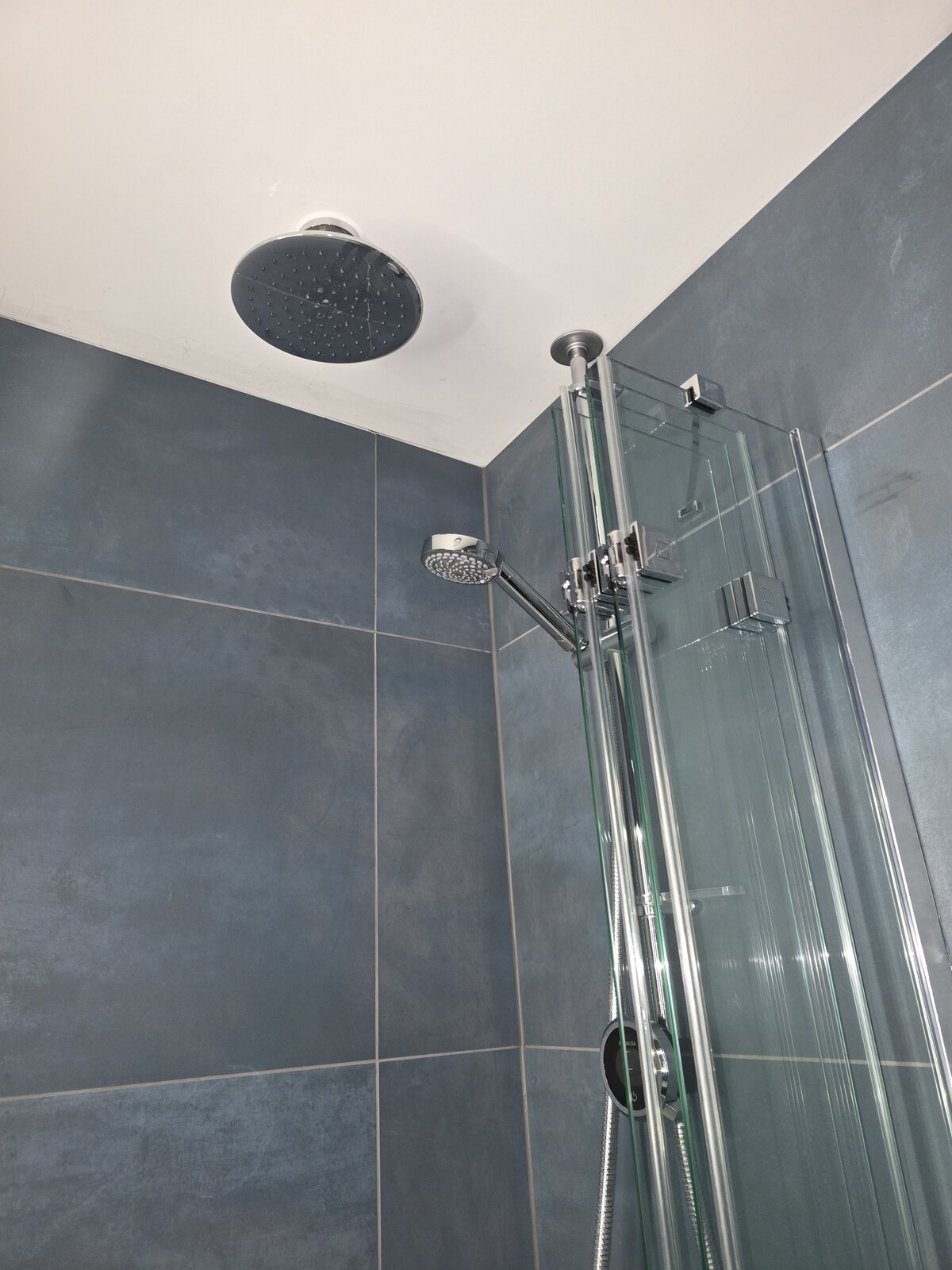

Made a mistake with the basin. I wanted to keep straight lines but I think I may need to go curved and less deep on the basin.

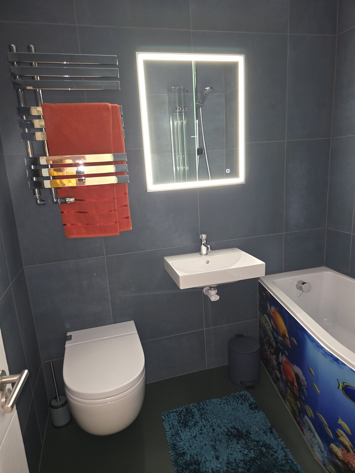

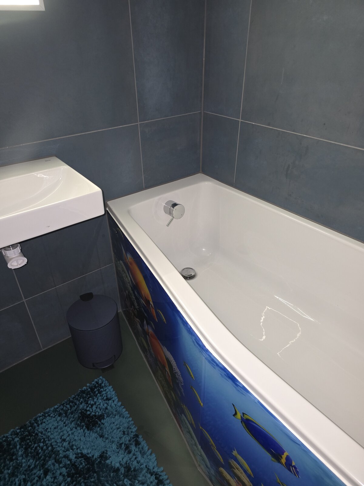

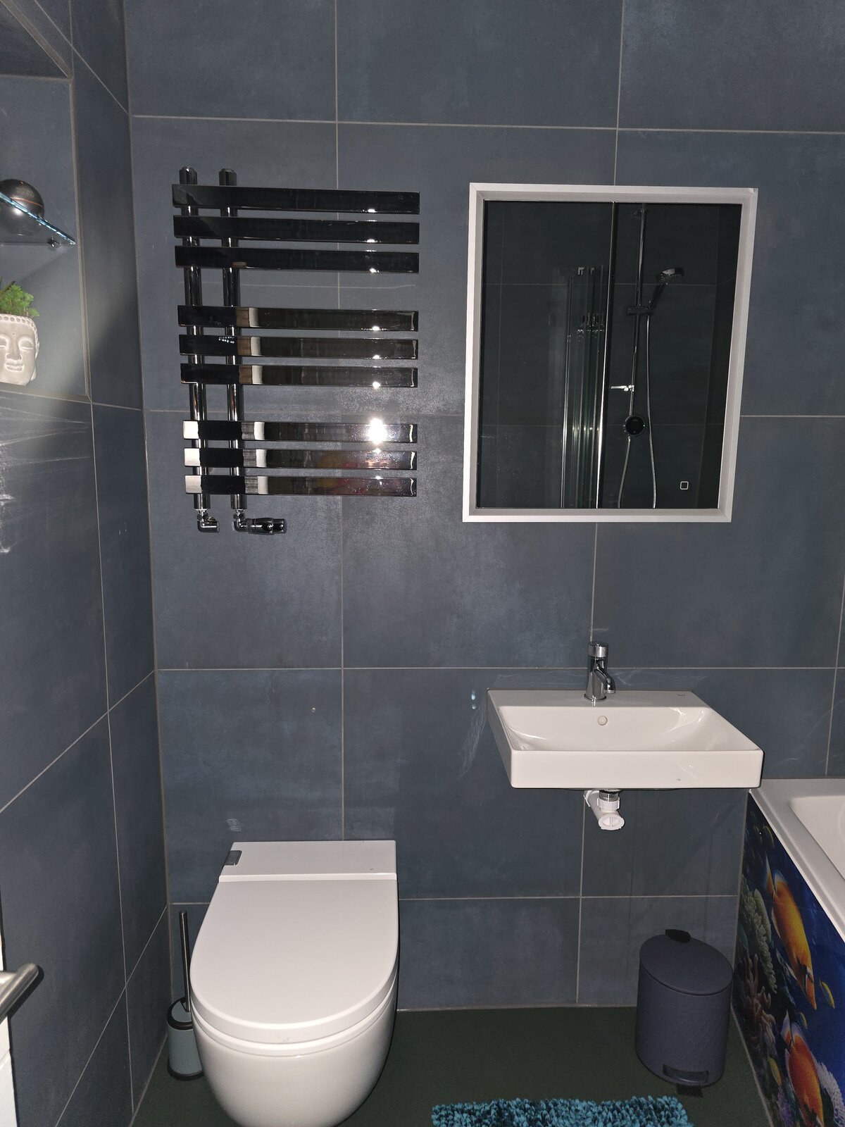

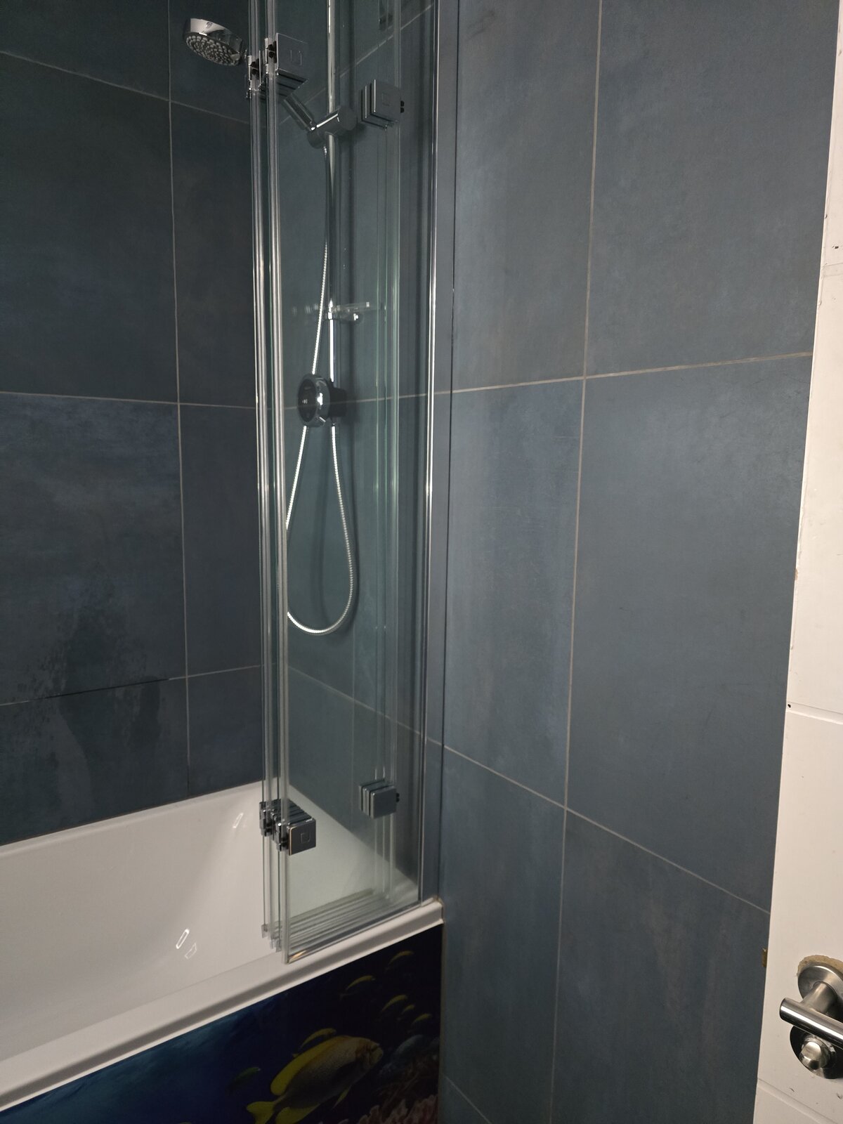

Apart from a few bit and bobs, the bathroom is finished.
You will see what Mrs Bods i put was otherwise all my design and organisation.
