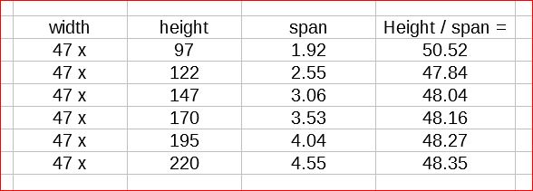

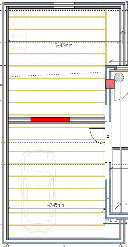

Does anyone have an online source for span tables for domestic floor joists deeper than 220mm? All of the ones I have stop at 47x220 and 63x220 etc.
I'm looking for one that will give me spans for ~250mm or other commonly available sizes between 220 and 280mm so that I can assess my options for spanning 4750 and 5600mm without using engineered wooden joists or steels.
