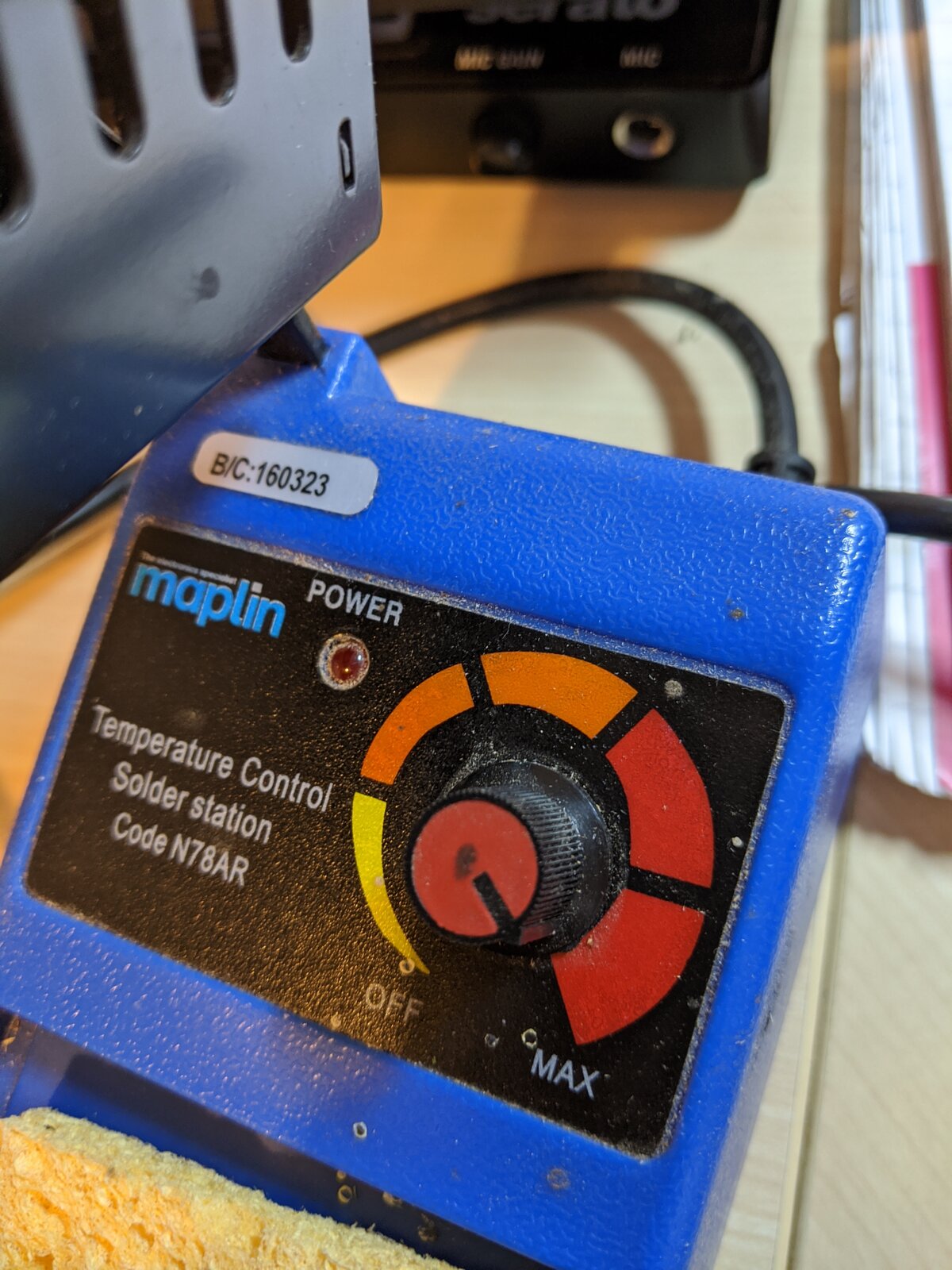

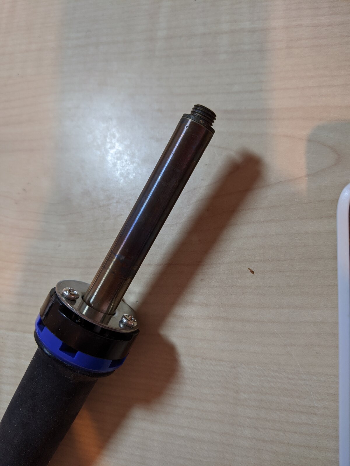

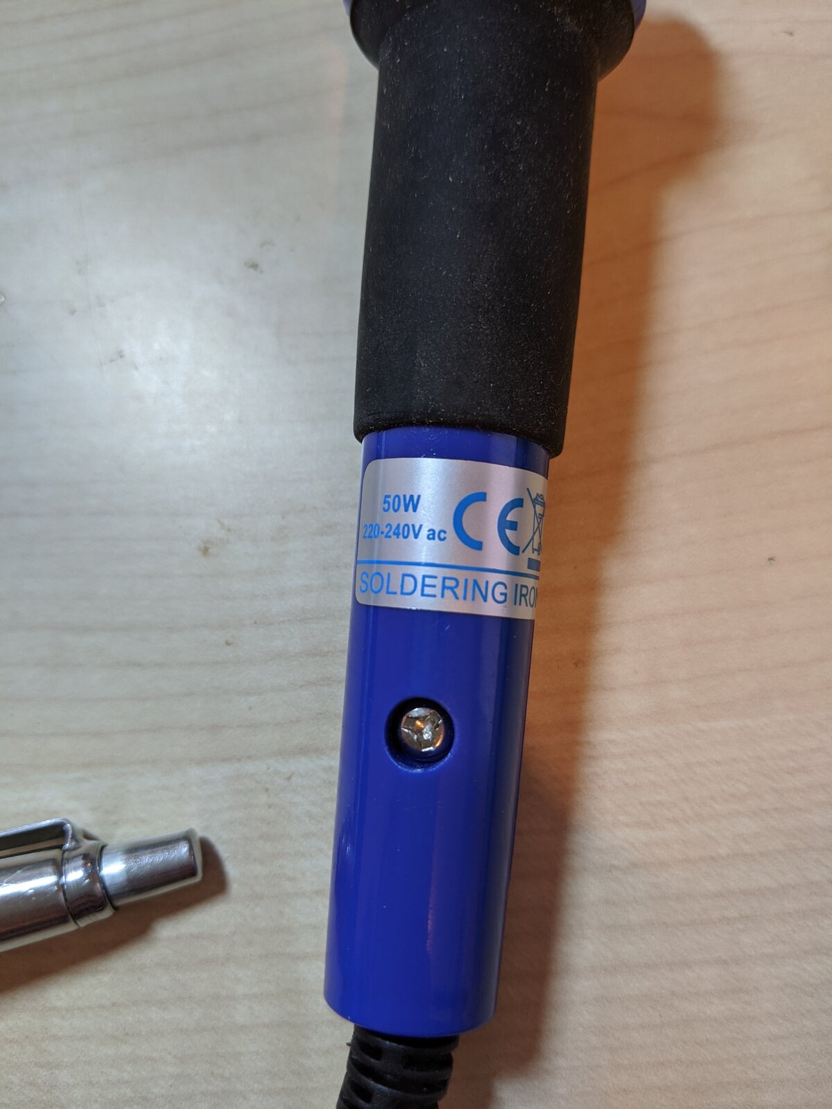

    I have a Maplins 50W solder station and seemed to have mislaid the end part of my soldering iron, I have new tips but believe I need some type of screw attachment/nut to fit them, anyone know what the part is called or if it's available?

    Have you screwed a nut onto the thread to find out what it is?

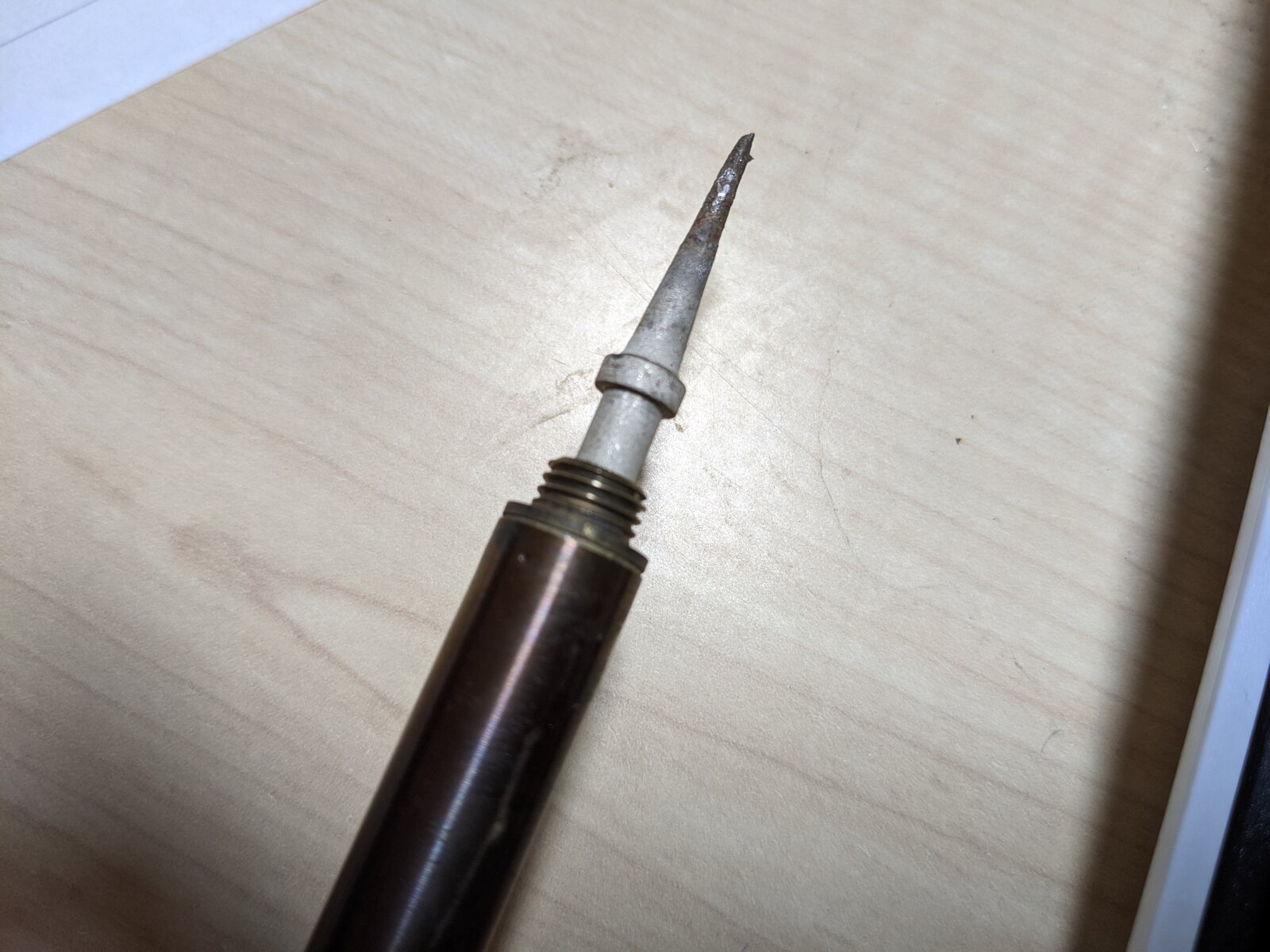

    Ah, partial result, I found the tip...
    So I just need the right kind of nut thing to retain it.
    A bit more digging and this station is also known as a Velleman VTSS5 with BITS5 tips 1.2mm apparently. tip.jpg

    Indeed. Thanks, maybe I should just buy a new soldering iron.
    Any idea if I can keep the base station part with the temperature control and then fit a new 50W iron - or are these things not interchangeable?

    If your not going to change the tip every five mins. then the locking ring off an early cycle valve fits. It has a slightly different thread but goes on quite a way, then fit washer or wrap wire around tip to tighten on. Bingo!
