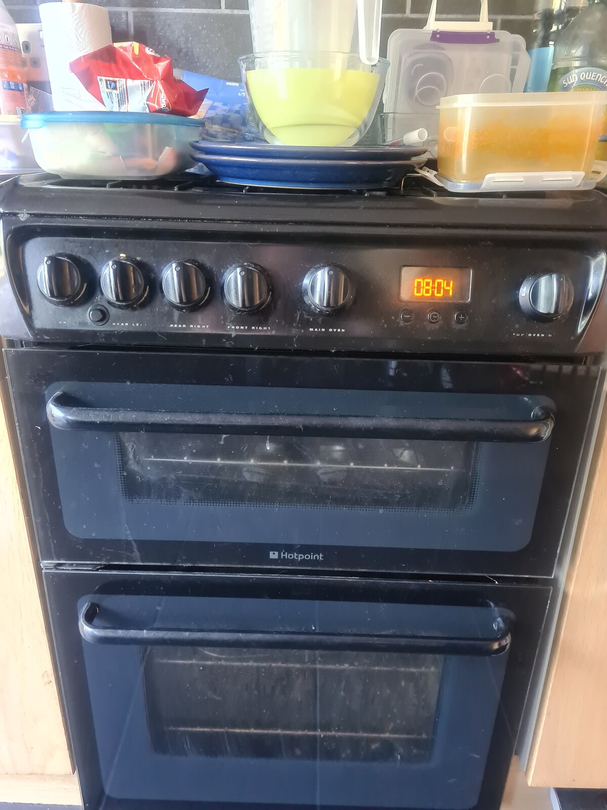

Hello all, just to make my week even worse our Hotpoint oven has stopped sparking on the button.
Are there any websites with parts diagrams for appliances and does anybody have an idea where the spark generator would be?.
Will have to take it to bits when I get home from work.
Cheers all.

Please do not attempt this unless you can carry out critical safety checks afterwards, as this would be deemed gas work. Are you sure it’s not just a switch that’s been accidentally knocked off?
Do the hobs "spark" or are they also non functional ?
If the hobs are not sparking then check that all the spark electrodes ( boths hobs and oven ) are clean.
Debris on a spark electrode can short out the spark energy from the spark generator and thus no sparks are created..
Mother-in-laws spark generator was battery powered on her cooker, just needed a new battery, once we had found its location! The previous battery has lasted many years.
There is no spark at all.
Button appears to be functional I check it when I take it to bits.
I'll check all the electrodes.
Ours hooks up to the mains but it wouldn't surprise me if there was a battery somewhere.
Modle number has rubbed off the front but there's a sticker on the back iirc.

It's probably mounted on the back of the cooker under one of the cover panels.
You'll also have a data badge on the back too take an image post it and I'll get you the part no

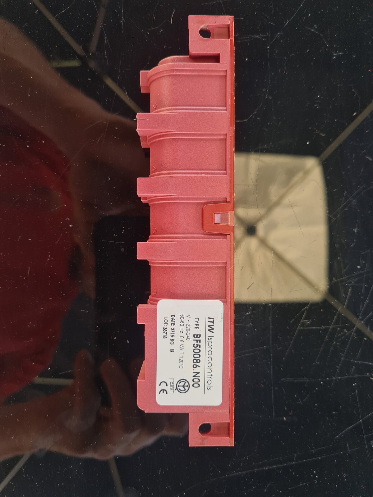

Managed to remove it and a genuine replacement is on the way for £25.
Tested the button and all good there, checked the electrodes and couldn't find a short.
Ironically out of the 10 screws that hold the back panel on half the holes were stripped, so I'll have to sort that out. Must have been a numpty at the factory as no-one's been inside it from new.
All done and back together, I noticed it had the Live and Neutral fitted wrong way round originally on Spark Generator (from factory!) but being AC I suppose it doesn't really matter..
