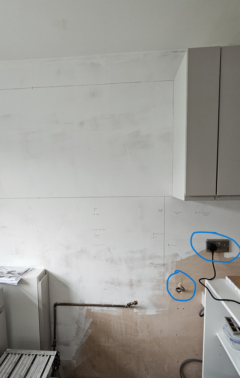

Sparky forgot the wiring for the cooker hood. Alternative methods?
seems to also be mixed feedback regarding the issue of tiling directly over cabling. would they need to use some sort of metal trunking to protect the cable or is it normally ok with tile adhesive over the PVC cabling. Thanks btw
No, no problem doing that.
If a hole can be made in the plasterboard somewhere near the centre of the 'chimney' extractor (where it will get covered) and in-line with the top of the wall cupboards, you could poke a straightened out wire coat hanger to see if there is a clear path to the top of the righthand cupboard.
Getting the power from the socket in the top of the oven housing seems the easiest.
You say the cooker hood is on an outside brick wall?
It is likely the next electrician will fish the new cable in the brick cavity to avoid any damage to the kitchen wall. :)
ahhhhhhhh ok gotcha, i did think that the top route might have been the easiest but once it reaches past the cupboards there is going to be quite a distance till it reaches the hood which i think might be around 20cm as the hood itself is 90cm but the vent part is obviously alot slimmer than the glass hood part.

will either be the sparky that i find or will just post up the job locally on trade/fb website. I have an sds which will be able to do the job but just dont have the core drilling bit, but even if i did i dont think i'd attempt it anyways as it seems very laborous to get through at least 2 layers of brick and then whatevers inbetween.
Should be ok then.

You are going to tile so no need to worry about making holes...
