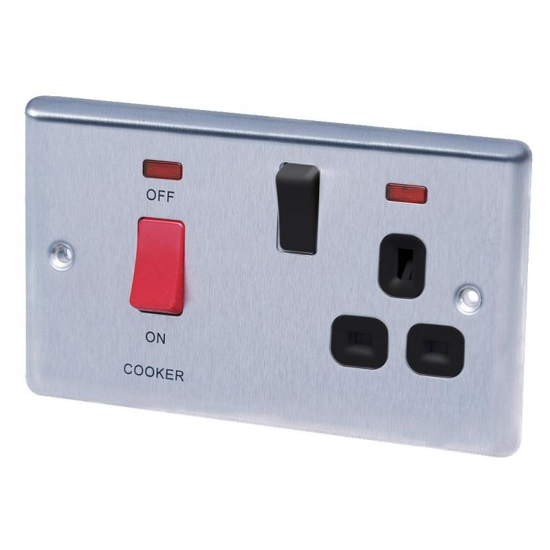

strange the link doesn't work when clicked but here it is anyway
John, this is what the cooker itself is plugged into
the 6mm wire from the Mains RCD is fed into this socket (as far as I know)
I could be wrong though but I don't believe so as the 6mm coming from the mains is channelled into the wall and into the above socket, the cooker is then plugged into the socket itself

John, this is what the cooker itself is plugged into ... the 6mm wire from the Mains RCD is fed into this socket (as far as I know) ... I could be wrong though but I don't believe so as the 6mm coming from the mains is channelled into the wall and into the above socket, the cooker is then plugged into the socket itself.
OK - so, as I suggested, you're just using it as a socket - the big switch labelled 'cooker' is not doing anything. You might just as well have a single socket there (and an unswitched socket, at that, since the switch would not be accessible in its present position),
If the oven is to be plugged in, the 'proper' way to do this would be to extend the cable so that it could reach some sort of switch (you could use that one, but you don't necessarily need one with a socket) above worktop level, and then bring a cable back down from that switch to a single, unswitched, socket below counter level, into which you could plug the oven.
I didn't really think of it like that, but I wouldn't say the big switch isn't doing anything - it's controlling the power coming from the mains RCD, and allowing to isolate the point if necessary. Although I guess this could also be done from the mains.
I don't think you understand what that cooker switch is - which is perhaps a bit worrying. The big lever on the left labelled 'cooker switch' controls only the supply to any oven/cooker which is hard-wired into the unit - it does not control the supply to the socket (which is a sort-of afterthought to the main purpose of the accessory), which is totally separate and has its own switch. The socket will have power, and hence will 'work' (provided its own switch is 'on'!) even if that big 'cooker switch' is in the 'off' position. If you plug your oven into the socket, the big 'cooker switch' therefore could not be used to isolate the oven. As I said, you might just as well have an ordinary socket for the oven.
Re: extending the cabling, do I have to crimp & heat shield or can I use suitably rated JB?
As I said before, I would personally regard a (suitably-rated) JB as a 'lesser of the evils' as compared with having the only means of isolating the oven hidden behind the oven.
