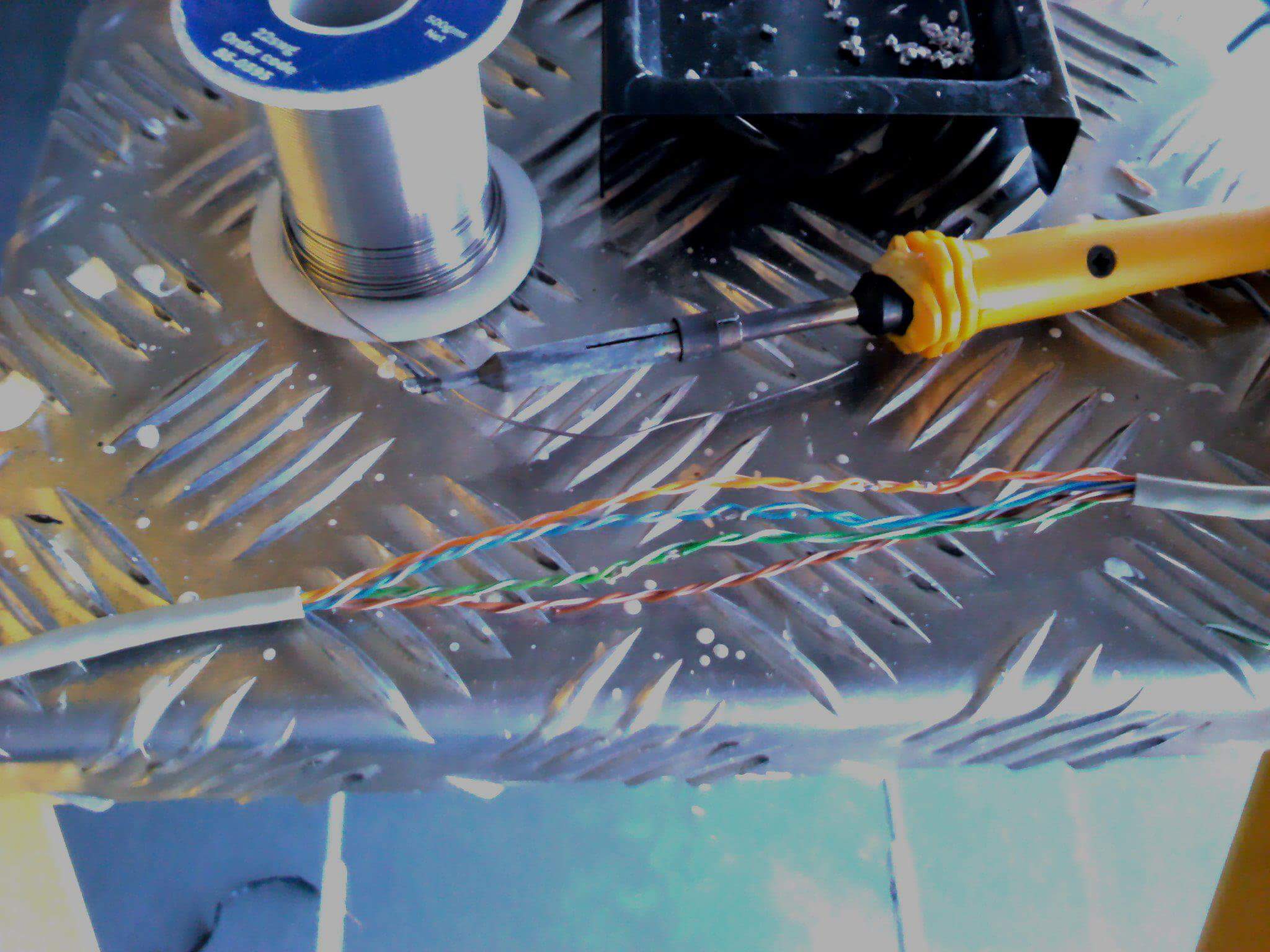

Another way to splice them together is by soldering with stagered joints (that way you can get away without individualy insulating each joint), keeping the twist as it should be and just put heatshrink over the whole joint. Ive had success with that method on cable runs of near 100m with no speed issues.

Got asked to look at a slow internet connection, found a join in an out building.
https://photos.app.goo.gl/gLDb9GQScxrIsy1s1
I guess this is reason why the PC would only run at 10Mbps!
Got an IDC CAT6 box to punch down and re join the cables.
On closer inspection zooming in on the photo it looks like the cables have been stripped before being put in the crimps (certainly the blue wire )??
They are designed to be self cutting through the insulation so no stripping required. I wonder if the lack of insulation has narrowed the cable enough for the act of crimping to not have actually pushed the wire into the connector properly causing bad connections?
Firstly the 'jelly' crimps are the correct joins for use in damp (i.e outside) environments. The 'jelly' - either silicon grease or petroleum jelly - is intended to stop corrosion. Certainly the disturbance to the pairs won't help the speed. I'd say that the change to an internal IDC box won't in the long run help the network performance.
How long is the cable run? In practise the longer runs will slow the network speed down. A long run with a joint in the middle will have an effect on speed.
