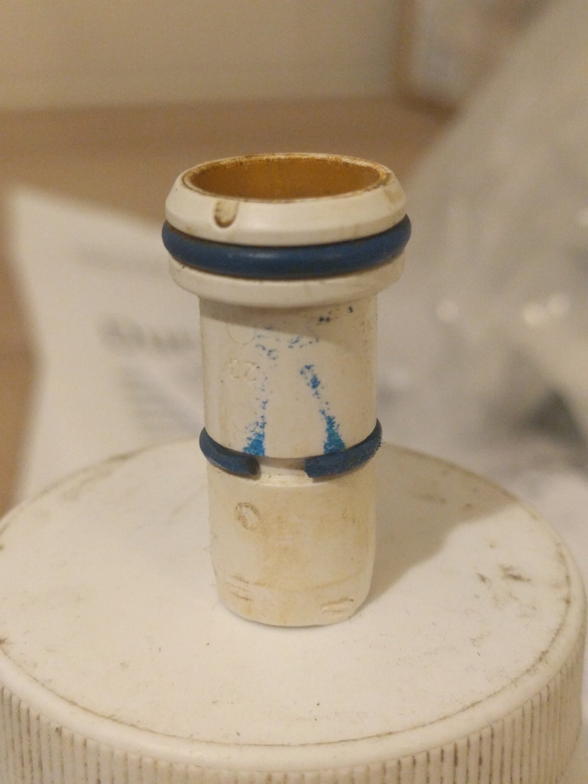

Went to change a redundant rad to one of those plinth heaters, pulled this pipe off the manifold to flush it through as it's been disconnected and found the o ring has seen better days. I thought speedfit was supposed to be good for 25 years plus?
Was all new pipe and fittings, flushed, no new soldered joints at that stage, and was serving a rad until a few months ago.
Anyone else seen this or was it just a bad batch?
Yup, +1, I'd agree, looks like that one was pinched when inserted and the rubber eventually disintegrated. Wouldn't worry as the primary seal isn't made at that point, rather at the seal in the fitting.
I always wet the superseals when inserting to try and avoid that.
Thanks both, I did suspect that, generally nowadays I put some silicone grease on the orings but they don't recommend it in the instructions
Do you mean they say "Do not use silicone lubricant" or do they simply omit to suggest using a lubricant
CORRECTION/edit actually I can't find any information any more, I looked when I first thought about using it and it was the former, they tell you not to put anything on at all.
Perhaps they were worried about old school plumbers fluxing the inserts:whistle:
I'll carry on with the silicone grease for now.
