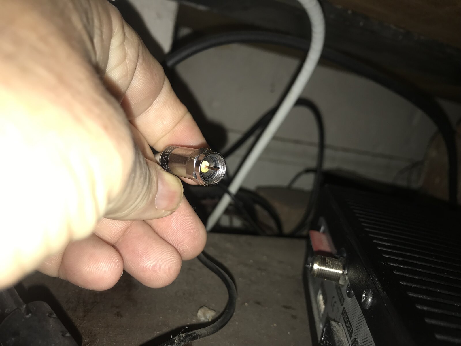

Due to cost of heating mom moved into front room where there exists a virgin feed to the broadband router .
However moms Tivo box is in the room she’s moving ou and Itis fed by a separate feed
So…
Whilst mom is now in front room is it possible to put some sort of split on the broadband feed to the router already in the front room and then feed the TiVo if I move it into the front room temporarily…
So doing nothing illegal like an additional Tivo.. just want to move it temporarily for my mom until the summer
Thanks to anyone

So thought i could use these however when I looked at Back of TiVo it has A direct feed from the outside like the router has . It isn’t an Ethernet connection
( unless I could use one ???? )
Ah... I'm not familiar with Tivo but assume it's like a satellite box. Can you not get instead a long satellite cable and possibly a barrel connector (for connecting plug to plug where it joins)?

So there is a cable to the broadband router in the front room? Where is the incoming cable actually split? It might be in one of those brown boxes on the outside wall of the house.
Find that box, replace the splitter with a double ended f type connector, work out which cable feeds the front room, and connect that leaving the old feed to the room she's moved out of unused. Then go into the front room and insert the cable splitter into the feed to that room and connect the other end of the splitter to your Tivo box.
You might need two lengths of coax cable with male f type connectors on each end.

The plug in your image is an F-type connection. If the box elsewhere has a similar F-type connection, you need a 3 way splitter.
You then need cable. They sell a cable called CT100 (by all accounts it isn't really CT100 but it should work)
(they now, finally call it GT100).
You will then need to fit a male F-type connector (at the source, and the supply end).
The fittings have a thread that screws on to the cable. I prefer the crimp types but if you only need to do two, go for the cheaper tool free option.
This is very good advice. Get rid of the unused branch, otherwise you'll end up with half the power level you currently have and will get issues as a result of the reflections from its unconnected end.

Thanks to everyone for your help
Couldn’t get of the old branch/wiring as mom will move back on not the main larger room when weather warmer
Sorted now ordered a splitter kit
Splitter with a couple of 1m cables
So can still have router connected now also the TiVo box as well
